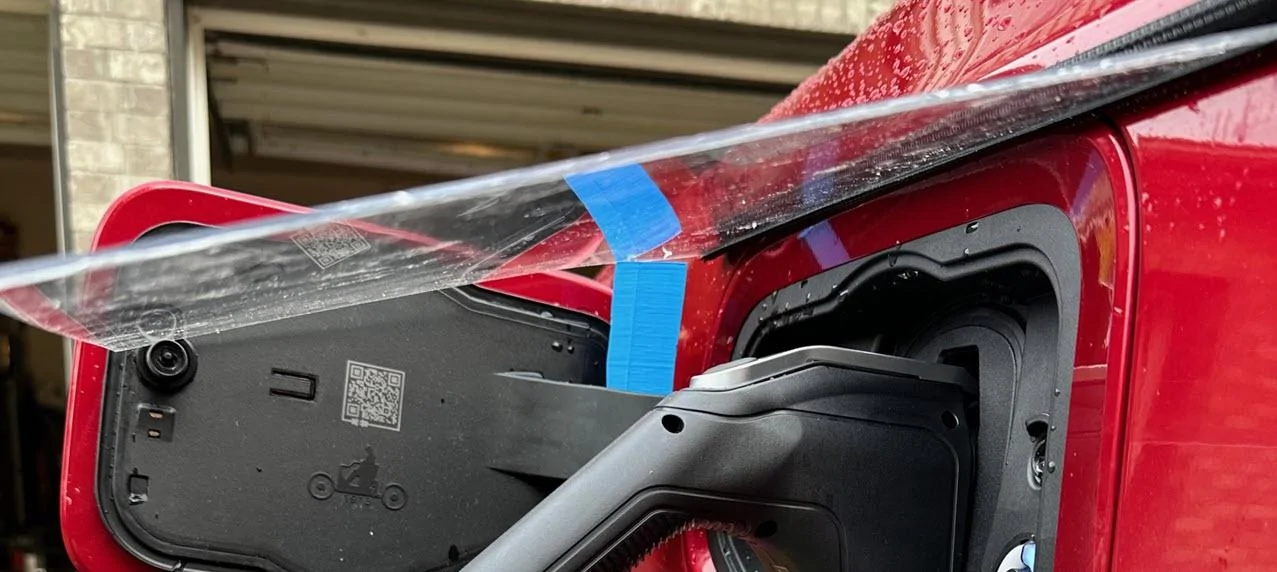

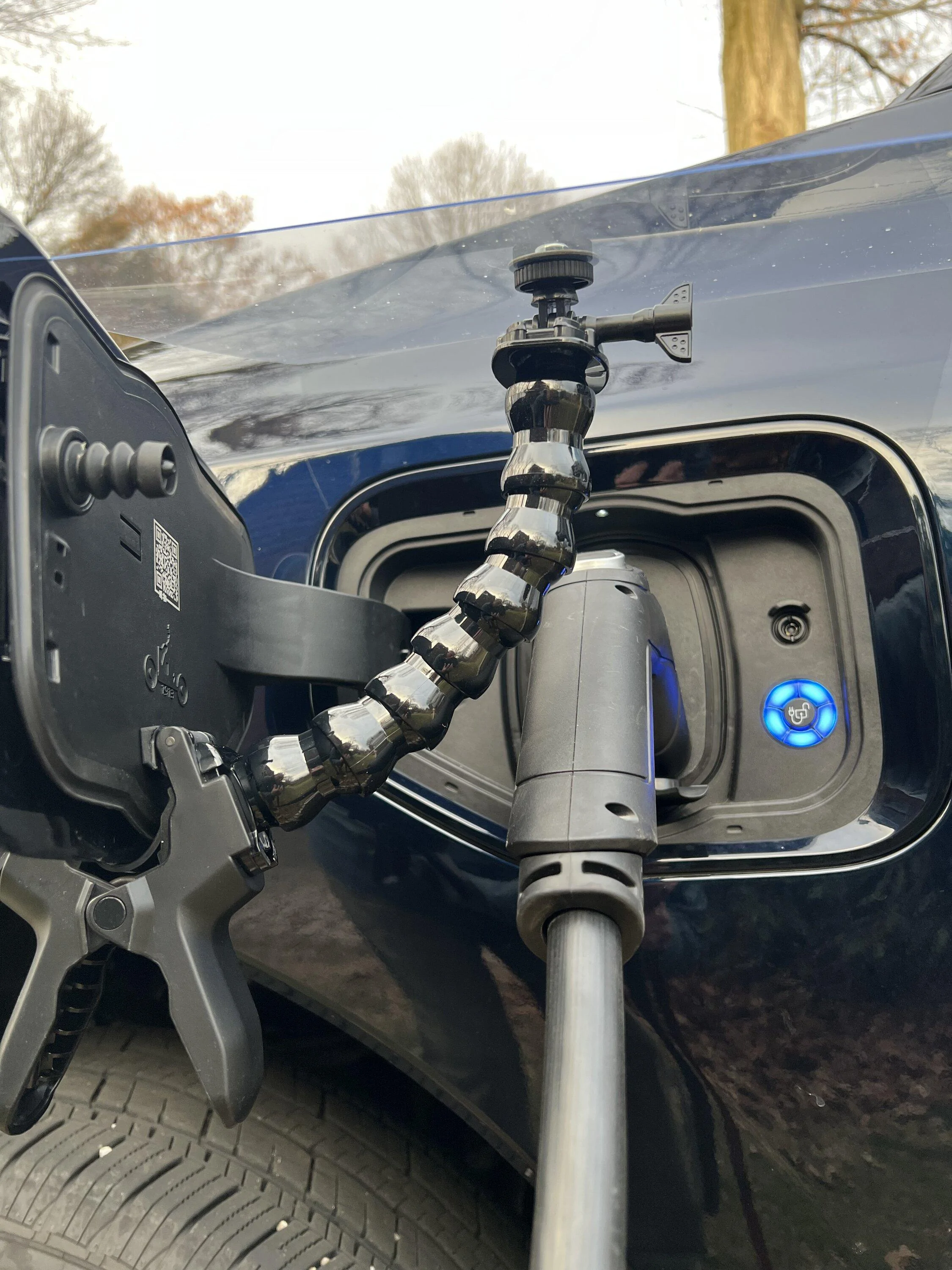

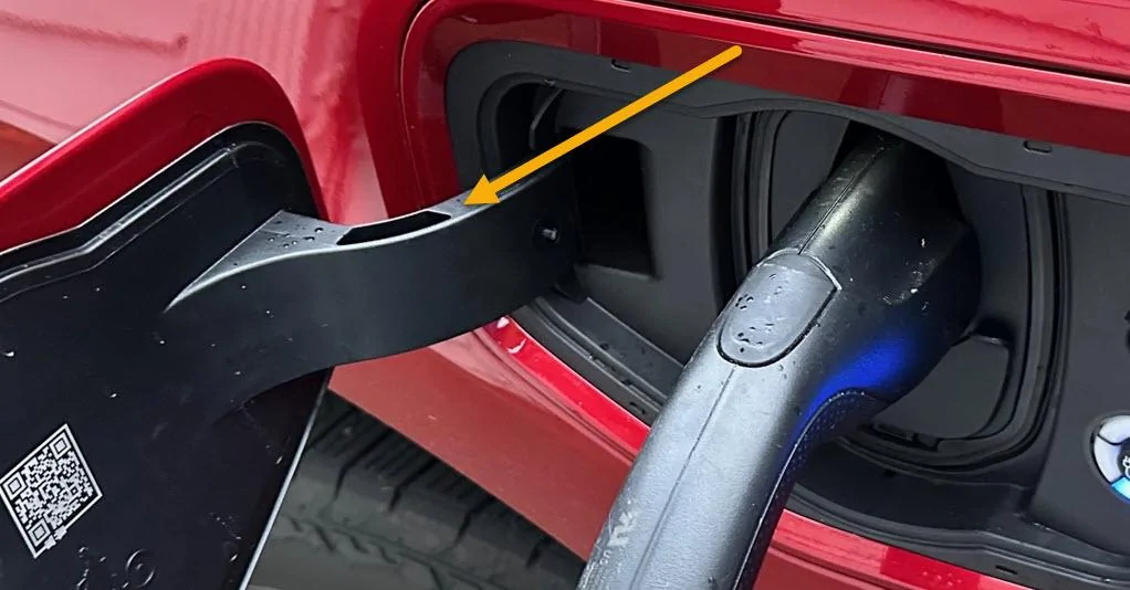

Similar to the goose neck idea, there is a small slot in the charge port door hinge mechanism.
Ford F-150 Lightning Charge port cover options? pic1

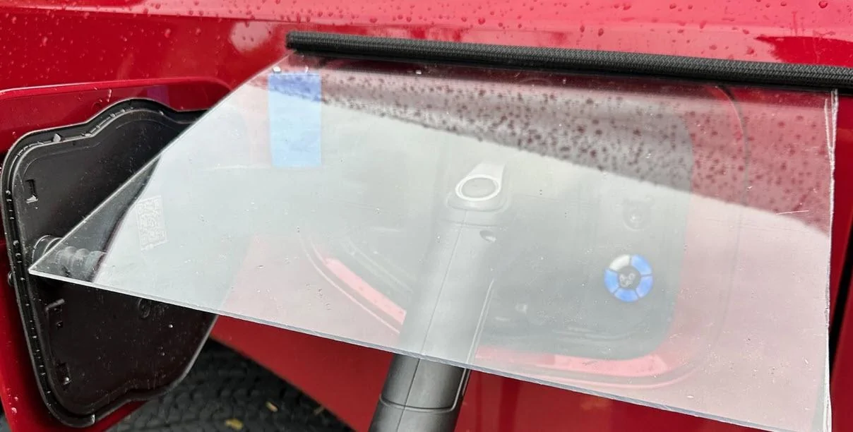

Playing with 3D printing an insert and putting light weight plexiglass cover attached to the insert
Ford F-150 Lightning Charge port cover options? pic2
Ford F-150 Lightning Charge port cover options? pic3
Working on some refinements like more precise angles, softer rubber gasket seal against body, neo-magnets to hold the plexiglass and insert together rather than a screw for easy take down, attachment to the latch pin (currently just rests on it), making it look pretty, etc.
Your ideas welcome.
The door mechanism looks to hold lots of options - but need to keep weight to a minimum.
Obviously too much time on my hands.

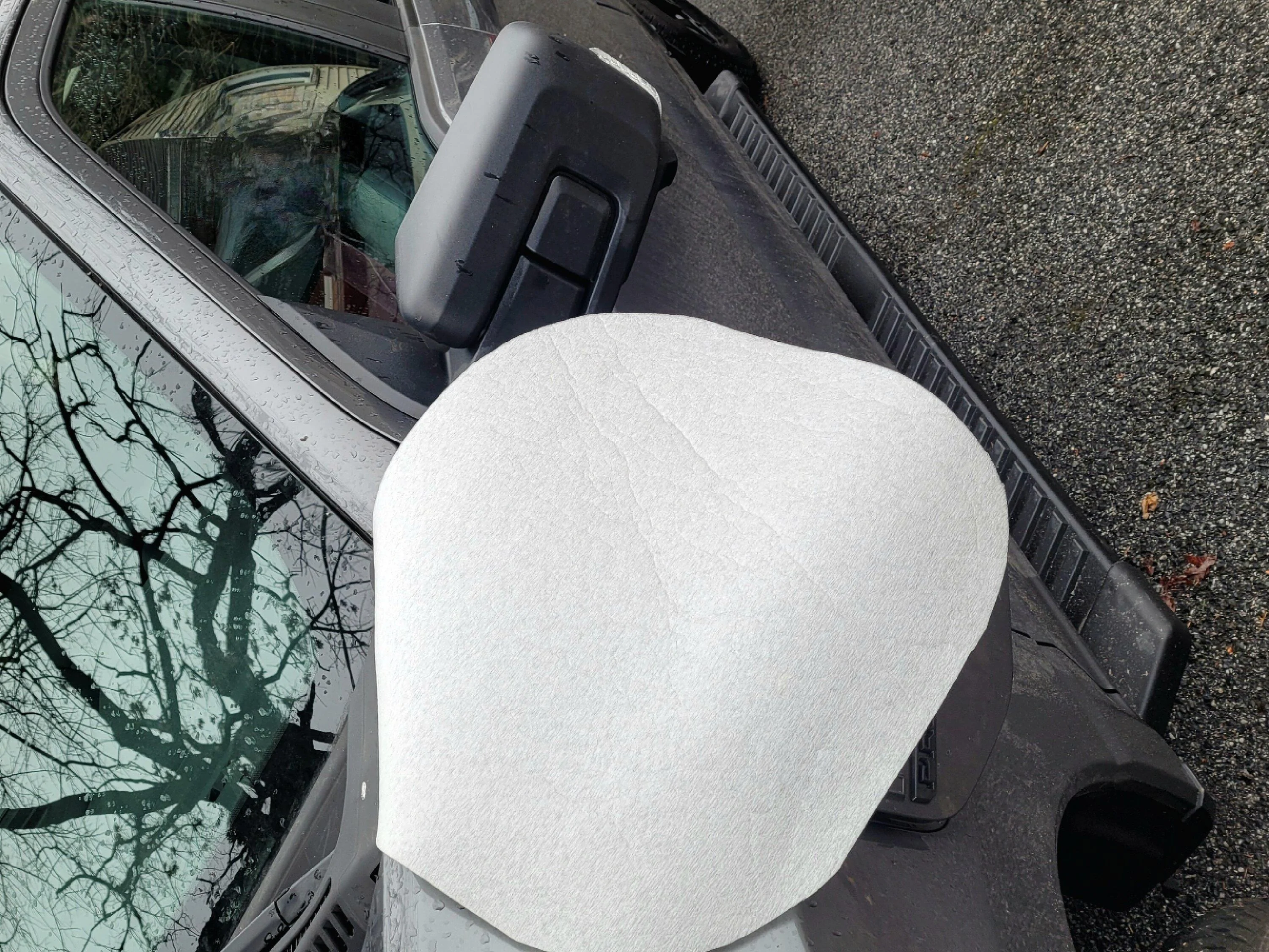

Not a permanent ent solution but if you are in a jam, you can always jam something in there:
Ford F-150 Lightning Charge port cover options? 20240125_135728
