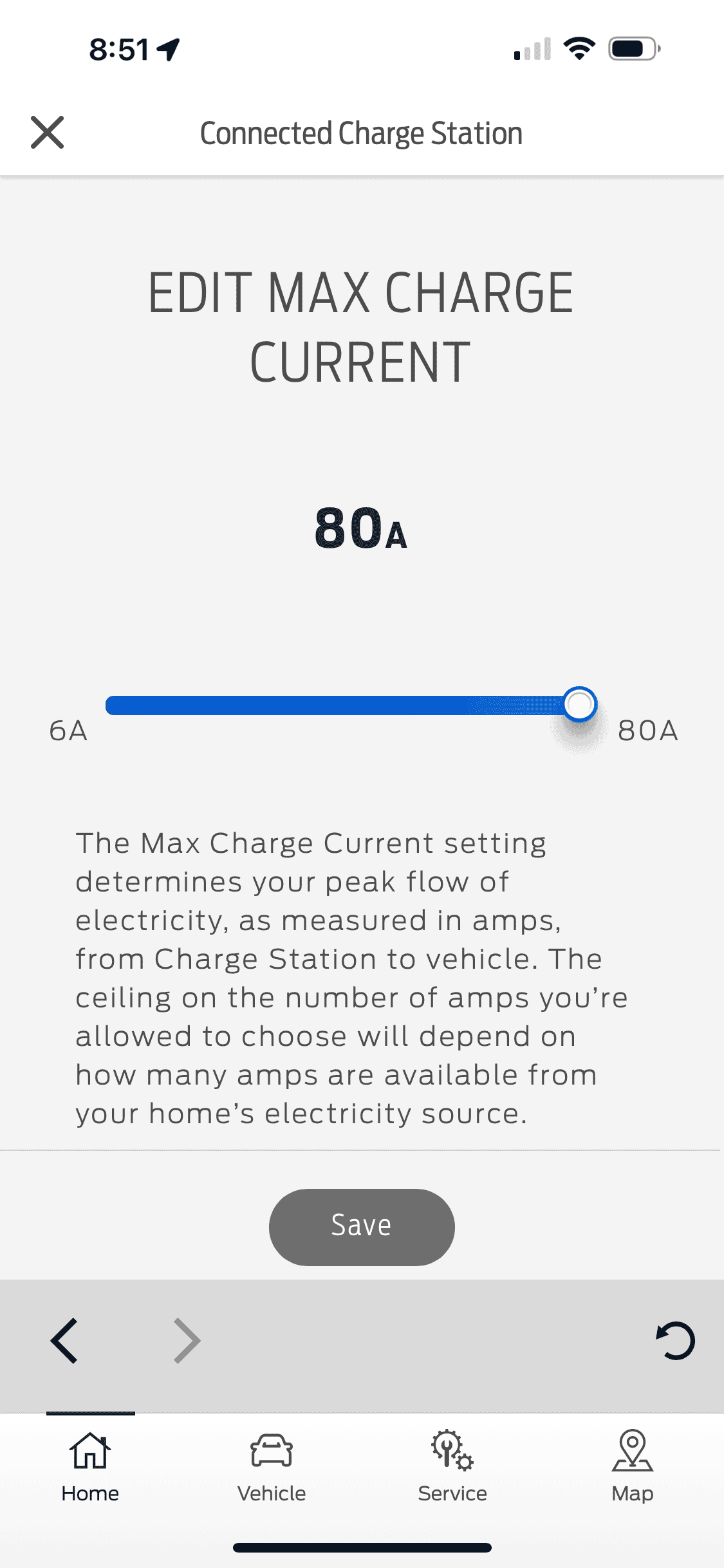

I manually set the dial to 48A in the FCSP but the app still shows the full scale up to 80A. It would be more clear if the app received feedback from the FCSP and adjusted the scale appropriately. I set the app to 48A to match the dial in the unit but I’m not sure if that actually makes any difference.

I just installed my Pro Charger tonight. I also use Sense for my home power monitoring. I upgraded my wiring to 3 gouge copper wire and set the dip switch to 7 for 80 amps. Good news, I am charging at roughly 82amps. Bad news.. adjusting it down in the APP seems to do nothing. I've tried setting it and it confirms and shows it's lowered but does not actually reduce the amps going to the vehicle. Also I had to use an Apple phone to get the Charger Pro setup app to actually finish properly. Two separate Android phones couldn't finish the setup. They would connect and then it would find it after it switched to my home network. My old WallBox charger had a similar process and it worked flawless.
After I posted my screenshot from the app I was worried that might be the case. :confused:
I have an Emporia Vue so I will try the same test in a few hours when I am up.
