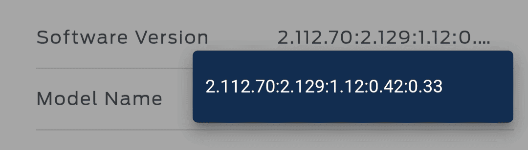

Anyone know the current FW revision?

Thanks. I am on 2.112.64. Even though it seems to be charging, "Insights" shows 0 KWH?
That's what mine came with. Took about a week and it updated itself to the current version. Insights is hit or miss. Sometimes it's accurate and shows the kWh during the charge. Sometimes it doesn't. And sometimes it's slightly off....

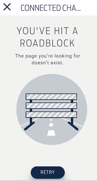

The data server appears to be malfunctioning at the moment, it was working an hour or so ago but at this moment here is what I am getting trying to refresh my stat's, I wanted to look at how my current session was going, but can't at this time.

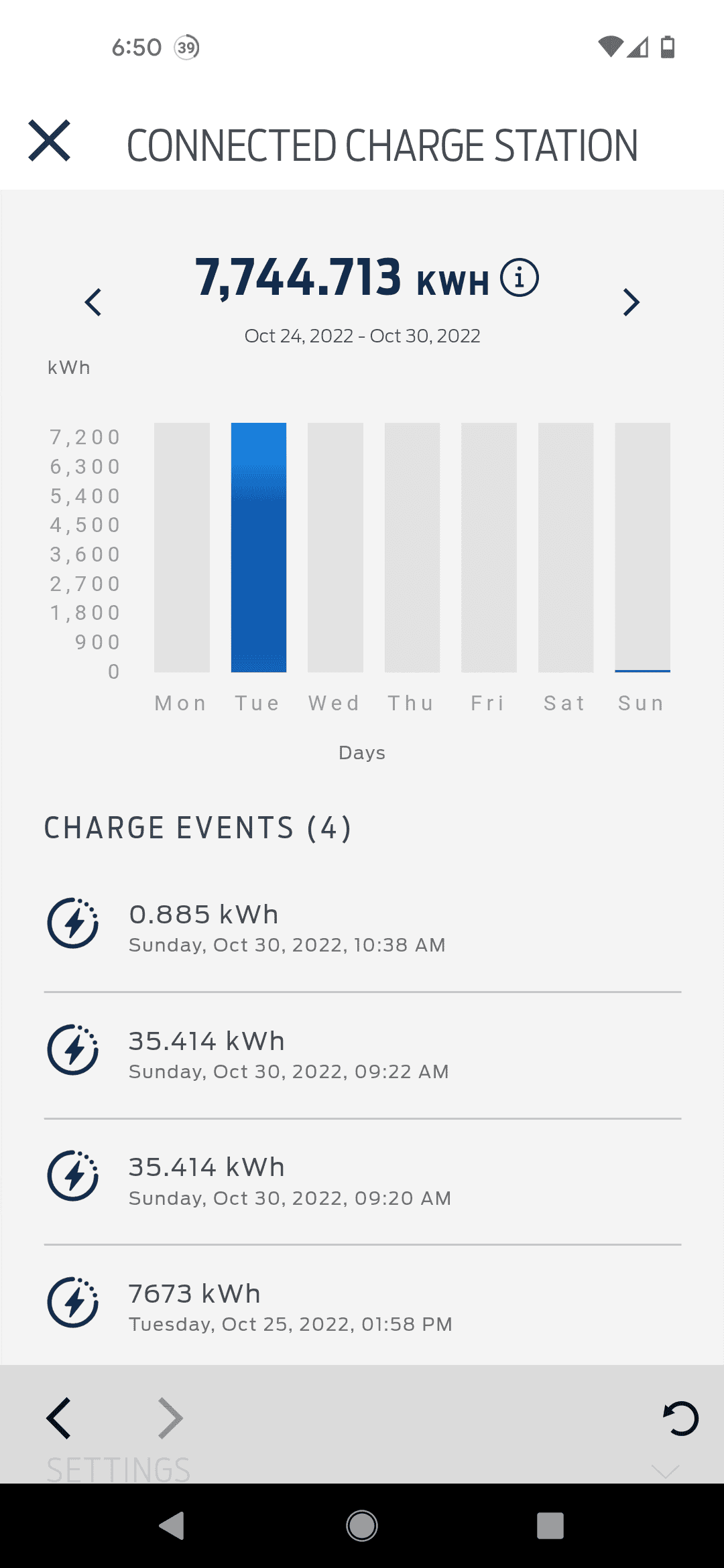

One of the weird things I have noted, the charge log won't register a session result until we unplug the truck in the morning, though the charging happened the late afternoon or evening of the prior day. The Charge station tile found under account in Ford Pass also only registers the performance data after the session is done and the truck is un-plugged.

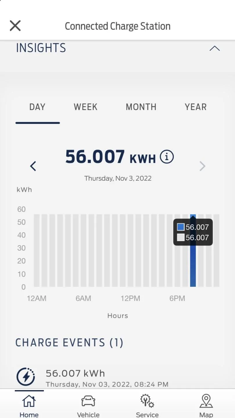

Also, I found I need to wait ~5-10 min after completion of the charge before disconnecting from the truck….otherwise, my FCSP indicator light goes White (FCSP resets) and it can take over a week for the charge session data (if ever) to show up in Insights in the FCSP iApp?.
My last charge session: ~91% efficient
FCSP app: 56.007 kWh delivered
FordPass app: 51 kWh received

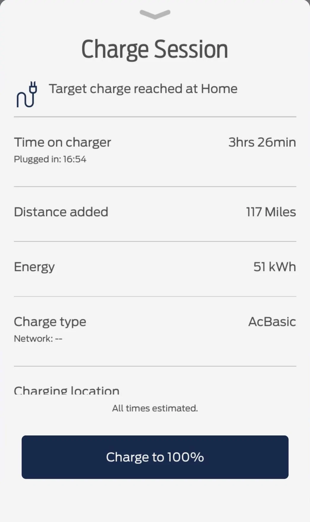

Does the “Charge type” always list AcBasic when everyone is using their FCSP?
I’ve had the same home network connection issues and been through a handful of factory resets. Finally while I was initially connected to the FCSP (before trying to connect to home network) manually added FCSP to Ford Pass app. Seems to be getting information on my charge sessions, but was curious about if it will display anything else for the charge type. Still need to try and get connected to home network so it can get updates. Will keep trying various setups and restarts to try and get it to complete.
