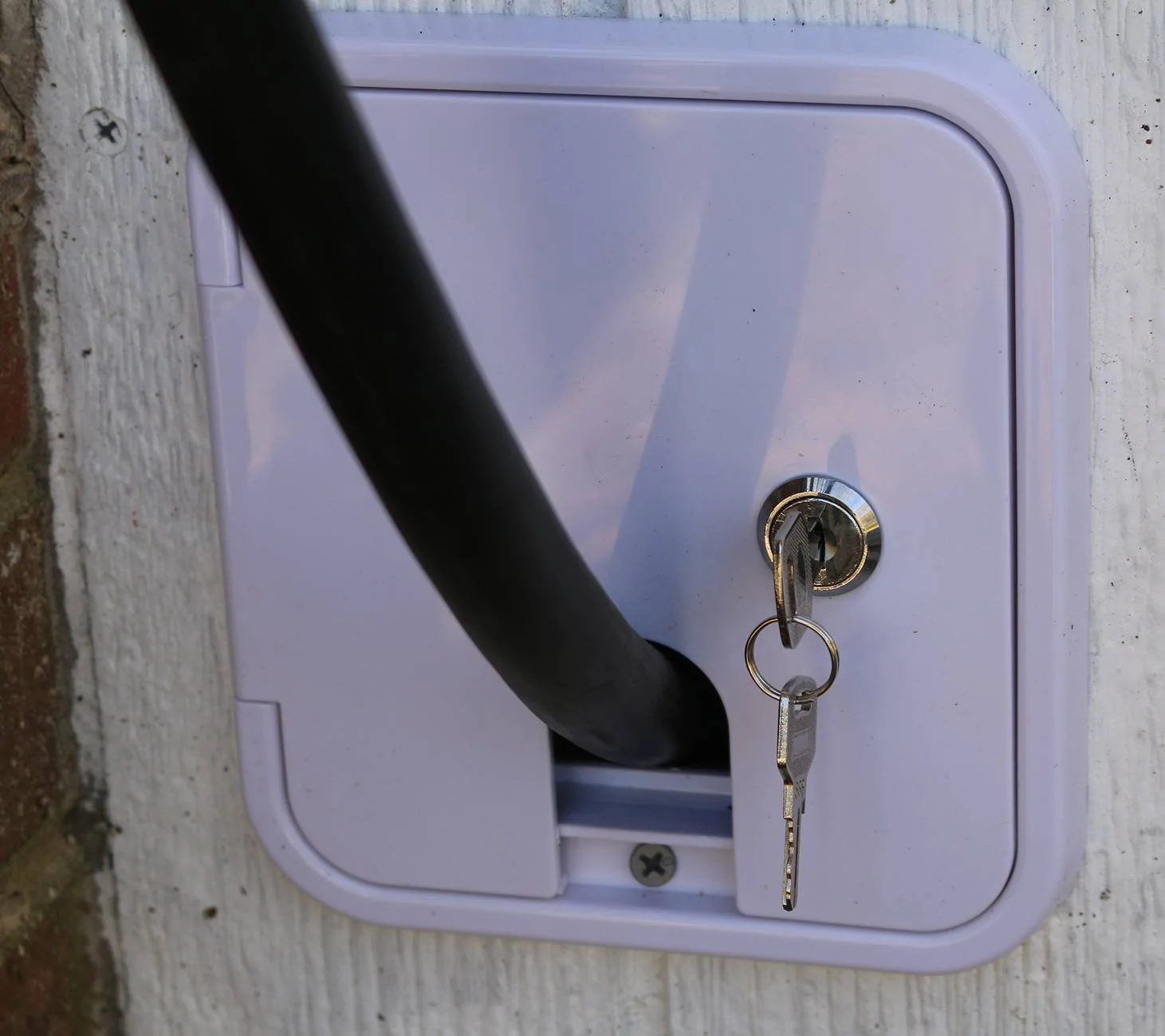

My install in indoors in my garage and I run the CCS1 cable through an EV access door in my garage side panel.
Ford F-150 Lightning Charge Station Pro issues - in the most unlikely way IMG_5793-cord pass-through
