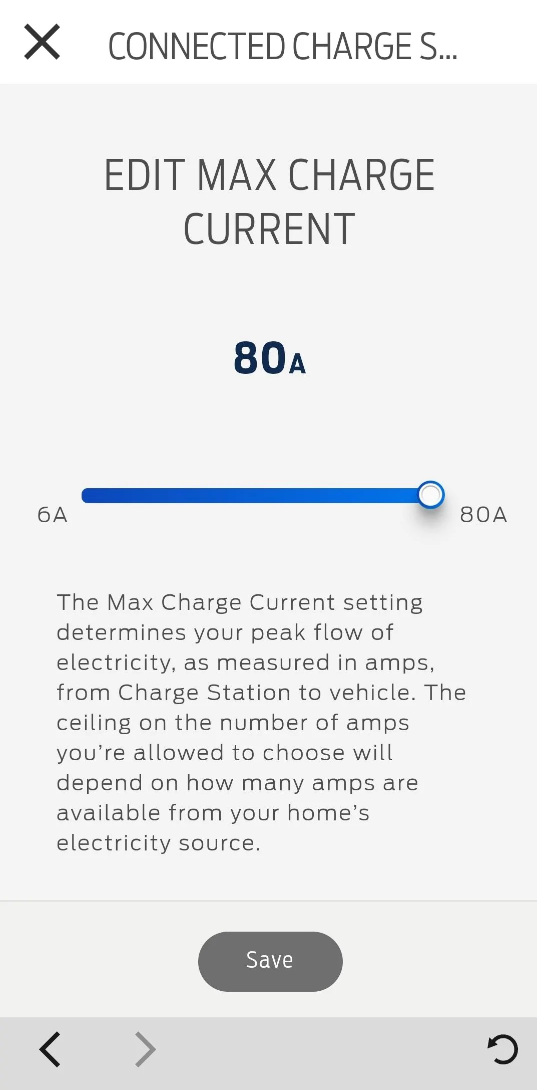

Is it toggle switch or app based to adjust the amperage? I assumed you could change it via Wi-Fi
LightningShow
Sep 1, 2021
51
1,923
2,249
MA
'22 Lariat ER
Product Development
Hmmm…i assumed it was in the box, toggle or jumper, but I don’t know for certain. Derating in an app would definitely be the preferred interim fix.

NEC was supposed to be changed to disallow any software changing of current. The only safe way is to use some jumper or switch pack that one has to access inside. We assume that one knows how to secure power before they attempt this.
My understanding is that the maximum is set in the evse and then it can be used selectable up to the maximum. It would not be safe to have 8g wiring and have it user selectable over 32 amp, but there is no reason why someone should not be able to turn it down to 24 or 16 amps in the app.
This is exactly correct.

Yes i'm in Quebec.
Did some testing last night by setting the max amp to lower...
1h @ 40A no issue
1h @ 50A no issue
1h @ 60A no issue
1h @ 70A no issue
