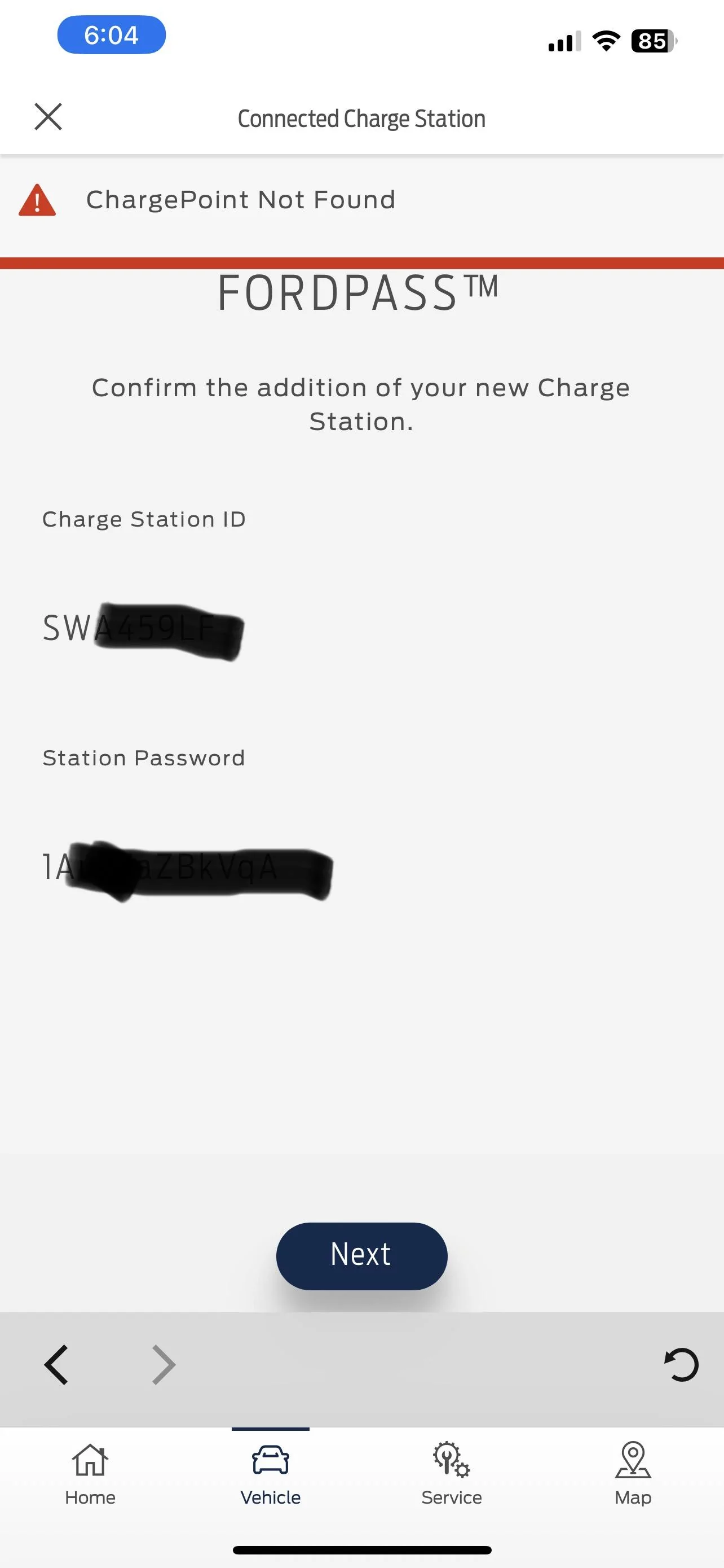

I’m trying to sync my ford station pro to ford pass and at the end it says “ChargePoint not found”! Does anyone know how I can get this synced? The Charger is working but the 2 apps are not syncing

Can you log into the FCSP with the installation app?
Known issue, already reported to FMC and waiting for them to investigate and resolve.
It appears to be a mid level server that handles communications between the FCSP - Siemens or Ford / Fordpass.
Discussions here on the issue
https://www.f150lightningforum.com/...pro-cannot-connect-to-charging-station.18311/

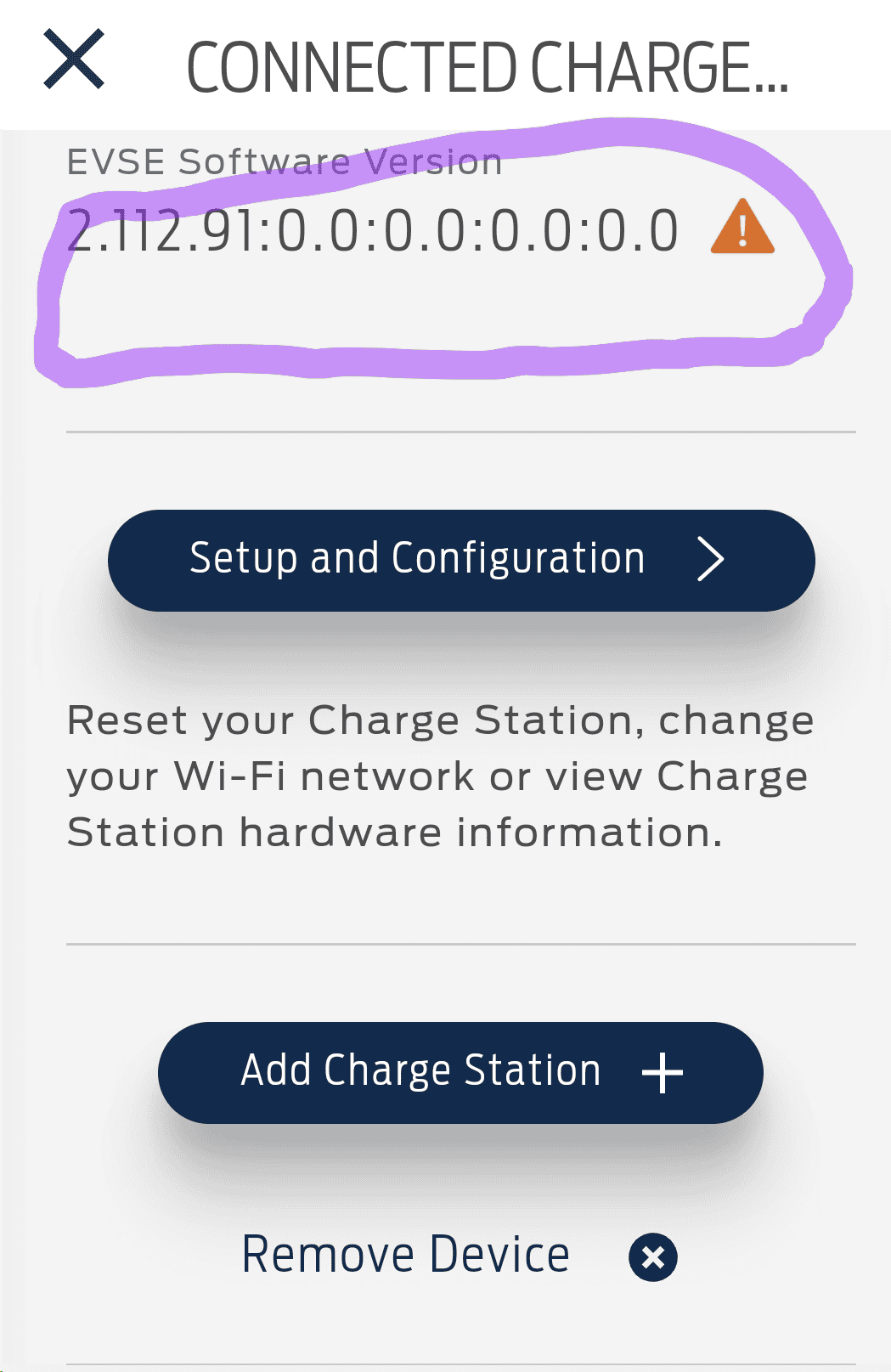

As mentioned in a related thread.... @Ford Motor Company please get someone to fix this server problem, the issue is at either your datacenter or Siemens, I'm suspecting Siemens, because my FCSP has been waiting on a firmware update for OVER a month now, and the problem has devolved to total lack of comm's between the endpoints and the data servers.
Ford F-150 Lightning ChargePoint not found 1708026373287
Ford F-150 Lightning ChargePoint not found 1708026438971
