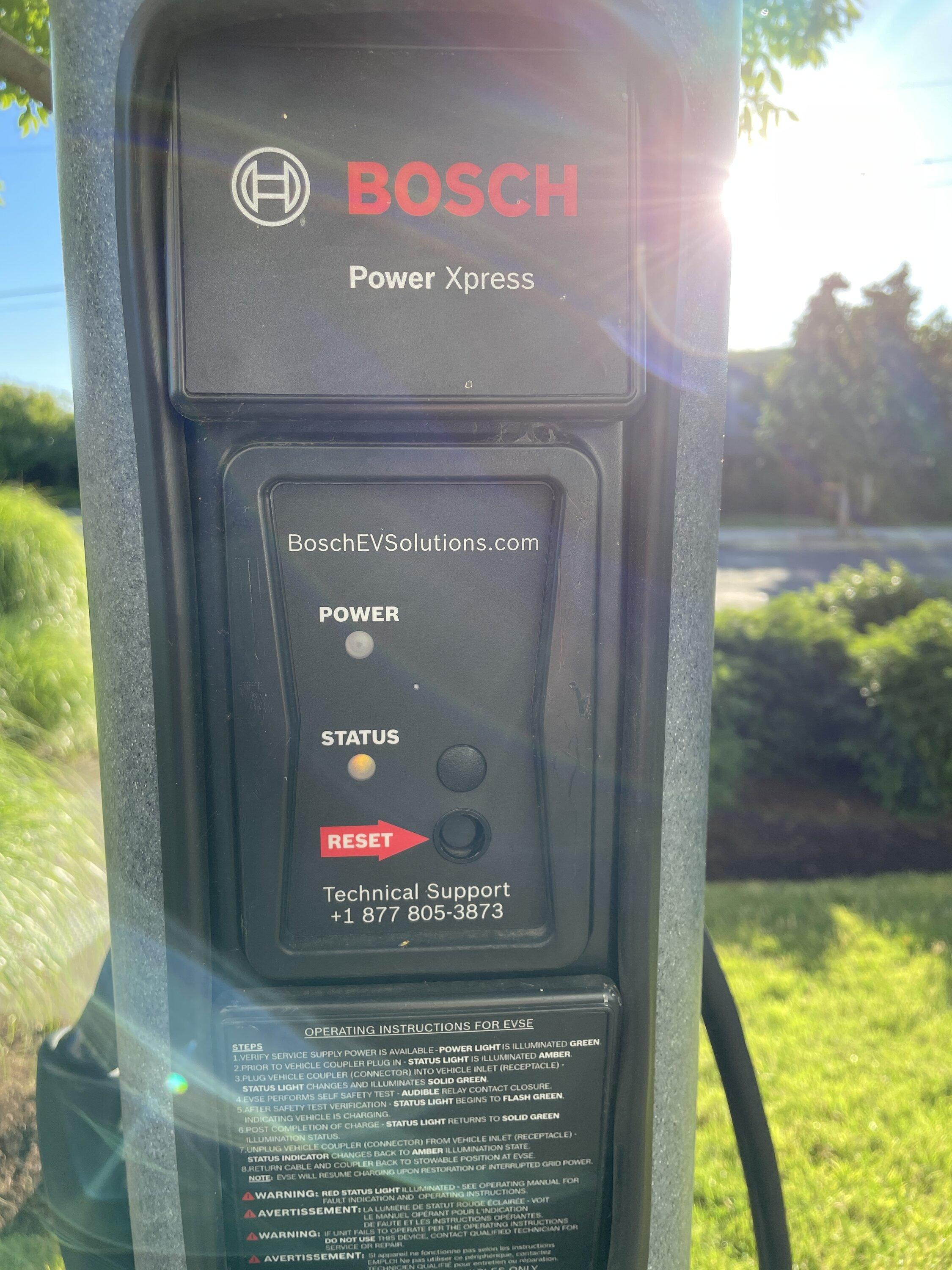

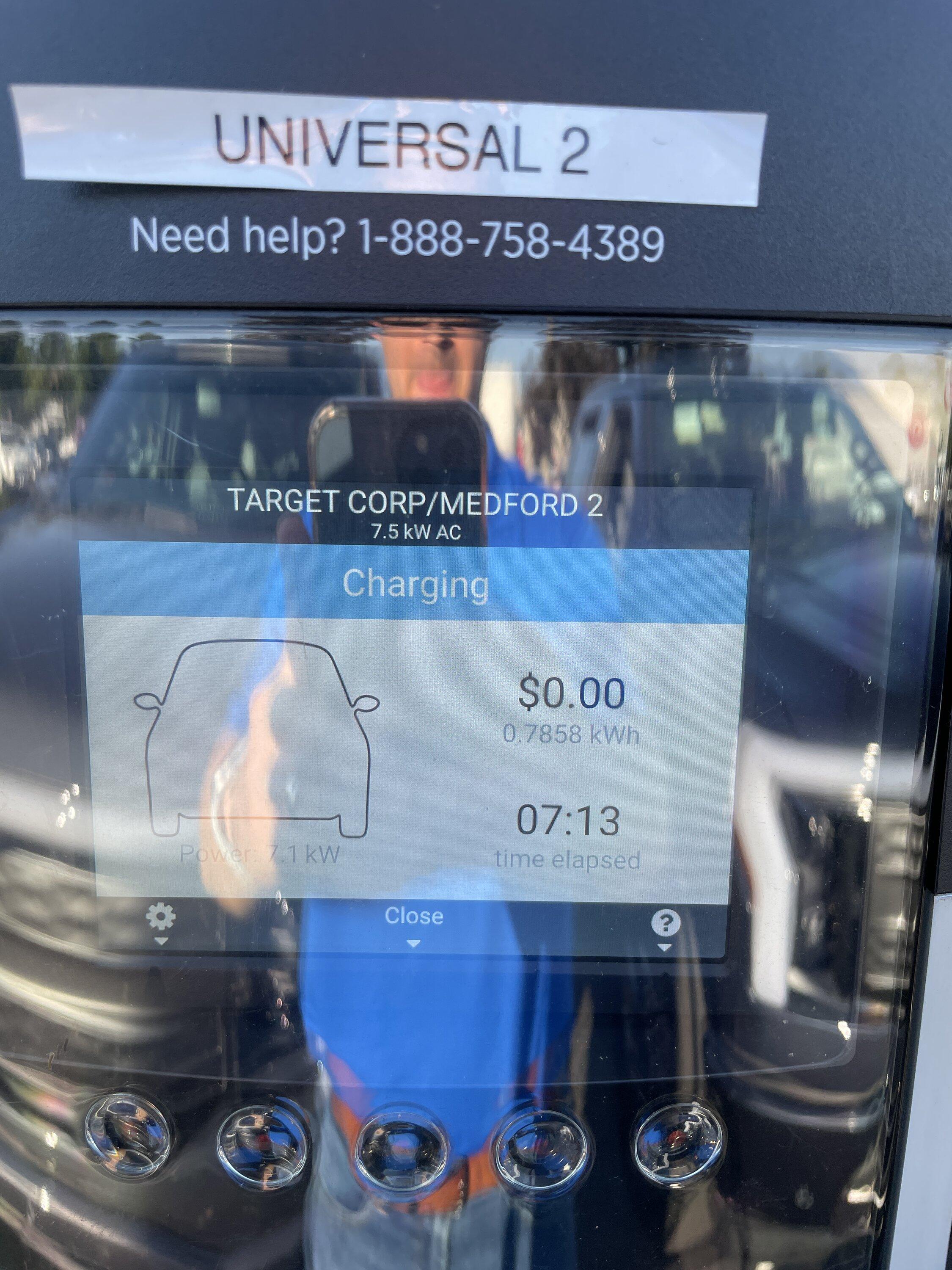

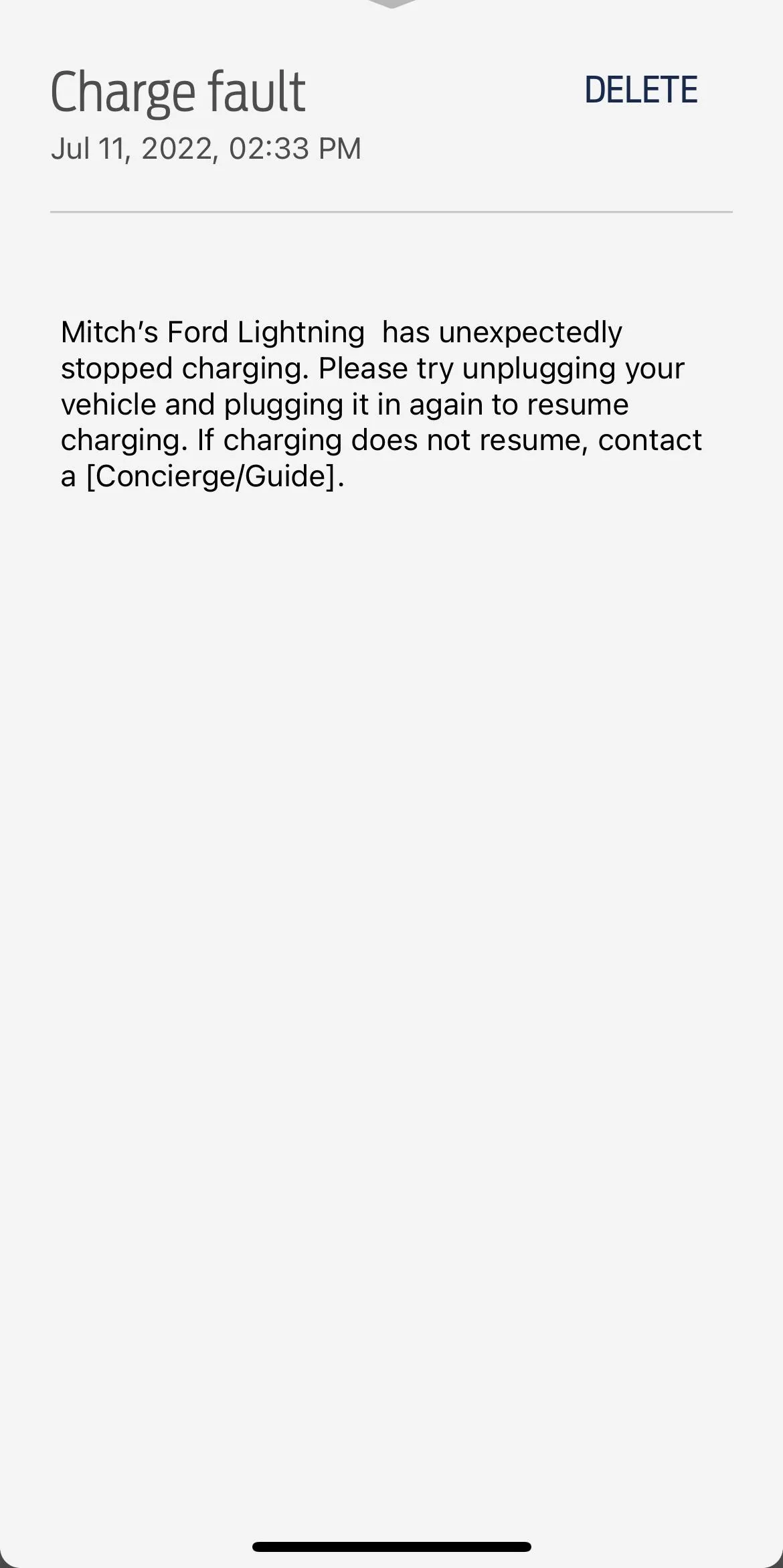

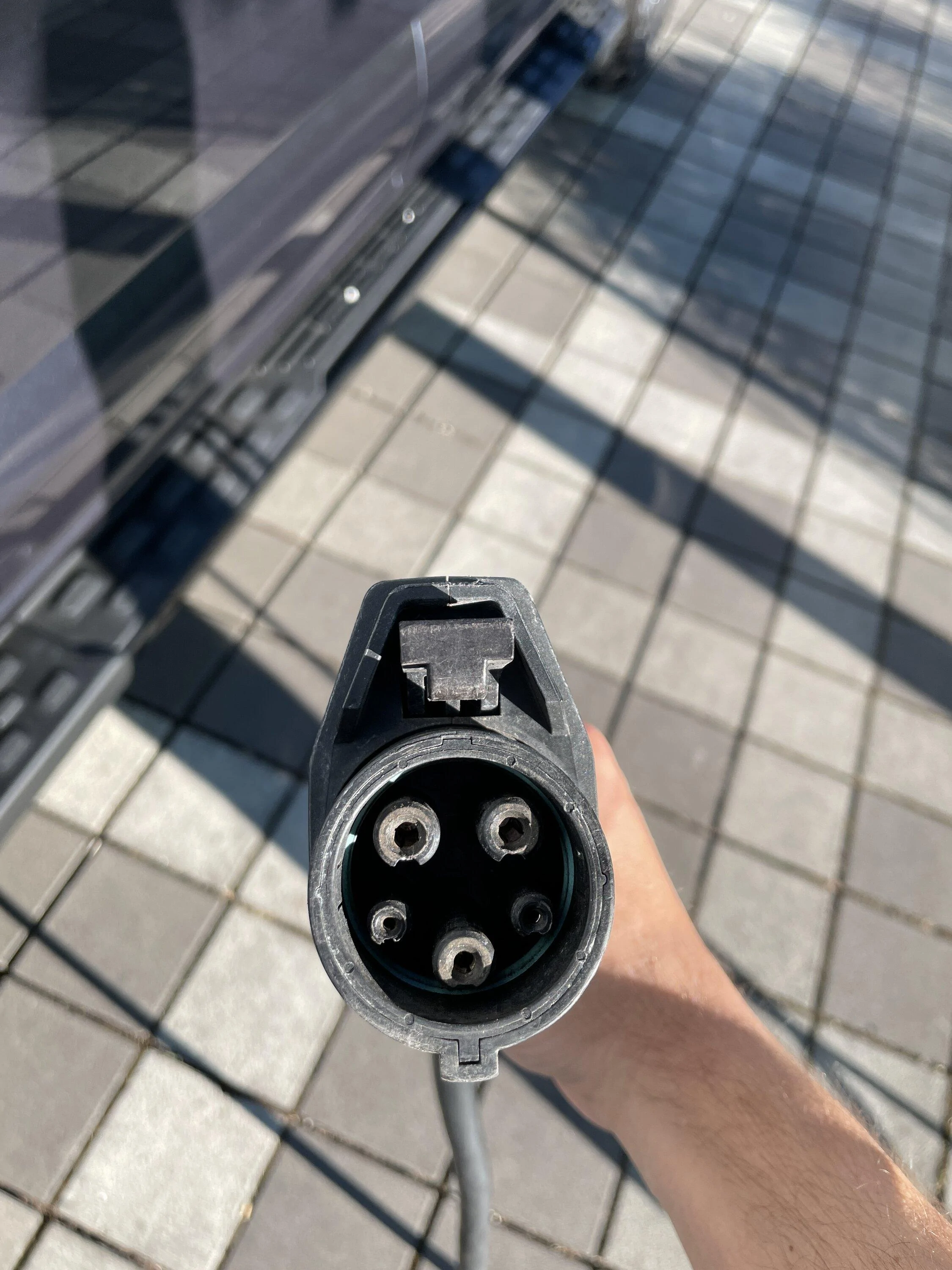

No EVGo Chargers. I attached a couple more pictures of the chargers and the error messages I've gotten. I tried resetting the chargers, bur no luck.

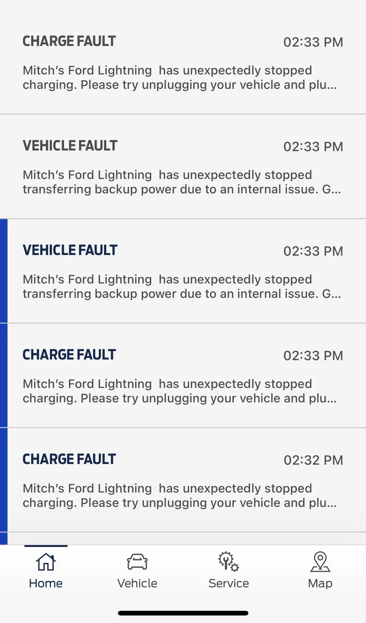

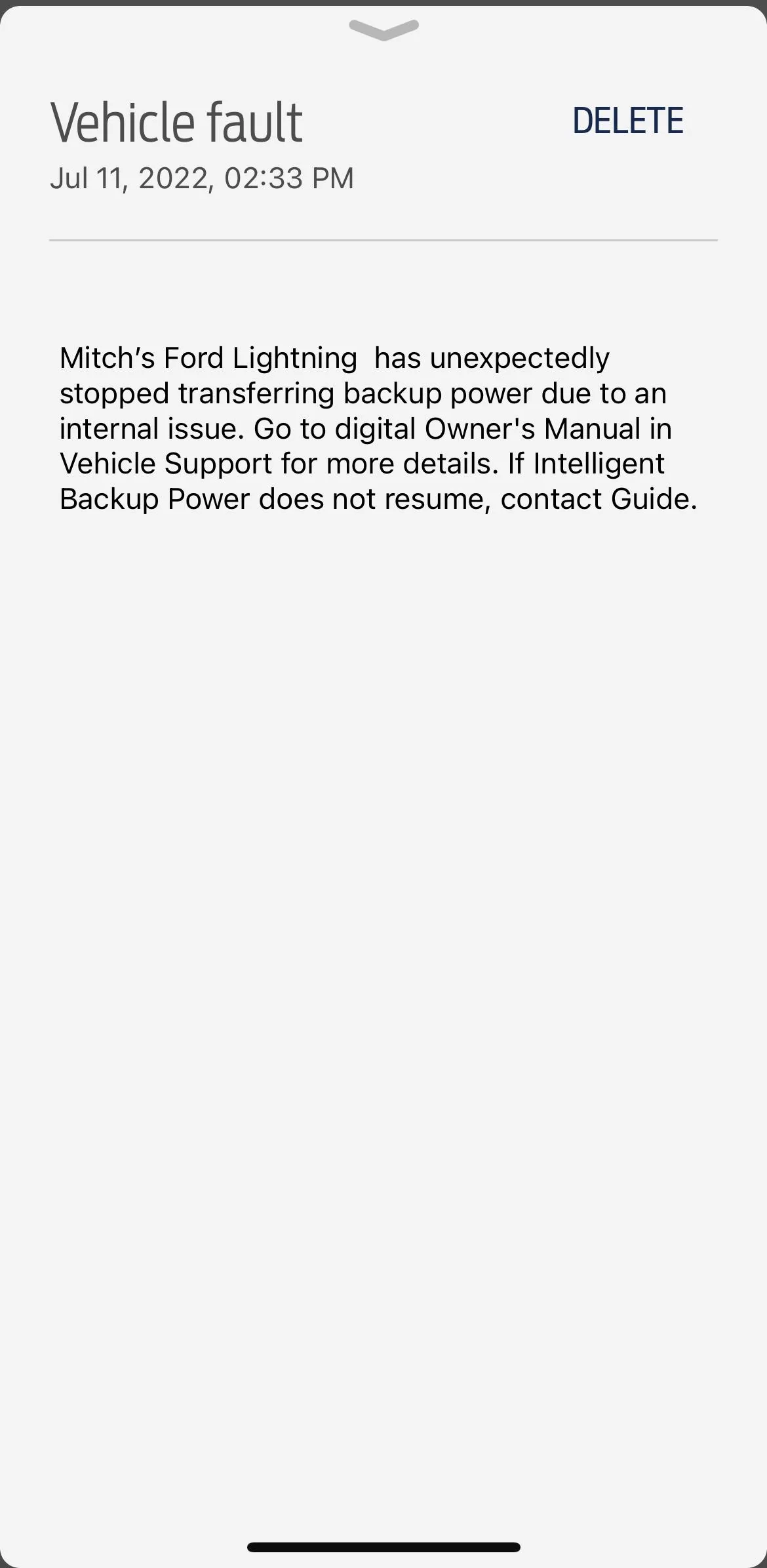

I plan on testing on another public charger this evening to see if I have the same issues. A combination of "Charge Fault" and "Vehicle Fault" error messages? I'm likely going to have to reach out to Ford and my dealer to see what's going on.
the error about stopping providing backup power makes me think even more there’s a power issue at the charger. Maybe it starts charging, loses power, intelligent backup tries to kick in, can’t since the Bosch isn’t made for that, ends the charging session

All the other EVs would never know the difference since they can’t do bidirectional power

The J1772 protocol doesn't deal with bidirectional power, it's a pretty simple one. The protocol required to enable bidirectional power is the digital protocol, like the one CCS uses - it connects the HV battery to the HV terminals in the CCS connector. Unless the Bosch charger is trying to speak CCS (which it likely is not), maybe it's a weird Ford software thing.
Certainly looks like the Ford thinks it's going into bidirectional mode...

I took the truck over to a different level 2 charger (ChargePoint) and had NO ISSUES with charging the truck, though very slow, but to be expected at a free Level 2 charger outside of target. I’m feeling a little better that I can at least charge other public stations. I’ve informed my dealer, but still planning on taking in to have diagnostic run just in case.
