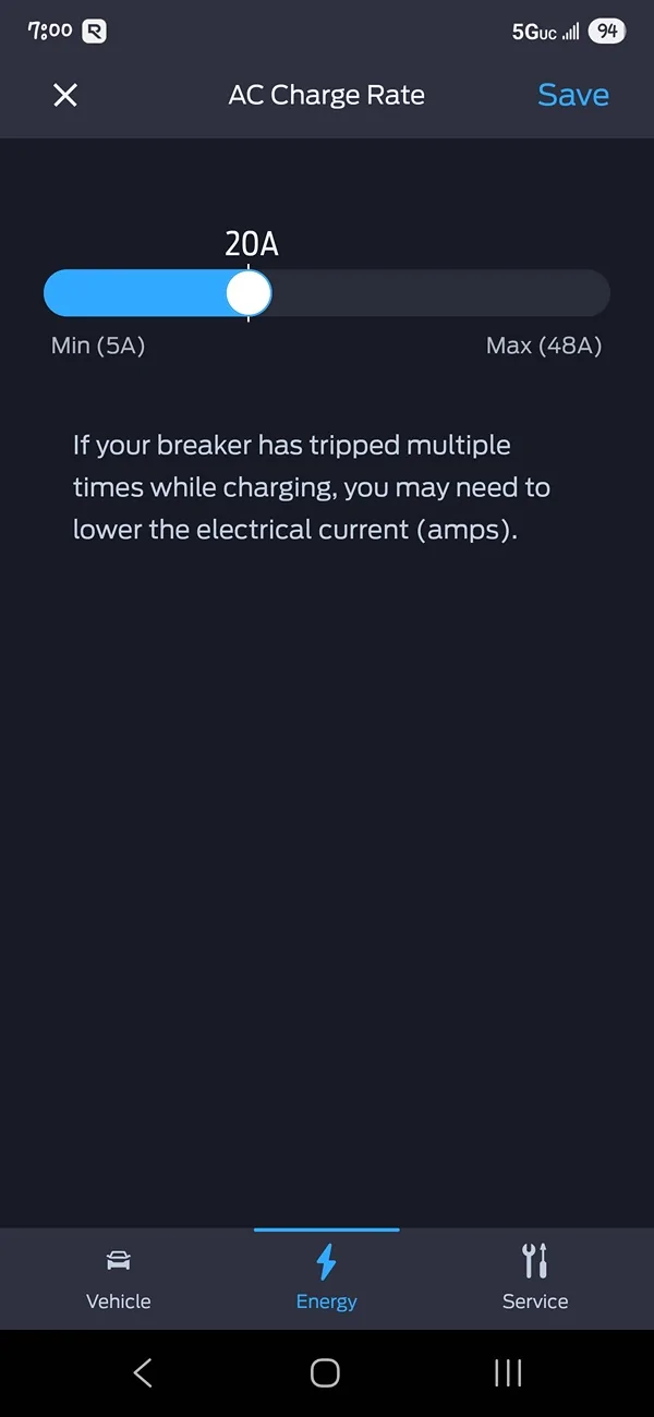

I recently bought a DUROMAX 13000 watt trifuel gen which has the 240V receptacle - have used it on the Lightning and my sons MACH E GT for short periods - I need to get the break in hours up to 8 hrs (for 1st oil change on the generator), so will use again soon. Works like a charm - when I do this again will check the charge amps - I'm cappng my charges at 40A via FORD PASS app.

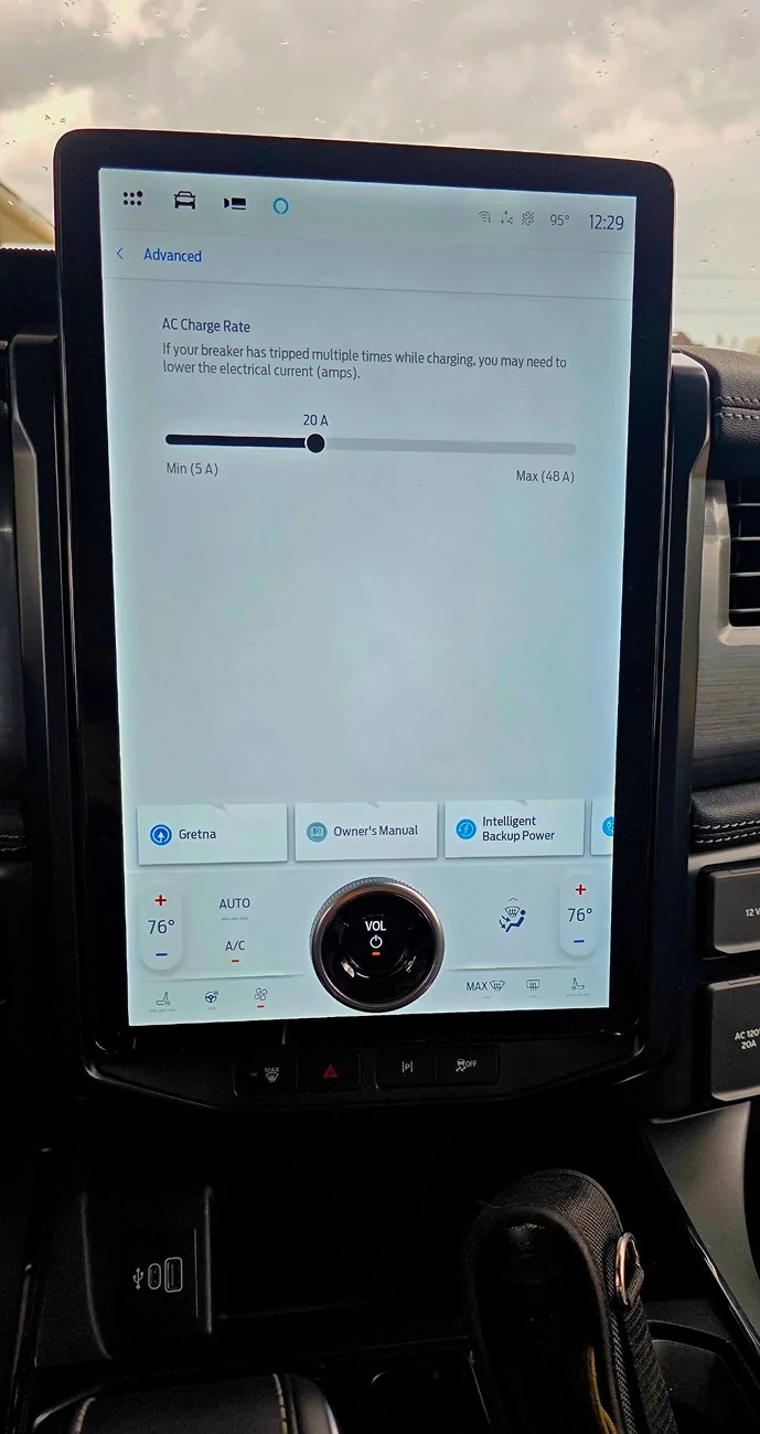

Watts is the big limitation. When using the Ford Mobile Charge Cord, you are limited to 120 volts at 12 amps (1.4 KW) or 240 volts at 30 amps (7.2 KW). There are no other choices - unless you have 2025 which DOES let you set a lower charge current. So assuming you want to charge off a 240 volt source, you MUST have a generator that can continuously supply at least 7.2 KW - which likely means at least an 8 KW generator and likely higher. Check the continuous load rating on the generator. As I recall, my 2.2 KW Honda is rated for something like 1.8 KW continuous.
There is third option. Using the 120v dongle and a 240v source (would need a plug adapter) the Ford mobile charger will charge 240v at 12a (2.8kw).
