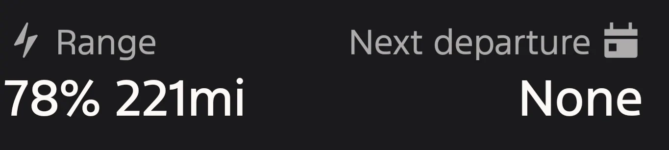

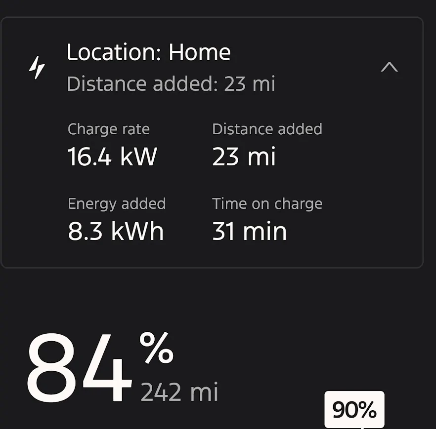

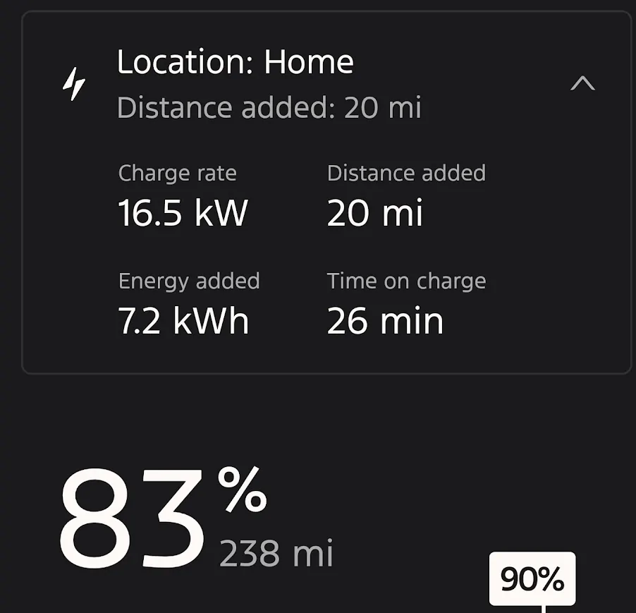

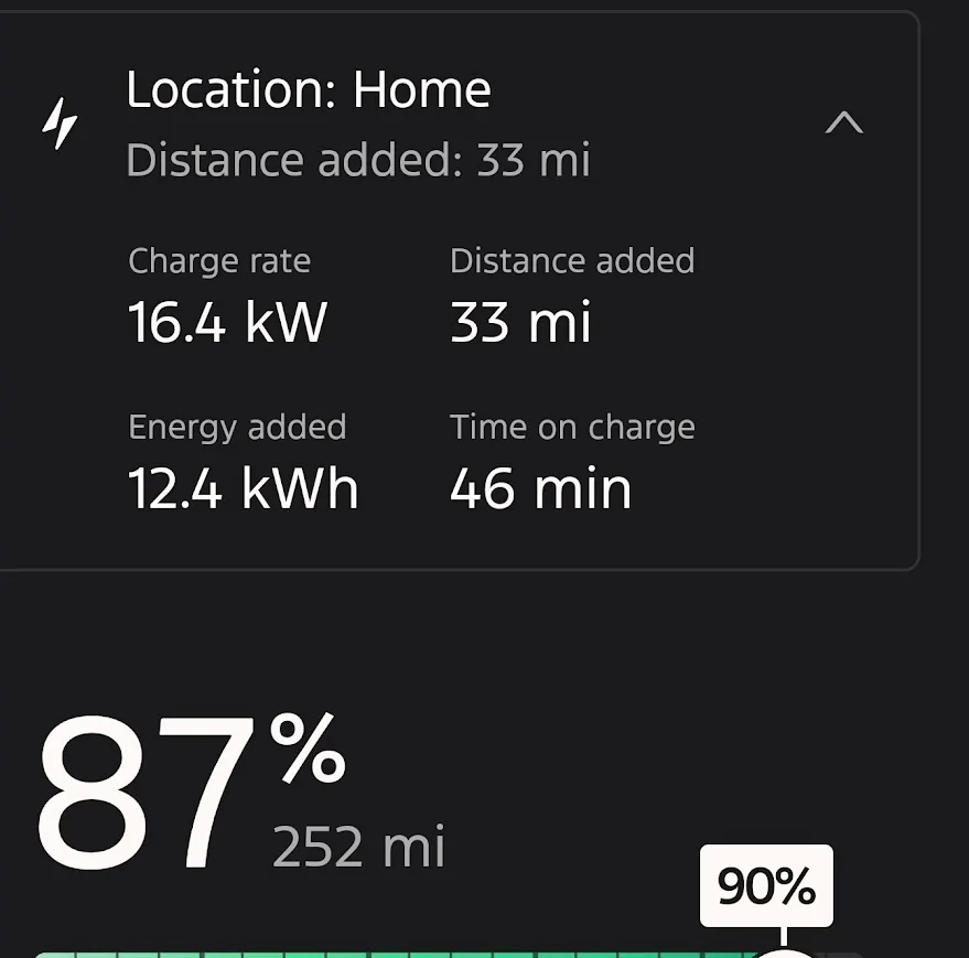

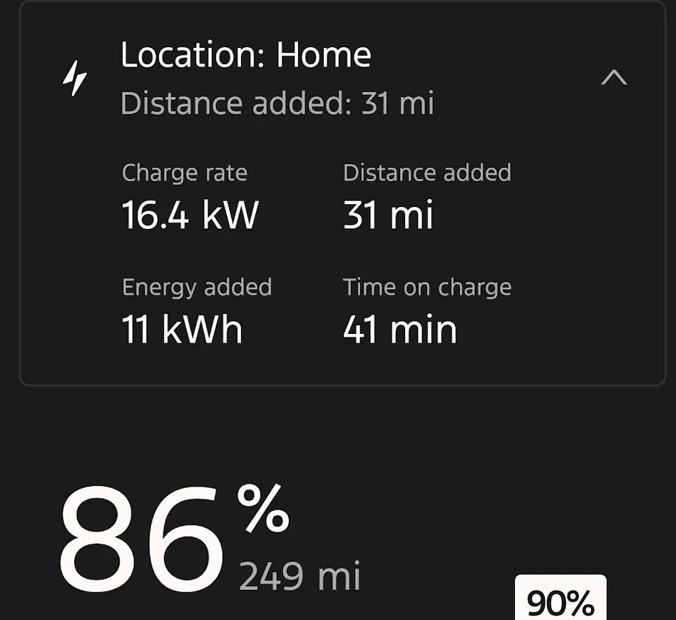

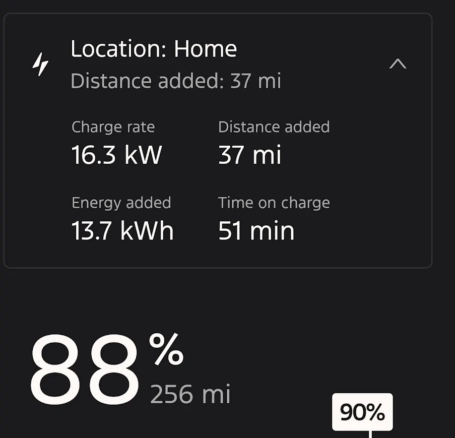

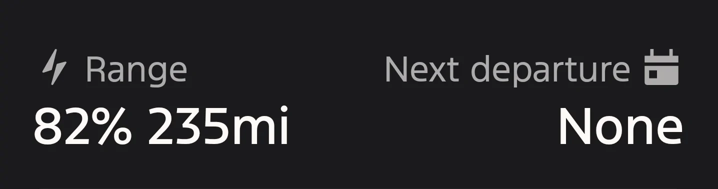

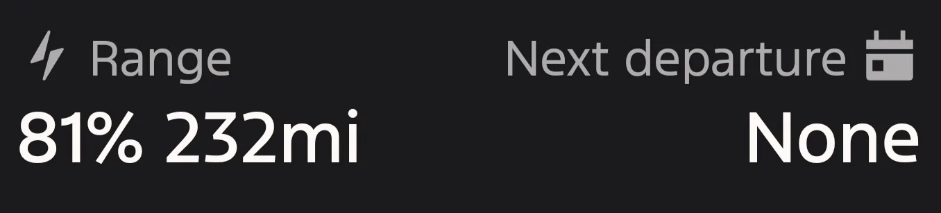

Considering this inquiry, I watched this evenings charge session by the percent increase from 78% to 90%, what's a motorcyclist with PMS supposed to do in winter?!? ๐Ÿค“
Here are the samples, I missed 79 & 80%, so the summary analysis below infers some values.
Ford F-150 Lightning Charging Limit Ignored/Driving History Dumped 1768091585044-ml
Ford F-150 Lightning Charging Limit Ignored/Driving History Dumped 1768091607440-85
Ford F-150 Lightning Charging Limit Ignored/Driving History Dumped 1768091632904-g6
Ford F-150 Lightning Charging Limit Ignored/Driving History Dumped 1768091661520-sv
Ford F-150 Lightning Charging Limit Ignored/Driving History Dumped 1768091690449-ed
Ford F-150 Lightning Charging Limit Ignored/Driving History Dumped 1768091715370-cm
Ford F-150 Lightning Charging Limit Ignored/Driving History Dumped 1768091741260-ct
Ford F-150 Lightning Charging Limit Ignored/Driving History Dumped 1768091766786-6l
Ford F-150 Lightning Charging Limit Ignored/Driving History Dumped 1768091800974-xj
Ford F-150 Lightning Charging Limit Ignored/Driving History Dumped 1768091845732-gd
Ford F-150 Lightning Charging Limit Ignored/Driving History Dumped 1768091867242-b4
Ford F-150 Lightning Charging Limit Ignored/Driving History Dumped 1768091908172-x

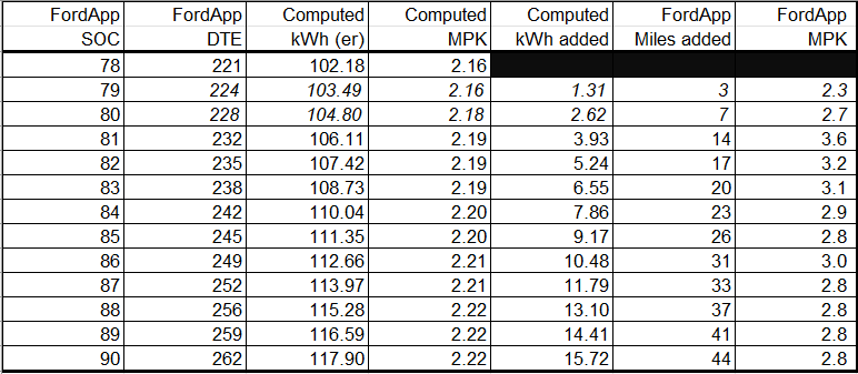

Summary analysis, indicates seasonally adjusted range performance still way above my reality of operation, maybe in the most spartan hyper-miler mode of operation you could get these numbers in southern New England on January 10th 2026. (I did do several off the plug remote starts)
262 miles at 90% implies 291 at 100% which will actually get even more optimistic the higher I charge, presently devalued for the cold season, while in spring/fall it will show higher values.

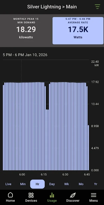

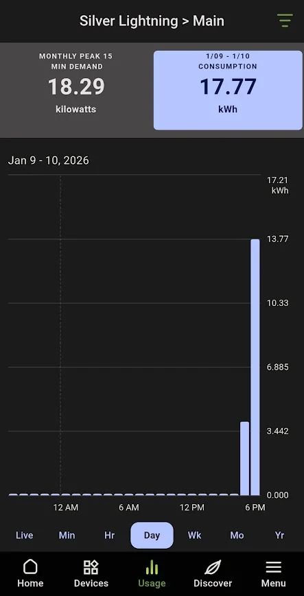

Energy data:
Ford F-150 Lightning Charging Limit Ignored/Driving History Dumped 1768092524881-i9
Ford F-150 Lightning Charging Limit Ignored/Driving History Dumped 1768092552167-on
Ford F-150 Lightning Charging Limit Ignored/Driving History Dumped 1768092587700-z7
