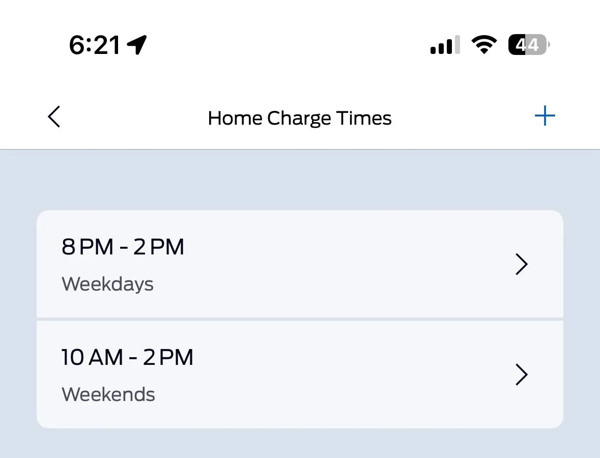

This was today and It automatically stopped at 40%.
This routine isn’t normal for me. The truck is normally charged once it get around 45-50%. I have solar on my house and to try and use the maximum amount of sun shine so I use as little from the grid is possible.
I set the weekend charge to run from 10:00 am to 2:00 pm. I plugged the truck in at 1:00 and expected to restart the charging after 2:00 but noticed it continued to charge. Wasn’t really worried since I was going to do this anyway. But found it strange that it didn’t stop charging until it got to 40%.
What in more concerned about is if the truck is below 40% and it continues to charge during peak times this can cost a lot more than I would expect
