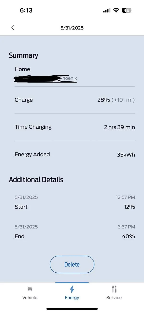

I plug in with a lower state of charge then Ford Pass/FCSP/Truck seems to want to start charging immediately to reach my target charge of 90%. This is frustrating and I've seen this happen multiple times over the last year. I don’t know about others, but I have a electricity plan that will allow for lower cost charging between 10pm and 6am, so that is my set target start/stop. Appx 8 hours and my FCSP set to charge at 32A because of constraints with my electric panel.
This is by design. The truck (and MME) will both start charging immediately if it determines it cannot hit the target SOC in the next charge window. It will stop charging as soon as it has enough SOC to hit the target SOC in the next window. (ie. if it needs 9 hours to get to SOC and you have an 8-hour charge window and plug in 4 hours before your window, it will charge for about an hour, then stop for 3 hours and start up again at your charge window start time.)
I expect this is what happened with @Truaz. The truck determined it needed to get to 40% to get to target SOC in the next charge window, hence it ignored the 2pm stop window until it got to 40%.
The only way to stop this is to use the charge times in the EVSE to force a stop, instead of the truck charge times.

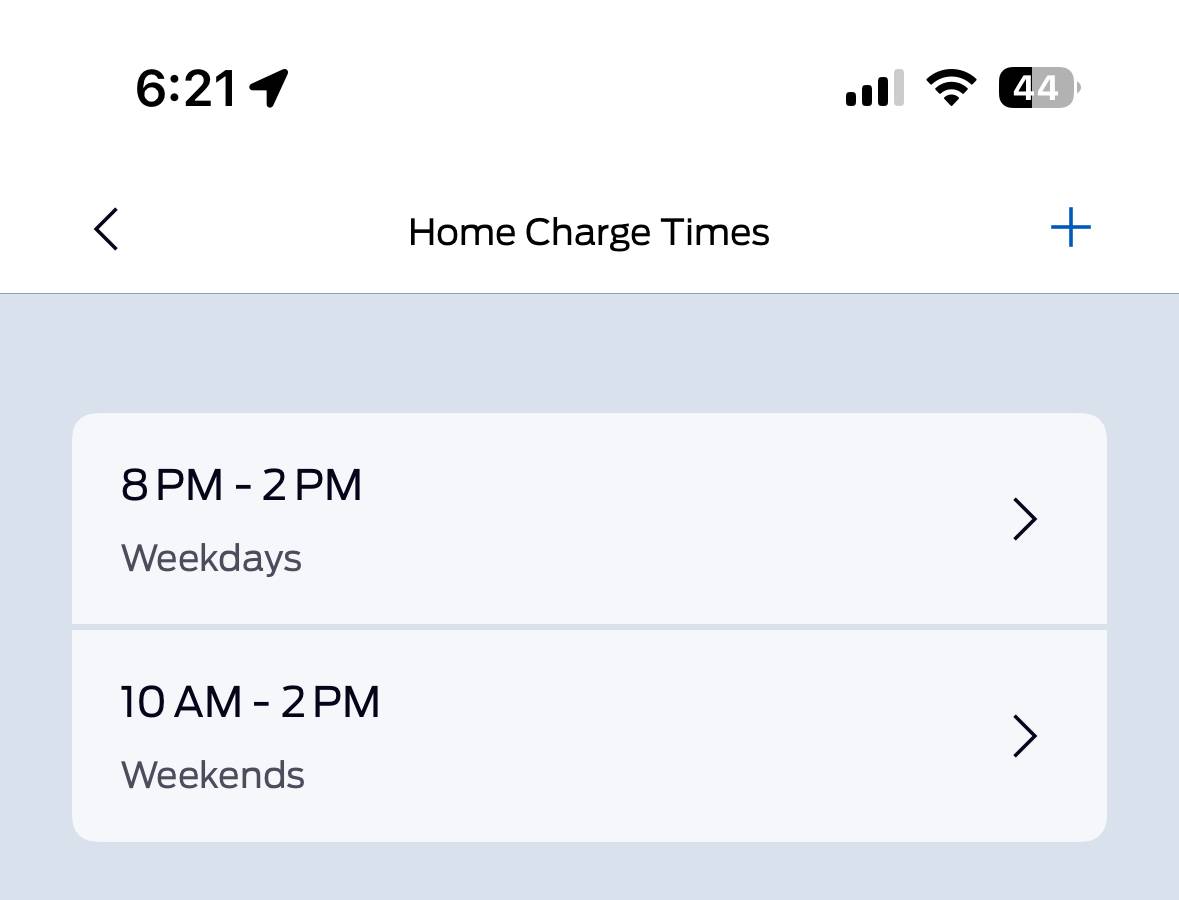

This was today and It automatically stopped at 40%.
This routine isn’t normal for me. The truck is normally charged once it get around 45-50%. I have solar on my house and to try and use the maximum amount of sun shine so I use as little from the grid is possible.
I set the weekend charge to run from 10:00 am to 2:00 pm. I plugged the truck in at 1:00 and expected to restart the charging after 2:00 but noticed it continued to charge. Wasn’t really worried since I was going to do this anyway. But found it strange that it didn’t stop charging until it got to 40%.
What in more concerned about is if the truck is below 40% and it continues to charge during peak times this can cost a lot more than I would expect
