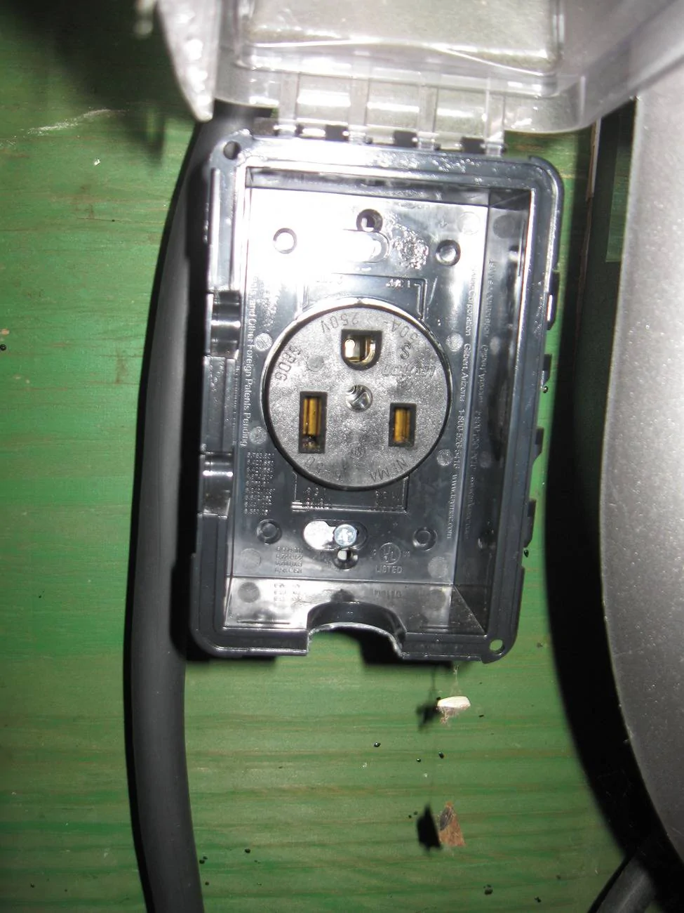

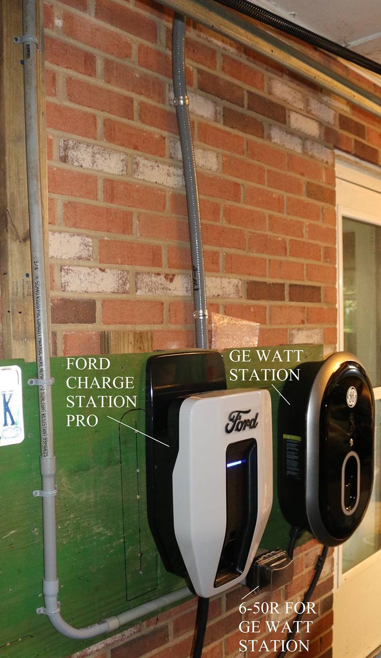

I have an adapter from the 14-50P on the FMPC dongle to my 3-wire (6-50) receptacle that I used for the FMPC when I was using it before I got a FCSP. Since the FMPC does not use the neutral in 240V mode, it works with a 3-wire outlet.
Ford F-150 Lightning Charging Speeds at Home IMG_5860--FCSP and GE Watt Station.JPG
My GE WattStation bought way back in 2011 for my 2012 Nissan Leaf was a plug-in version and had the 6-50P.
Ford F-150 Lightning Charging Speeds at Home IMG_7375-NEMA-6-50 recepticl

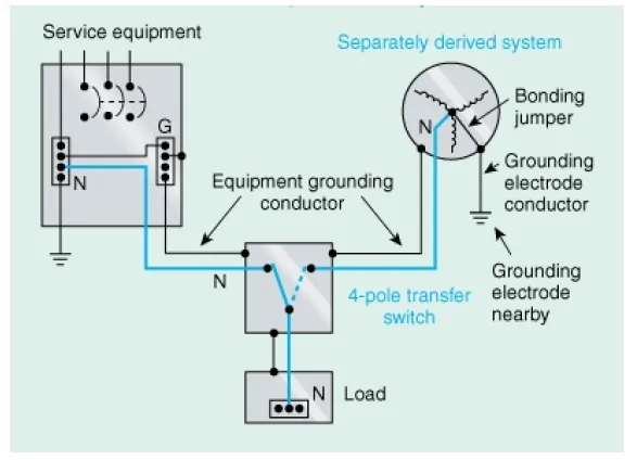

About the ProPower 30A, the NEC code actually exempts generators from the 80% rule under certain conditions: they are allowed to run at full rating if they are protected from overloading, otherwise cables must be 115% of generator rating.
NEC 445.13 (Generator - Ampacity of Conductors)
“The ampacity of the conductors from the generator terminals to the first distribution device(s) containing overcurrent protection shall not be less than 115 percent of the nameplate current rating of the generator…”
“Exception: Where the design and operation of the generator prevent overloading, the ampacity of the conductors shall not be less than 100 percent of the nameplate current rating of the generator.”
The ProPower on-board is for all intents and purposes a generator. It must have a bonded neutral because of OSHA requirements for generators.
OSHA standards require that a portable generator used on a worksite have a bonded neutral. 29 CFR Sec. 1926.956(c).
https://www.osha.gov/laws-regs/regulations/standardnumber/1926/1926.956.
One thing people seem to miss is that if you are powering your house with the Lightning ii should be grounded and have a continuous grounding conductor through the whole system. Some people cut the ground to avoid the "nuisance trips" (which are really ground Edit: LOOP indications not nuisance trips).
Separately derived system (4 Pole ATS)
–Generator neutral bonded to system ground at the generator
–Generator frame requires equipment grounding connection to ATS
Grounding electrode(s) needs to be “nearby”
Ford F-150 Lightning Charging Speeds at Home grounding generator seperatly derived system
Anyway, kind of drifting off-topic so I'll stop here.
