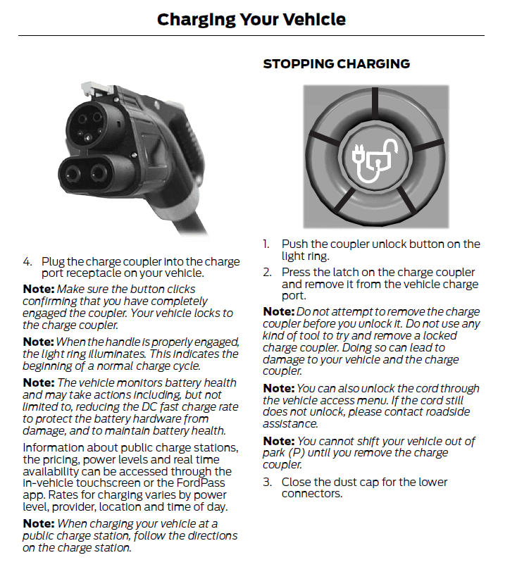

Good question, I charge my truck in driveway, by passing cord under garage door, I always think about pranksters unplugging overnight. The manual does not mention locking, that I have noticed. Just stopping by pressing unlock:
Ford F-150 Lightning Secure Charging at Home 1684255875276

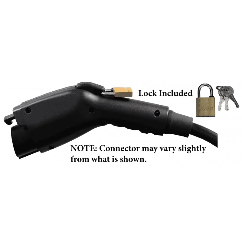

Some chargers have a lockout hole on the charging handle, clipper creek for example.
Ford F-150 Lightning Secure Charging at Home 1684282514042
