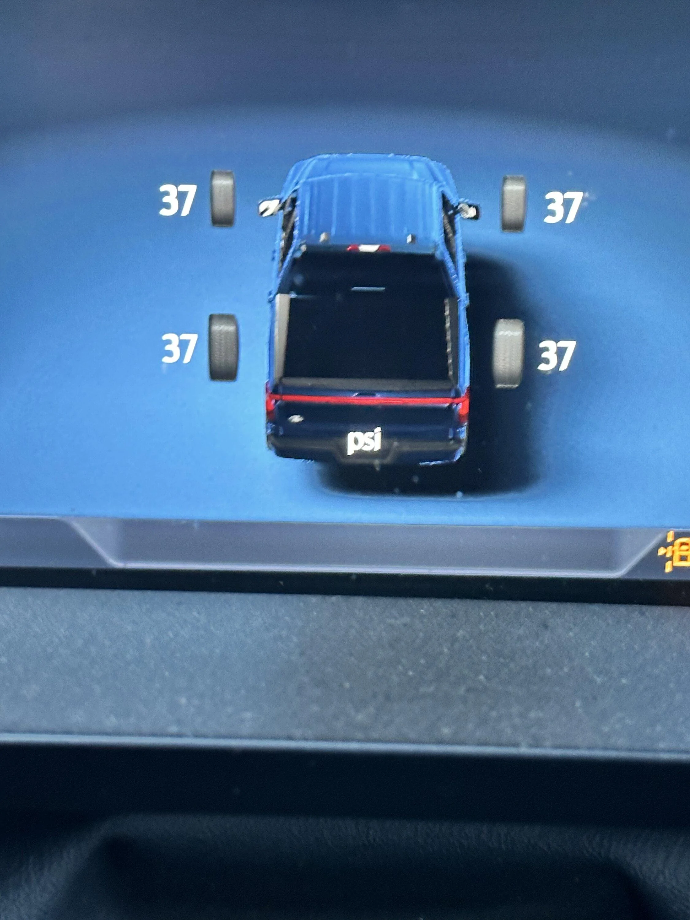

Just a heads up for anyone bringing their truck in for its first 10,000 mile service . Make sure your dealer inflates your tires to the correct PSI .
Let me preface this by saying , I’m extremely happy with the Ford dealer that I’ve been buying vehicles from since I could drive . They also have a great service department .
I dropped my truck off yesterday for 10k service where they topped fluids and rotated tires . For some reason they aired out all of my tires to 36psi which did not trigger the TPSM warning surprisingly even though my truck has been updated after the recall . (Total bill $34.00 btw. A bargain)
This morning I noticed it in the ford pass app . I drove over to the dealer , they fixed it and apologized. I wonder how it would have affected range .

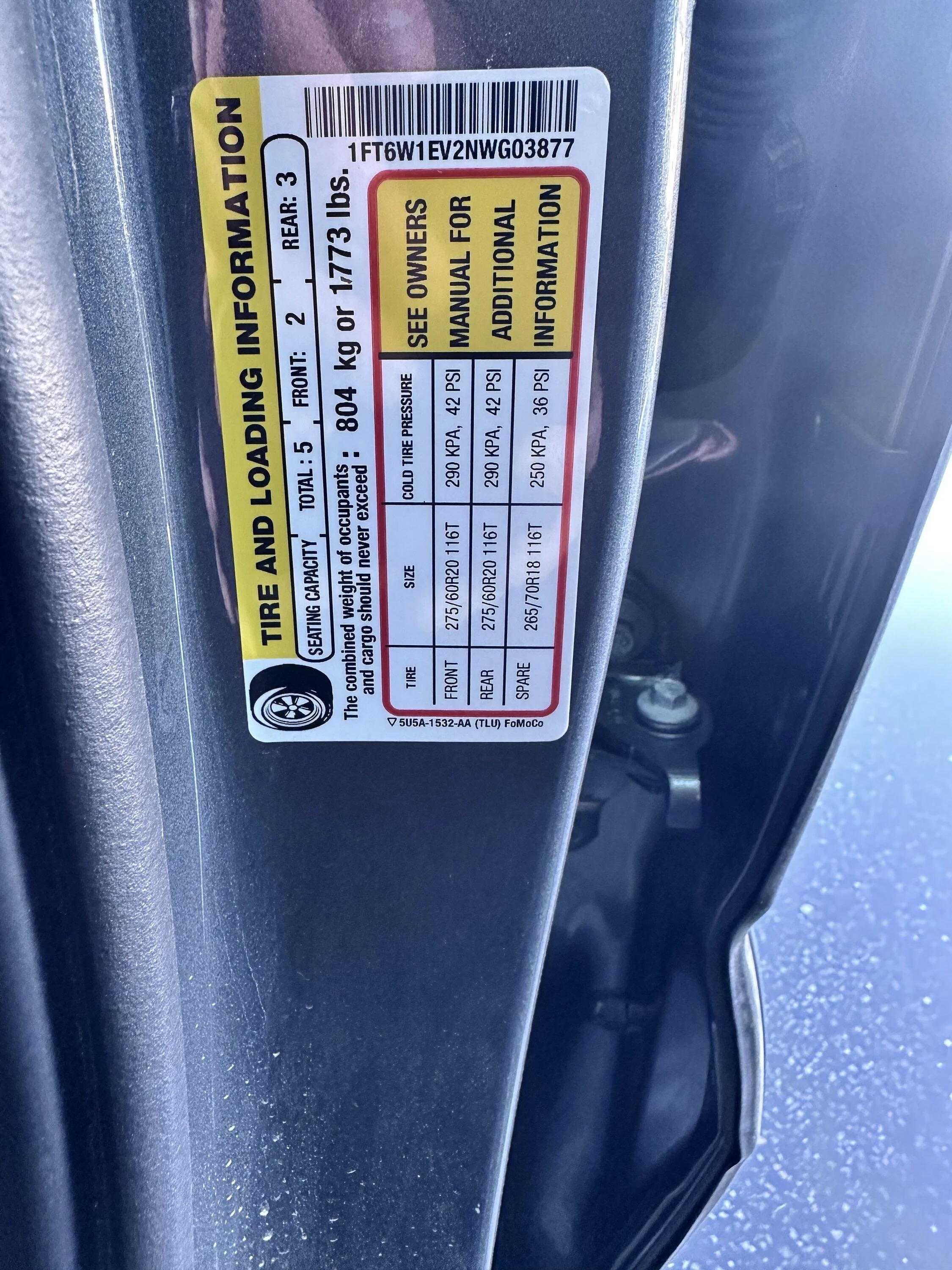

What do you think the correct tire pressure is? What does your door sticker say? 36 PSI is the correct pressure for the AT tire on an ER Lariat.
@GDN . Am I moron ? Should the cold tire pressure not Be 42 psi ?
edit : I see you have the AT Goodyear. I have the cooper tires.
It says 42 on my jamb sticker.

Wait, so my 18 inch winter tires should be at 36 and not 42?
Is there anywhere in the manual that says this?

Looks like your 42 is correct, even though they list 36 for your spare. The 20" AT's are 36 all the way around.
So it varies.
See door jamb sticker. NOT the manual
all terrain AT
or
all season - all season lariat er 42lbs

Understood...but winter tires would fall under which of these categories...? Lol

Thanks for starting this thread OP. I didn't check my tire pressure when I picked mine up 2 days ago. Sure enough, they were set to 37 psi. I set them for 45.

I swapped my 20s for OEM 18s. So to confirm, I had 42 psi on my jam sticker and I should now have 36 psi on the 18" wheels?
