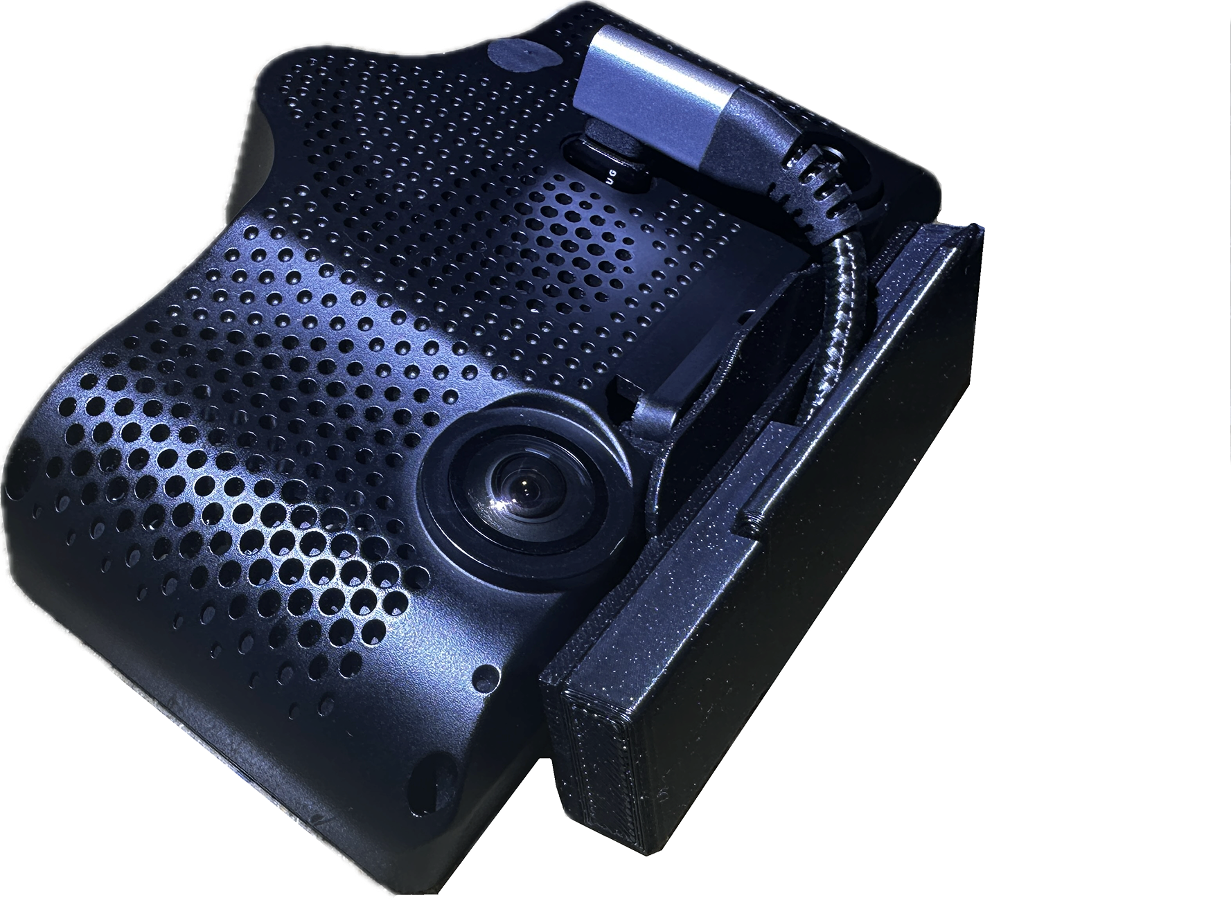

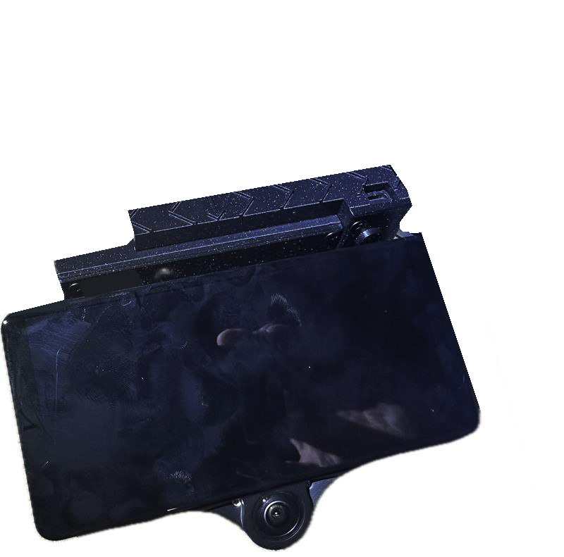

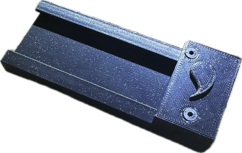

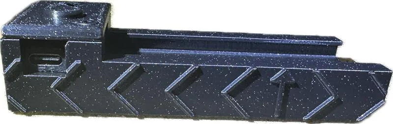

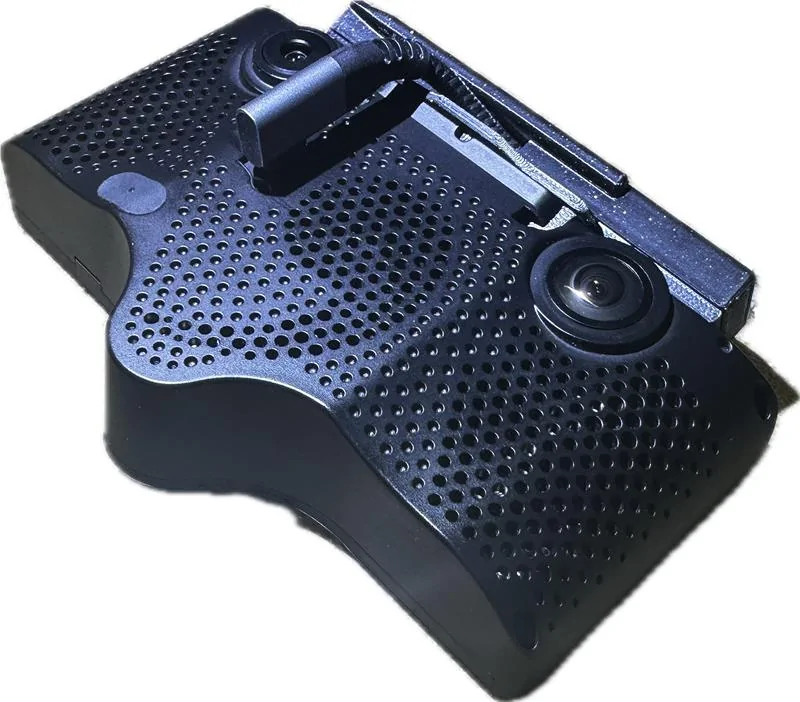

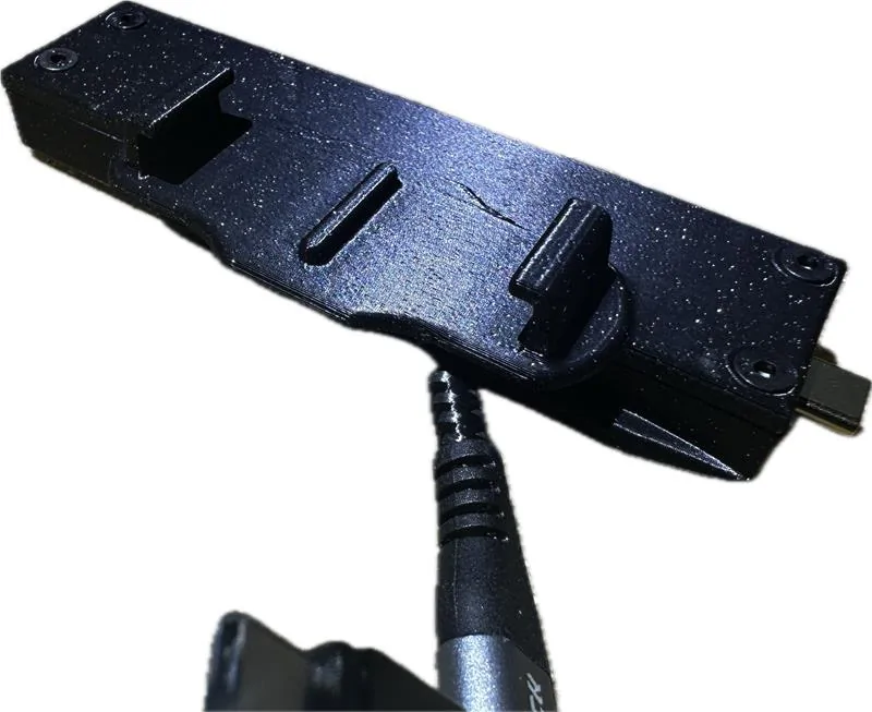

Yes. I move mine between F150/MachE/Escape all the time. I designed a 3D printable docking solution you can use to make it even easier (files are free to download or I make and sell them for those with no printer).
I also have a new, much nicer, dock that should be ready in about 2 weeks that I'll be selling.

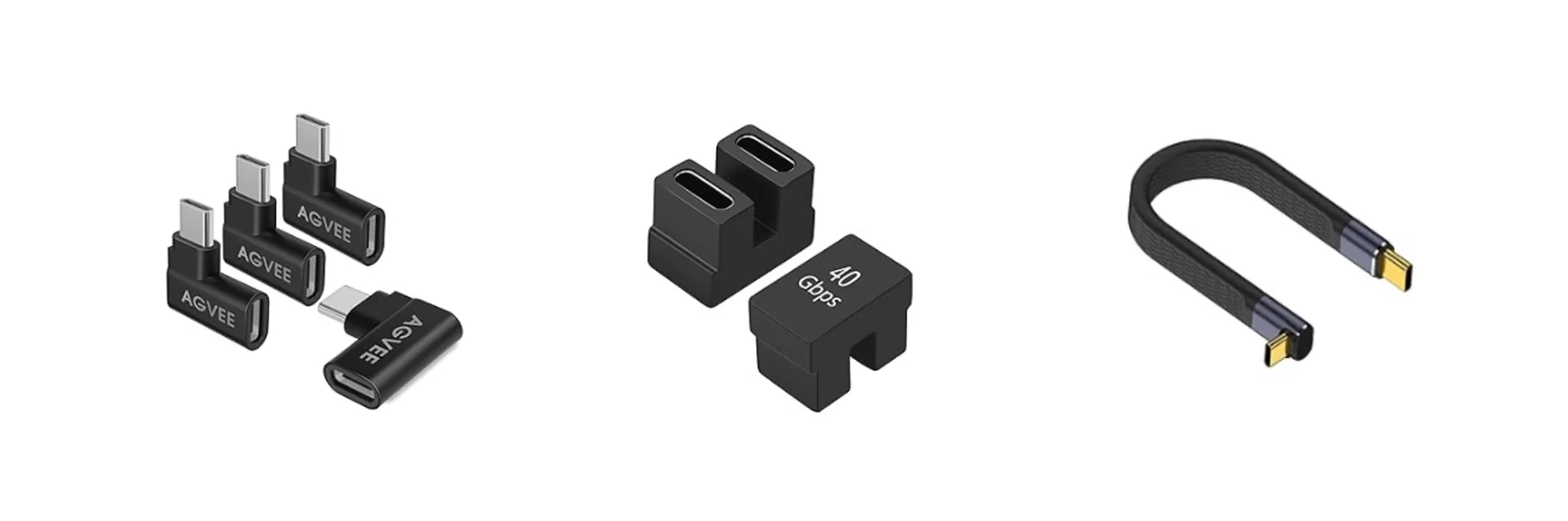

So, I've finally had the chance to install my Comma 3x and I'm getting the "Faulty Cable" error. I'm using the sliding dock mount and I've narrowed it down to these three parts:
90Âş Adapter: I don't get the error when plugging the long OBD-C cable into the right angle adapter in the dock but I also don't get any bus signals to the Comma (it is powered though).
180Âş Adapter: When bypassing the dock and plugging the long cable into the 180Âş adapter and running through the short extension it throws the cable error.
Short Extension: I'm not able to test the short extension without the 180Âş adapter because I don't have another female-to-female adapter handy.
When plugging the long cable directly into the 3x I receive no errors and reach the calibration screen. Also, I'm using a DIY breakout board located at the IPMA with 360 ohm resistor. All parts are from links specified here:
https://www.thingiverse.com/thing:6297226
Any thoughts?

I've gotten a bad batch of the 180 degree couplers from amazon recently. They should have been a pair, did you try the other coupler?
watts/up
Apr 2, 2024
276
263
23 Pro SR
Thanks, I was hoping you’d be able to help narrow it down based on experience. I haven’t tried the other one yet but will do so and report back.
Have you had any issues with the 90? Seems odd I wouldn’t get the errors using that upstream but also don’t get signal.
Ajzride
Alan
Jun 6, 2021
781
811
Houston
Eng
Out of over 100 I've installed, I've had one bad 90-degree adapter. The 180-degree adapter is much more common to fail, and about 4 of the last 10 have been bad. My new dock is explicitly designed to eliminate that 180 and hide the short cable so it isn't in a place where it gets touched a lot. Because I handle my comma so much during development, I have worn out 3 of those short cables.
