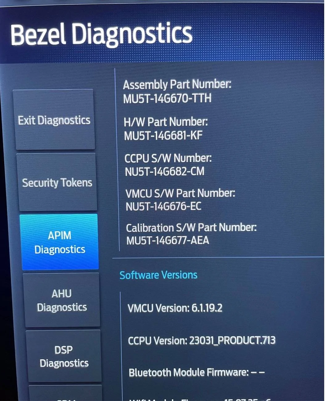

You may be able to use the Bezel Diagnostics to see what part number the APIM is.
Ford F-150 Lightning Connected Built-in Navigation Renewal Screenshot 2024-12-06 at 7.58.38 PM
There are a few post around here that explains how to use it. I also found a pdf document that explain how to get into the Bezel Diagnostic screen on your truck.

Thanks, Mike and TaxmanHog, for digging into this.
I can’t seem to find the work order for the visit when the APIM was replaced back in March, but I’ll keep looking. Isn't this what we are looking for? MU5T-14G681-KF Alternatively, I’ll just ask the dealer to provide it.
APIM part numbers...
Your Platinum truck currently has a MU5T-14G681-KF part.
My '22 Lariat has a MU5T-14G681-KG part, if that helps.

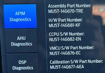

Not sure what's next.
However I did take a pic of my APIM just to compare. Some of the numbers are a bit different, although I am not sure it really means anything.
