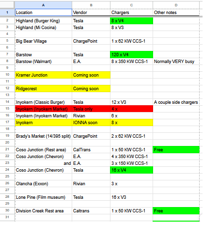

When doing you pre-departure charging planning, I use PlugShare.com and pay attention to the photos that are posted. You can also check Google Earth (including Street View) to confirm what is available for trailer pull through.
Next suggestion is to detail and document you pre-trip research. For a couple of trips I have taken I have a spreadsheet with charging options along the way. That way I can quickly determine what is coming ahead during the trip. Note: I keep this as a Google Sheet rather than an Excel Spreadsheet so that it is easily accessible from my phone. Here is an extract from a trip last fall.
