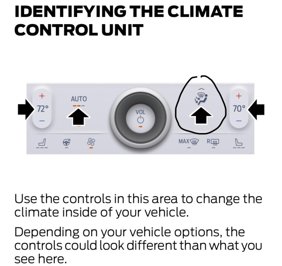

Now that it feels like Spring in Cincinnati, how do I open the dash vents for ambient outdoor air without any heating or cooling? What about with or without the fan also?
3,769
6,846
You don't.
Only thing you can do is set the temperature and turn off AC and heat

Yes
Turn off the heat button, turn off the recirculating button, and turn off the AC. There air will be coming from outside, and will be neither heated nor cooled. See the fan speed for whatever you want.

I don't know how to turn off the heat and A/C with the fan running???
Reactions: N87
3,893
5,070
That’s mostly true. The AC will still get activated if the truck thinks it needs to. I wish it didn’t, but it does.

This was all so much easier in my 2014 F150.
195
14,491
15,804
Most important step is avoid the AUTO button, touching it reverts the E-Heat or AC to automatic operation depending on season and ambient outside / cabin temps.
