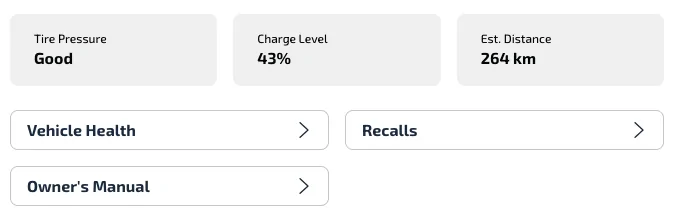

Your symptoms sound like a weak 12v battery. If your 12v battery drops to 40-50% SOC the truck charges it from the HVB and shuts down many modules like the modem to conserve energy. Given your symptoms I'd check there first. You can check your 12v battery SOC online on your account at Ford.com from your account screen.
Ford F-150 Lightning Ford Pass connects for a bit after modem reset, then once I charge again disconnects 1709307287062
This is an example of the last update it will give. 12v SOC (Charge Level) is 43% and it will no longer get updates since the truck will charge the 12v and shut down the modem.

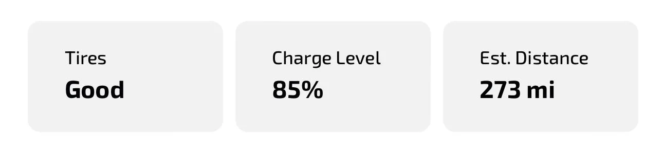

I’ll check now. Where can I see the modem light?
Jamchampnate
Nate
Feb 29, 2024
208
276
Utah
Ford lightning 23’ Lariat
Battery showing good health unless that’s before the battery dropped lower and it’s not updating anymore haha
