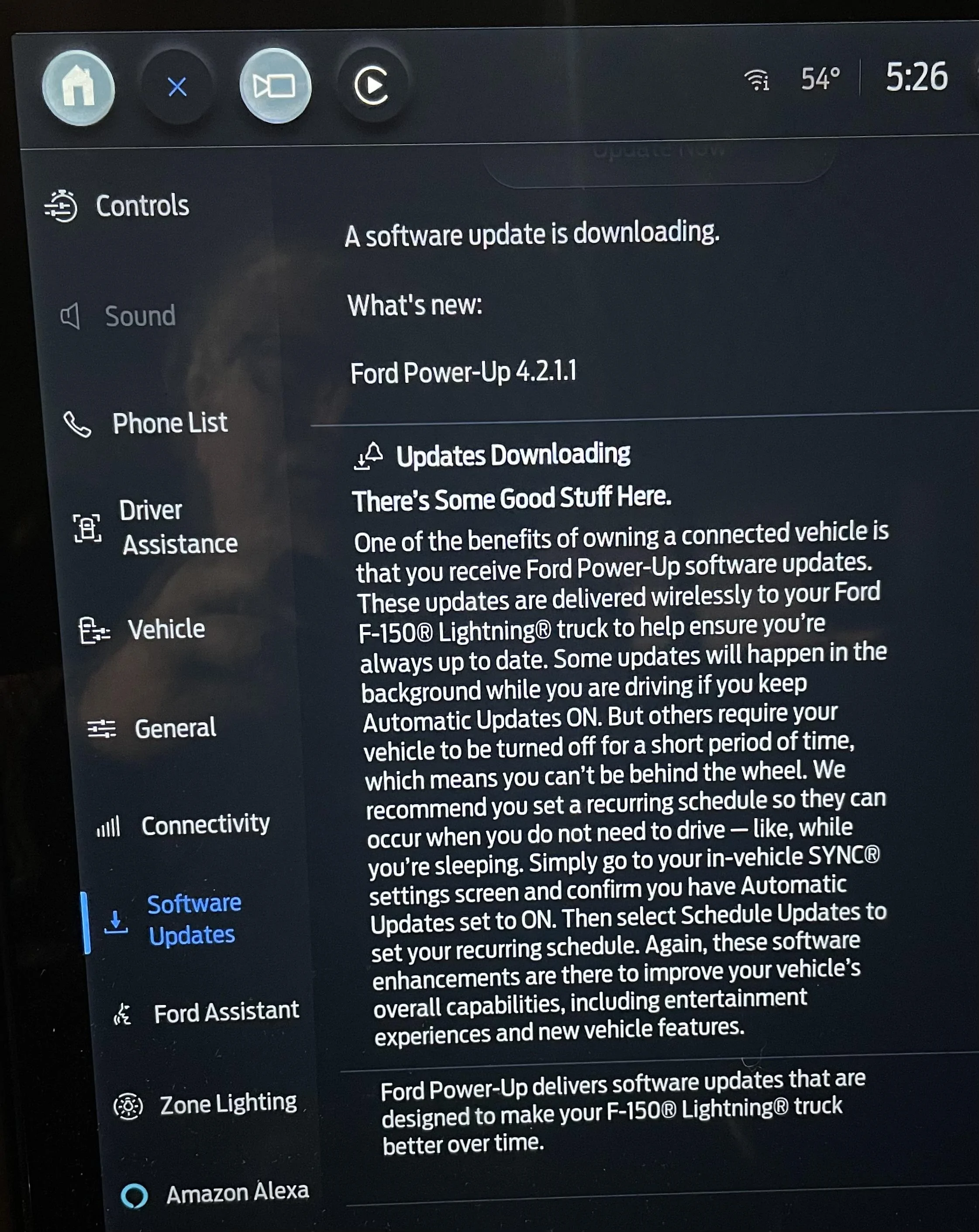

I had an interesting OTA episode while at home for a week. Charger was plugged in. Auto update turned off for 6 days straight. Got in the truck turned it on and download happened. Then turned delayed power off and left it on for ten hours and the download loaded. Then updated the next morning.
Note the Power up update number for this April ‘23 build. 1st update ever.. shocker, now the BMS is faulty since.well before Turkey Day. Recorded 6% SOC at LVB after sitting at work for 10 hours. Still started to that “Sensor IQ” is.. low. ?. It’s getting replaced. Truck never abandoned or threw of various colors of ill health.
