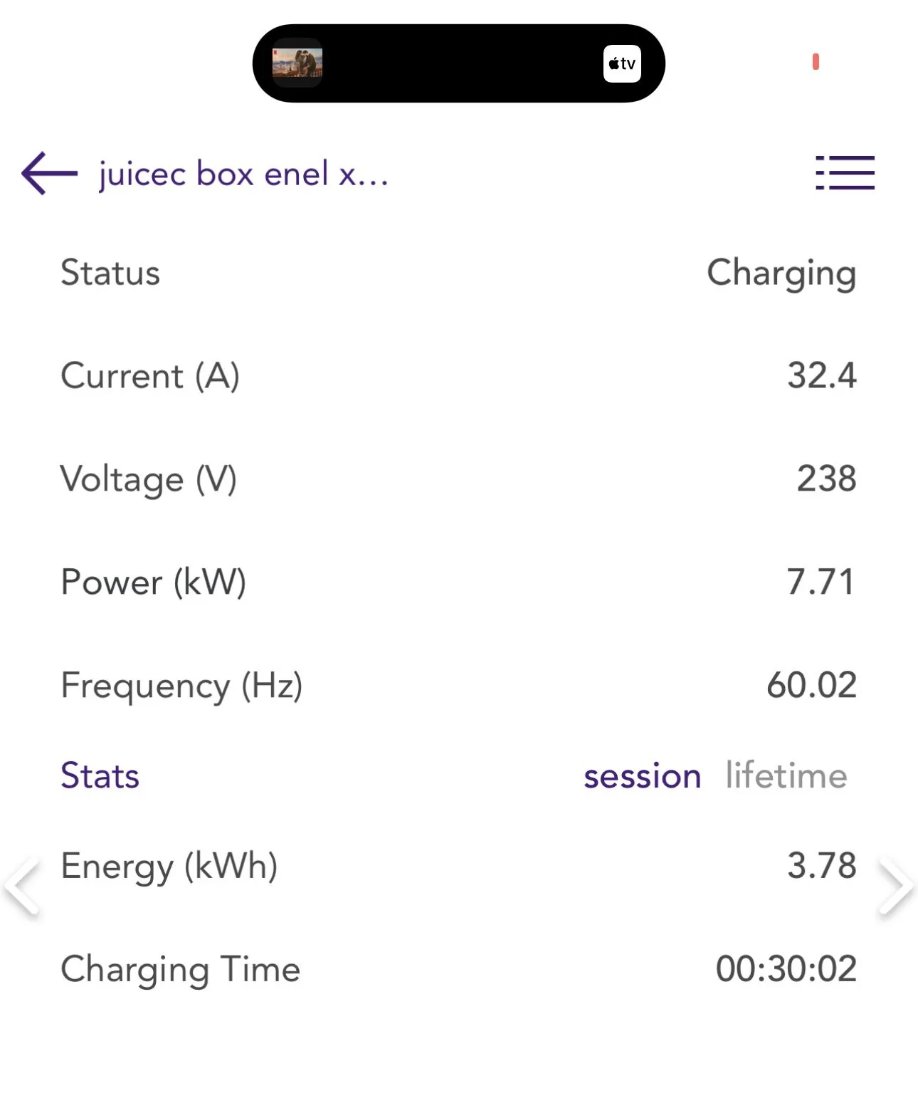

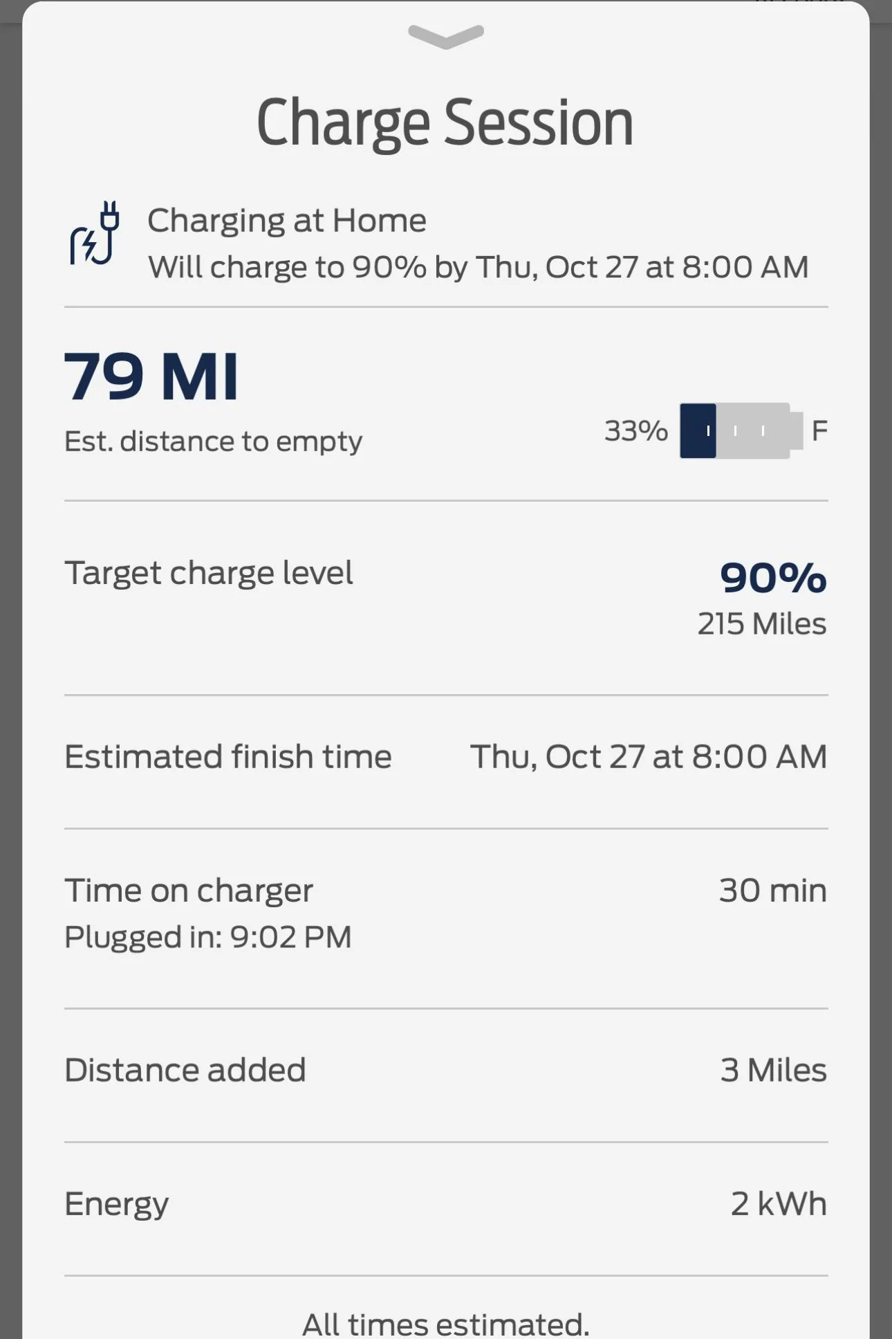

So I have noticed that my EV juice box shows a higher amount of energy added than what the Ford App shows.
why would this happen?
Ford F-150 Lightning Discrepancy between electricity going in and battery 59E7DB02-A54B-442D-856F-F532C3B2E003
Ford F-150 Lightning Discrepancy between electricity going in and battery C1A054C5-CAF7-4DE4-9110-AF880E991F04
The JuiceBox is measuring kWh delivered to the truck from the JuiceBox, which includes energy lost to heat and operation of the coolant loops and inverters. The truck is only reporting the energy that's added to the battery pack. Also, I would not trust the Ford app to give you accurate real-time or logged charging session data--it's been unreliable in my experience.
You should expect to lose around 12-15% between the EVSE and battery with level 2 AC charging. Losses should be below 5% with level 3 DC fast charging.

Put in 3.78 and got 2. That’s no where close to 10-15%. Loss.
4,444
5,983
There’s overhead involved initiating a charge. Short sessions always look worse. Notice that by the time the session completes, the losses are in line with expectations.
Another problem with small numbers is that the Ford side is rounded. 2 could be 2.4. Maybe even truncated from 2.9?
"update: in this charging session the final results are 71 in 64 charged". That is 10%, and better data than going off of readings at 2kWh of charging to the whole number kWh precision.
