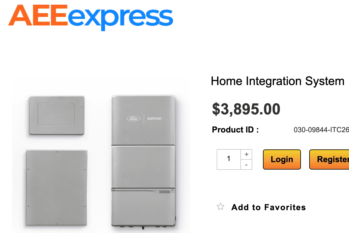

Here is the HIS you can buy separately for your Ford 80A charger:
Ford F-150 Lightning Distribution of 80-AMP Ford Charge Station Pro (Home Charging Station) Screen Shot 2022-04-30 at 9.18.01 AM
And then when you order it, they won't fill the order until after their customers get their orders filled. My estimate on delivery of this part is 9/2 and it was ordered at the end of March. This is the issue for me.

Guess the only thing to do is order the HIS part, line up your electrician to prep the house circuits, and use the mobile 32A charger in the meantime.

Or be willing to pay SunRun a $1500 "Priority" Fee... Maybe if I look at it as a "safety issue" as it would allow emergency backup power in the 6 months (probably)... Nope, just a rip off still

Wow, so SunRun is making money off the sales plus "prioritization" that dealers charged if you want to skip the front of the line.
Maybe SunRun will fall into Tesla powerwall & solar panel debacle...
