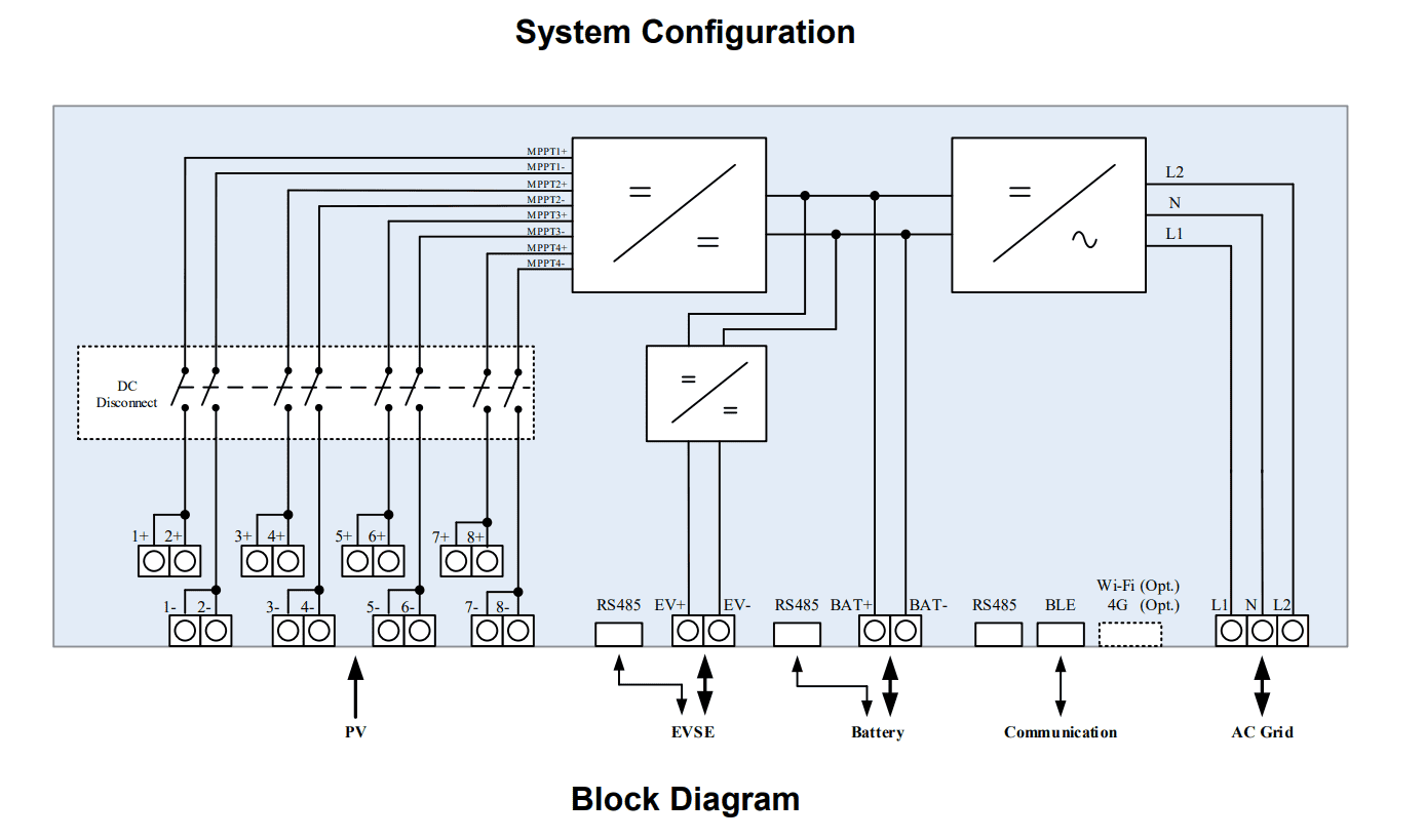

Nope. The HIS inverter has solar inputs with DC-DC conversion to match Truck battery voltage independent of what is happening after the AC conversion. AC coupling an existing system is more problematic with handshaking between multiple inverter manufacturers required to make sure the solar production is under control.

@tommolog stated in January video based on conversations with Ford the solar can be used to power the house when separated from the grid. They seem to have told him the solar isn't currently allowed to charge the vehicle during this time (which is problematic for the value proposition of the HIS installation) but that they are working on it. They've had 4 month to work on it and hopefully are putting the effort it to make it works since @Ford Motor Company makes home back-up a top line selling point at every marketing event. The HIS specification sheet shows the hardware/comms are clearly in place to send solar power right into the Lightning with no conversions to AC (see the bi-directionality arrows on "EVSE"?). They just might be hesitant to allow it as they may want to software-limit the ability of customers to just charge the vehicle with 9.6kW DC from the HIS.

This limitation makes sense if they are using the same conductors to draw DC from the truck as they are to push AC to it for charging. I would much prefer to install extra wire and be able to power my house from solar while also charging the truck, then switch to battery when solar output drops. As the HIS/BDI has a microgrid, the software should allow it, selecting charge vs draw, even if manually.
If not, this is a MAJOR limitation, and not worth the money. Begs the question; If I can't charge the truck from solar, why not just draw power from the bed to critical loads? This needs to be understood before I invest, and I would not trust SunRun to know the answer.

…..using the same conductors to draw DC from the truck as they are to push AC to it for charging.
That’s not possible. There are separate AC and DC conductors in the charge cable.
211
15,516
17,302
Two conductors could be used, if there is switching gear inside the Ford Charger Pro and the HIS:
Step 1: at the HIS in the house, switch conductors from AC/240 to DC inverter input.
Step 2: at the EVSE, switch from J1772 conductors to CCS conductors.
Step 3: F150L contactors close in the truck connecting traction battery to CCS-1 DC pins
Step 4: The DC/AC inverter sends 240v split phase to load side transfer switch, select circuits.
This is what I invision, but I could be 100% wrong, if someone has the actual schematic diagrams of the system [EVSE & HIS] not just a general pictorial ..... I'd love to see it.
That’s true…complicated, but true. ? I think having the AC & DC use separate conductors all the was back to the HIS would result in a simpler, less expensive arrangement.
My point was that there has to be separate AC & DC conductors between the EVSE and the truck. I think that was the post I quoted was implying.
I’d also like to see a proper schematic drawing.

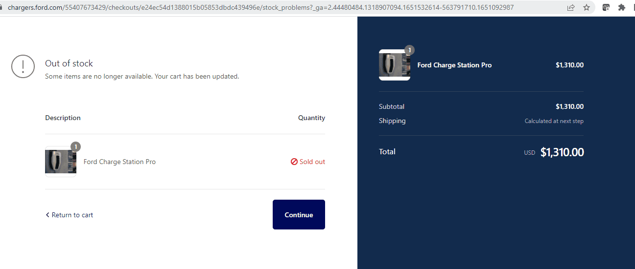

Got this email today. I'm not in the market for a Charge Station Pro (XLT SR) but was curious enough to add a Charge Station Pro to my shopping cart.
Ford F-150 Lightning Distribution of 80-AMP Ford Charge Station Pro (Home Charging Station) 1651532845726
Not a Backorder or Contact Us for updates or anything just a "Sold Out". LMAO.

EVSE EV+ and EV- would be the DC part of the connector. I'll agree that Tesla does their supercharger with a special trick to their charge port to use AC or DC. Pretty sure it will use CCS connection. Hyundai has an ability to get some power out of their charge ports with an extra gizmo but the current is minimal.
