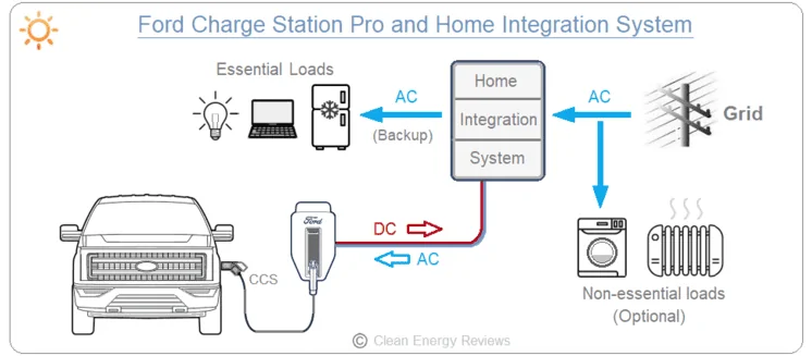

Ford F-150 Lightning Distribution of 80-AMP Ford Charge Station Pro (Home Charging Station) 1651228210778
I see the main advantages of the HIS vs. a transfer switch are:
  1. Additional input line to backfeed home not needed with HIS setup.
  2. Automatic switching to vehicle power during an outage, no need to plug in an additional cable.
  3. 9.6kw vs. 7.2kw output
  4. (Maybe) less complicated wiring?
  5. Non-essential loads can be dynamically selected from the entire panel during an outage vs. statically chosen during the installation of a transfer switch.
With the onboard inverter providing up to 7.2kw via a 240v 30A output, Ford seems to be competing with themselves. If the price were not so high I would consider the HIS, but it's a pretty penny. I think the materials for a second 30A line and a transfer switch will be under $1k.

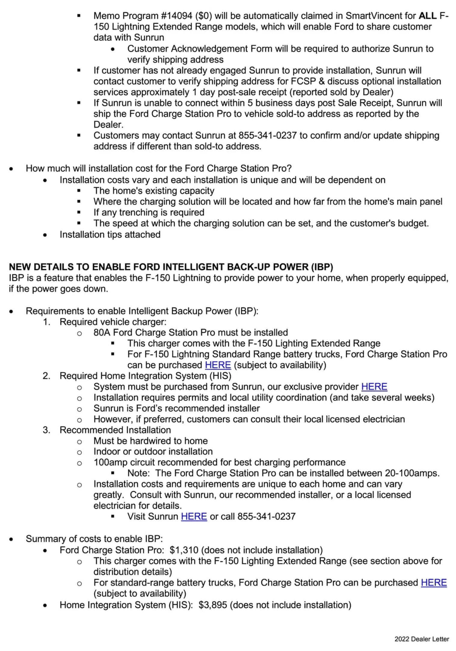

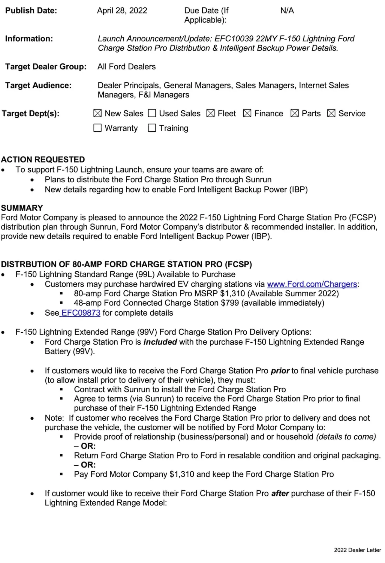

Here's the memo from Ford to dealers on the HIS and IBP.
$4K for the HIS and not including installation - does it include an inverter & transfer ?
Ford F-150 Lightning Distribution of 80-AMP Ford Charge Station Pro (Home Charging Station) Screen Shot 2022-04-29 at 7.40.58 AM
Ford F-150 Lightning Distribution of 80-AMP Ford Charge Station Pro (Home Charging Station) Screen Shot 2022-04-29 at 7.41.09 AM
So how do we receive the fcsp WITH truck purchase (instructions are present for before and after vehicle delivery)? Ford says it's included with purchase...If it isn't in the truck it doesn't seem very included.

Yes, the HIS is essentially an inverter, transfer switch, and associated control system in one unit.
