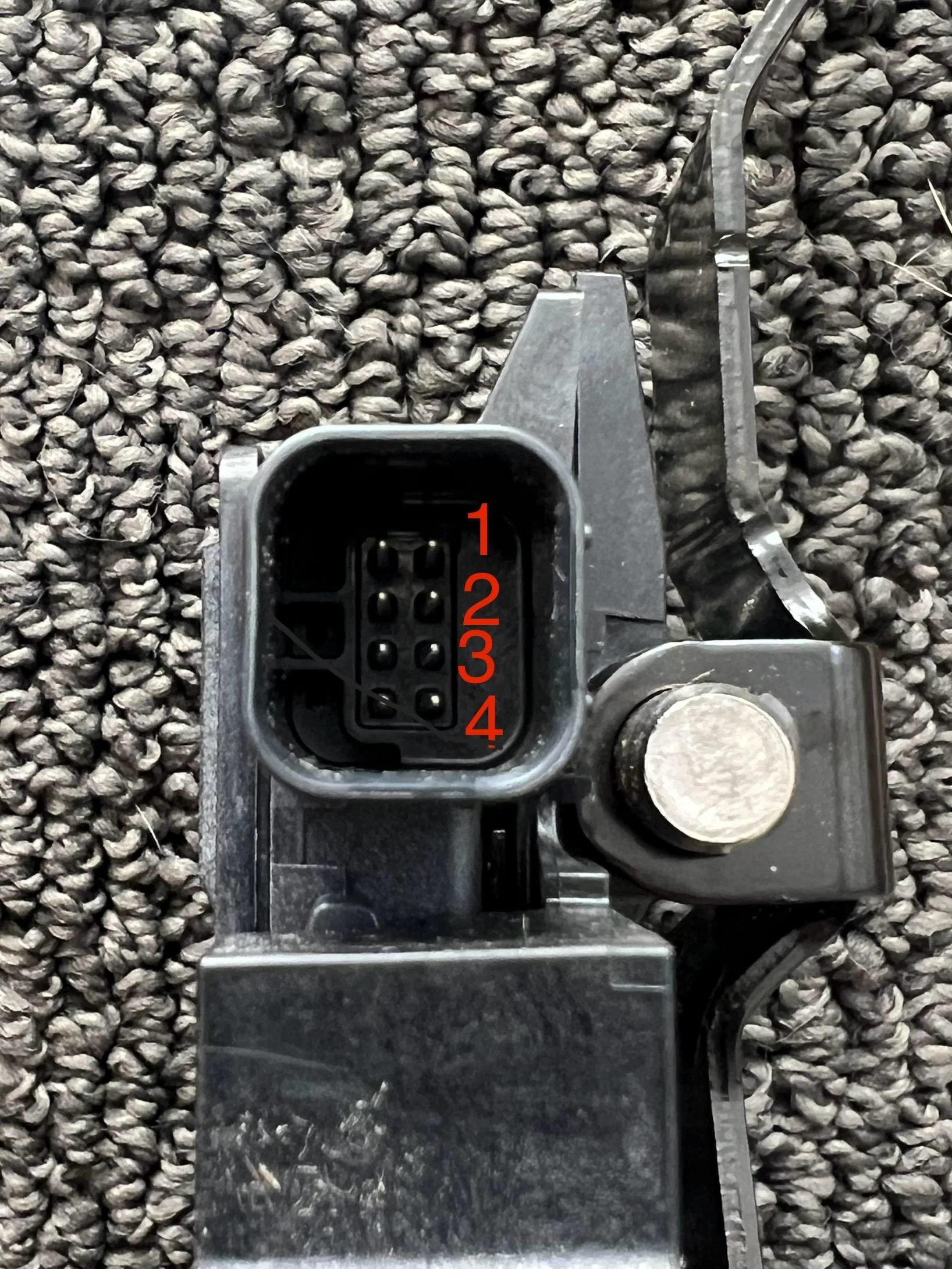

Now looking at the plug on the CCM, do I have the orientation correct? The pigtail shows wires 1, 2, 3, and 4 being plugged into where I indicated in the photo. Does that look correct?
Yea, that looks correct. Remember polarity on the CAN pins also matters.

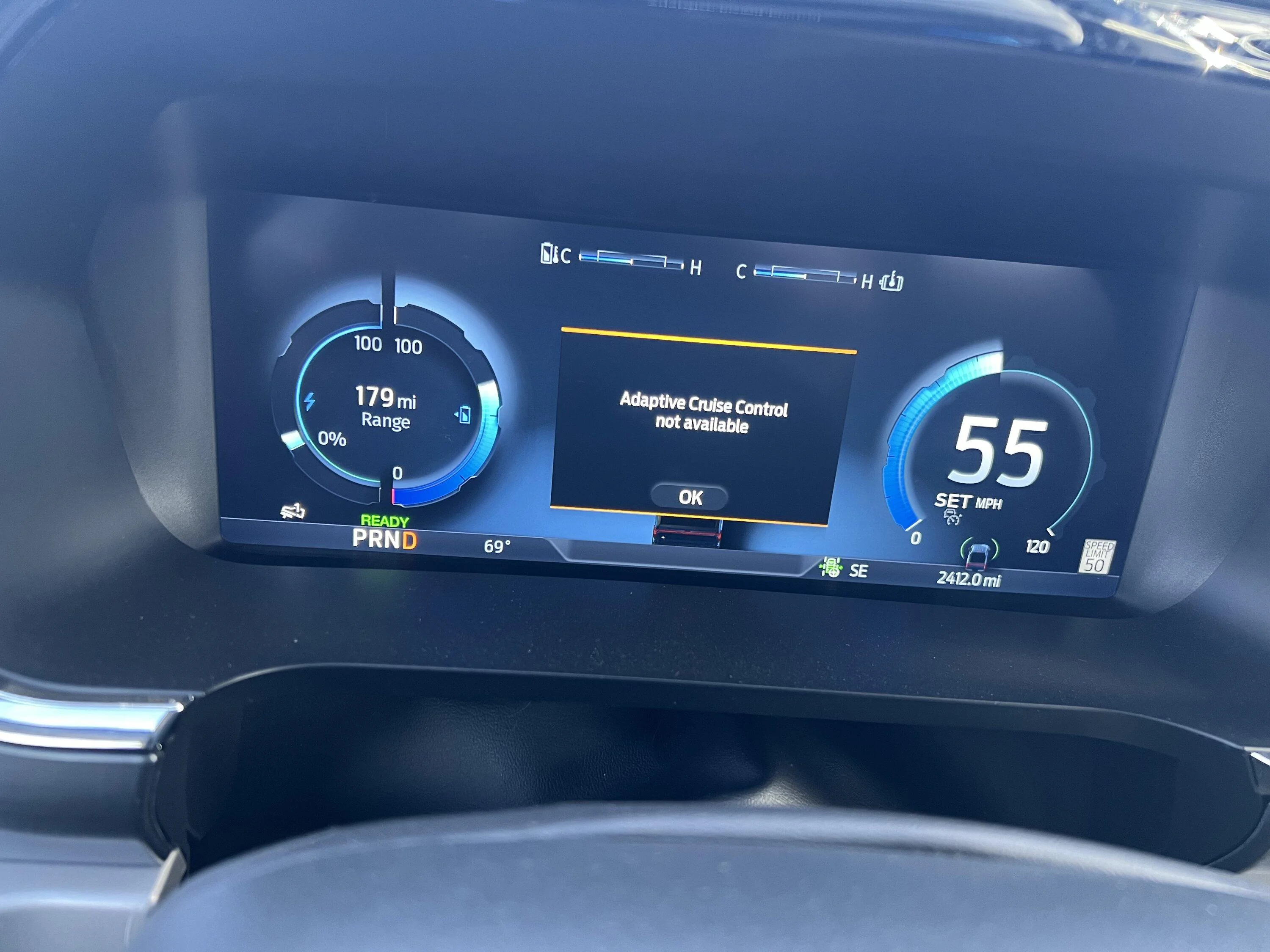

I’m so close I can taste it! But I keep getting this error.
Hopefully you'll figure it out soon 🤞. Did you get the CCM to show up on FORscan?

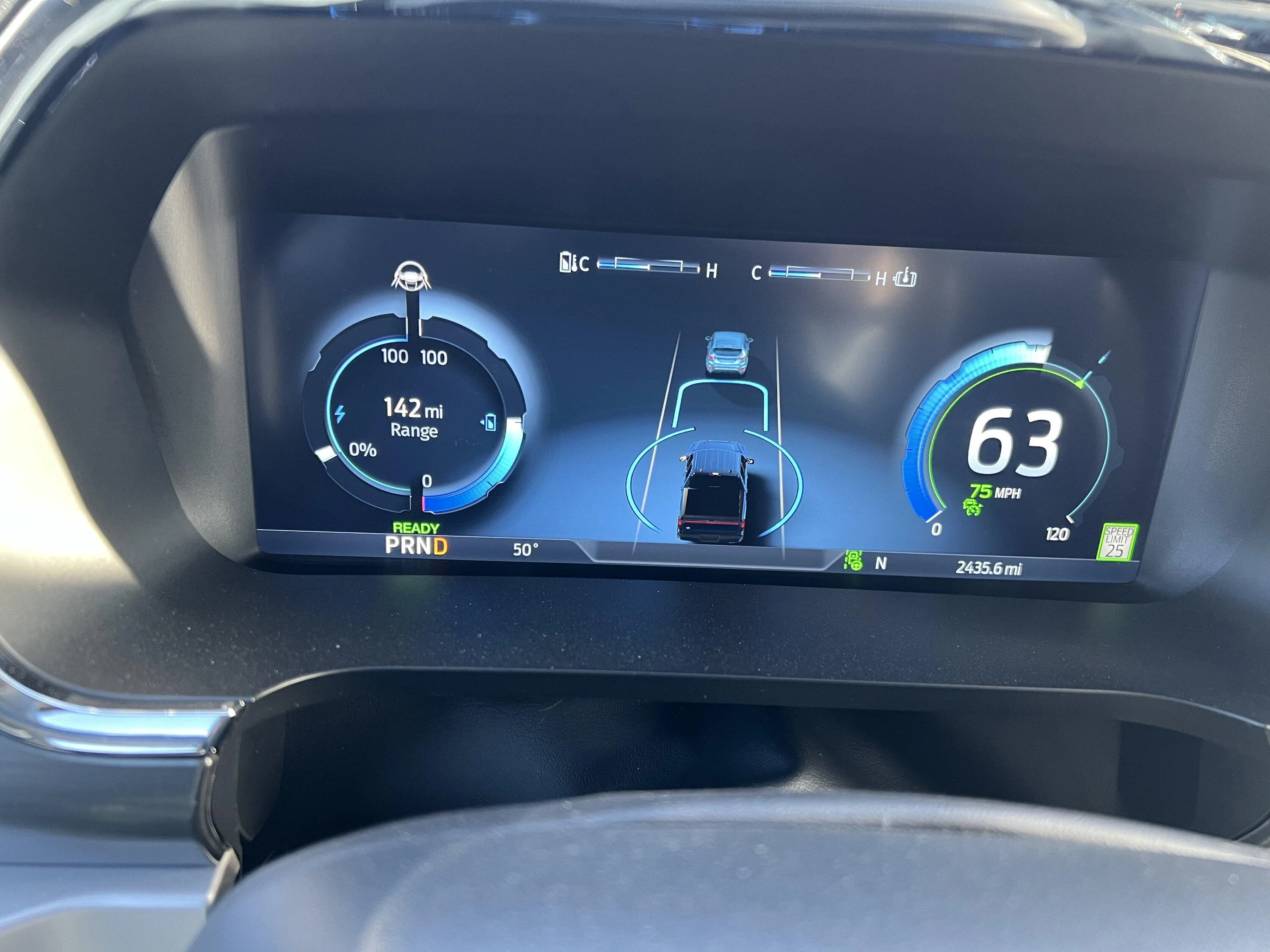

It works! 2023 Pro ER with Max Tow. Ran wires directly from the IPMA to the CCM. Also, a water bottle wedged in the steering wheel will work instead of a hand on the wheel for any curious minds.

Awesome, I'm working on an easy software solution to eliminate hands on the wheel, but retain the existing OEM audio/visual assist cancellation warnings. I'll post info as soon as I figure it out.
I see you still have the old IPC firmware showing the speed limit in the bottom right. I'll be curious to know if you see any issues when you get OTA 6.8.0. Thanks to FMC we'll never know really what all changed, but I had some weird warning messages in my IPC the first few days after. They went away on their own before I could get out FORScan and look at anything or document it. You'll definitely notice the differences in your IPC graphics when it happens, report back and let us know if it was perfectly seamless.

Great… idk if I want updates that mess with things lol. But I’m blown away that this is like a poor man’s auto pilot. It literally does all the turning through curves and everything. It’s so bizarre.
