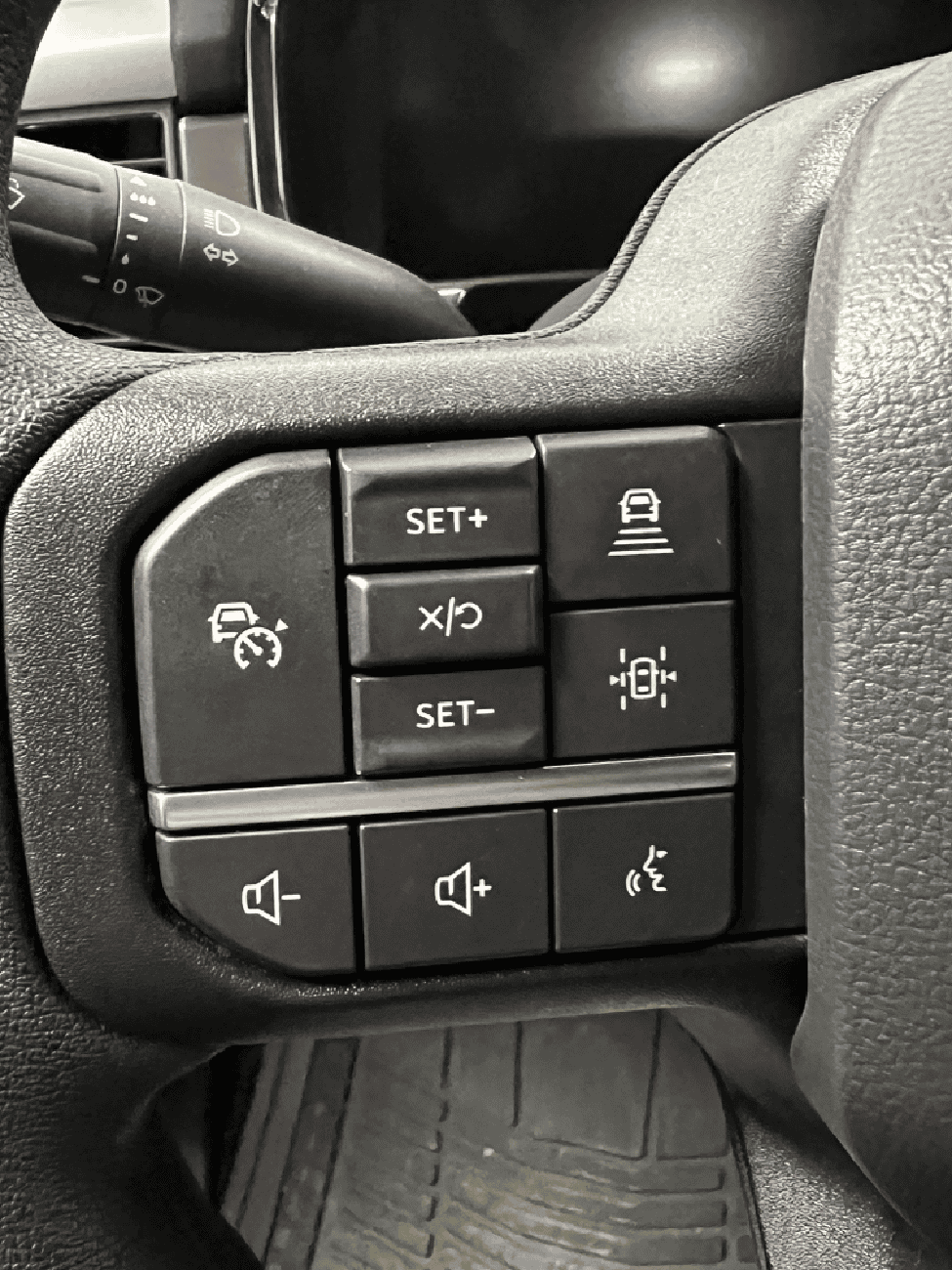

Added the switch. Bought it off eBay, from China, plugged it in, changed the value in forscan and it works great! Previously it was locked in at the 3rd distance and and now there’s 4 different distances to choose from. This whole mod of adding the ACC and everything with it has been awesome. 10/10 would do it again.
So you just bought the two small buttons to replace the original Lane-keep button? What did you look for on eBay?
I'm also curious, once this is all working, can you still have regular cruise control, or is ACC the only option? And can you enable lane centering independently of ACC?
Thanks! I have most of my parts in. Plan to do this the week after next!
I bought the whole left side button cluster. Just plug it in and edit forscan. PN: ML3T-9E740-DCW
You can have regular cruise but you have to shut it off on your center screen I THINK. I haven’t found another way.
I don’t know about the lane centering being independent. I have a 150mi round trip tomorrow, I’ll tinker with it.
