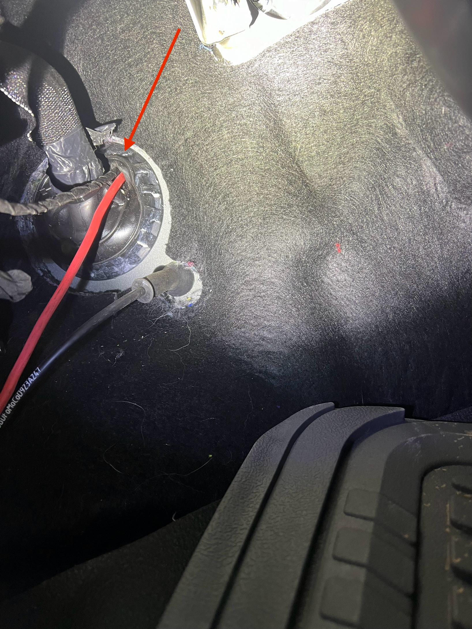

Here’s a photo of the grommet. The arrow points to the CCM wires. The red wire is power for my 2 way radio.

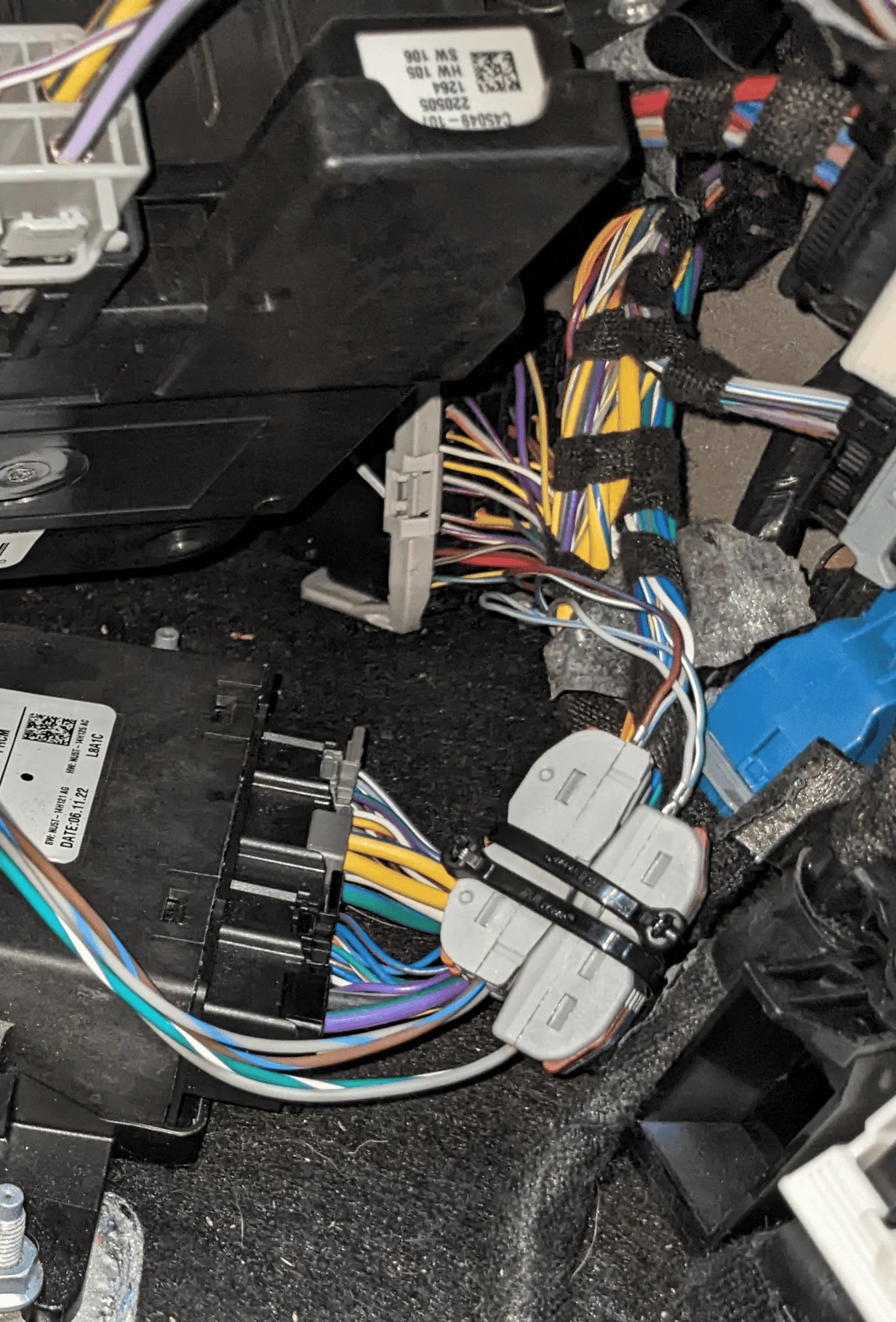

I’ve got a couple questions before I dive in any further.
I have the 4 wires needed coming out of the IPMA, but I can’t for the life of me tell if I have them at the passenger kick panel connector. When looking at the connector from this angle, are these the wires coming from the IPMA or going to the bumper?
Ford F-150 Lightning DIY: Installing ACC (Adaptive Cruise Control) and LKA (Lane Keep Alert) to 2022 F-150 Lightning XLT IMG_6119
If I don’t have the wiring already at the front bumper, it almost seems easier to go directly to the IPMA and skip the other connectors, no? The connector under the passenger side looks like a PITA to get to. Is there any reason not to just remove the and replace the 4 pins in the IPMA connector?

I would imagine going straight to the IPMA should work just fine. You could just splice into the existing wires rather than removing and replacing the pins.

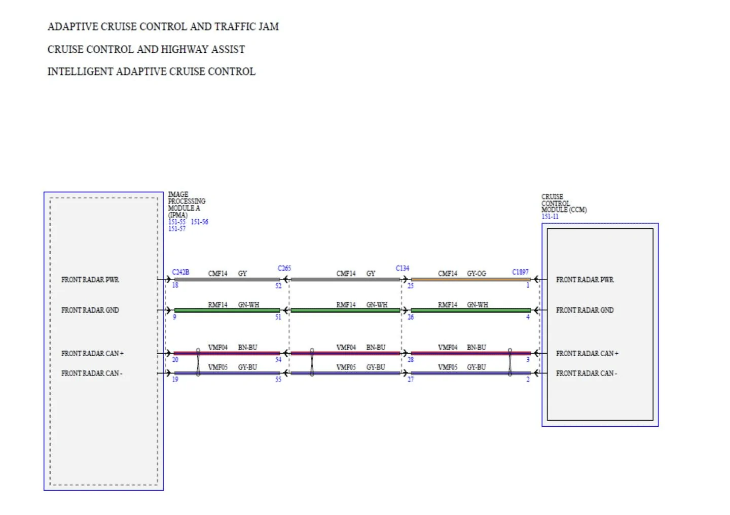

All of those wires going down go to the IMPA. Be careful unplugging that connector latch. You need three hands to do it ???. Here is mine after I pulled the 4 pins out.
Left them factory and stuck them right into WAGO splices.
Ford F-150 Lightning DIY: Installing ACC (Adaptive Cruise Control) and LKA (Lane Keep Alert) to 2022 F-150 Lightning XLT 1708901022015
Yes, it may be easier to go straight from the IMPA, but if you are a stickler about leaving your truck factory to the highest degree possible, then use as much of the factory wiring as possible.

To the point of using a borescope, you might as well just unmate that connector and look at the pin locations in the one heading up from the bottom, you will be able to see easily if the male pins exist or not in the right spots. The front bumper side of C265 is the male side.
