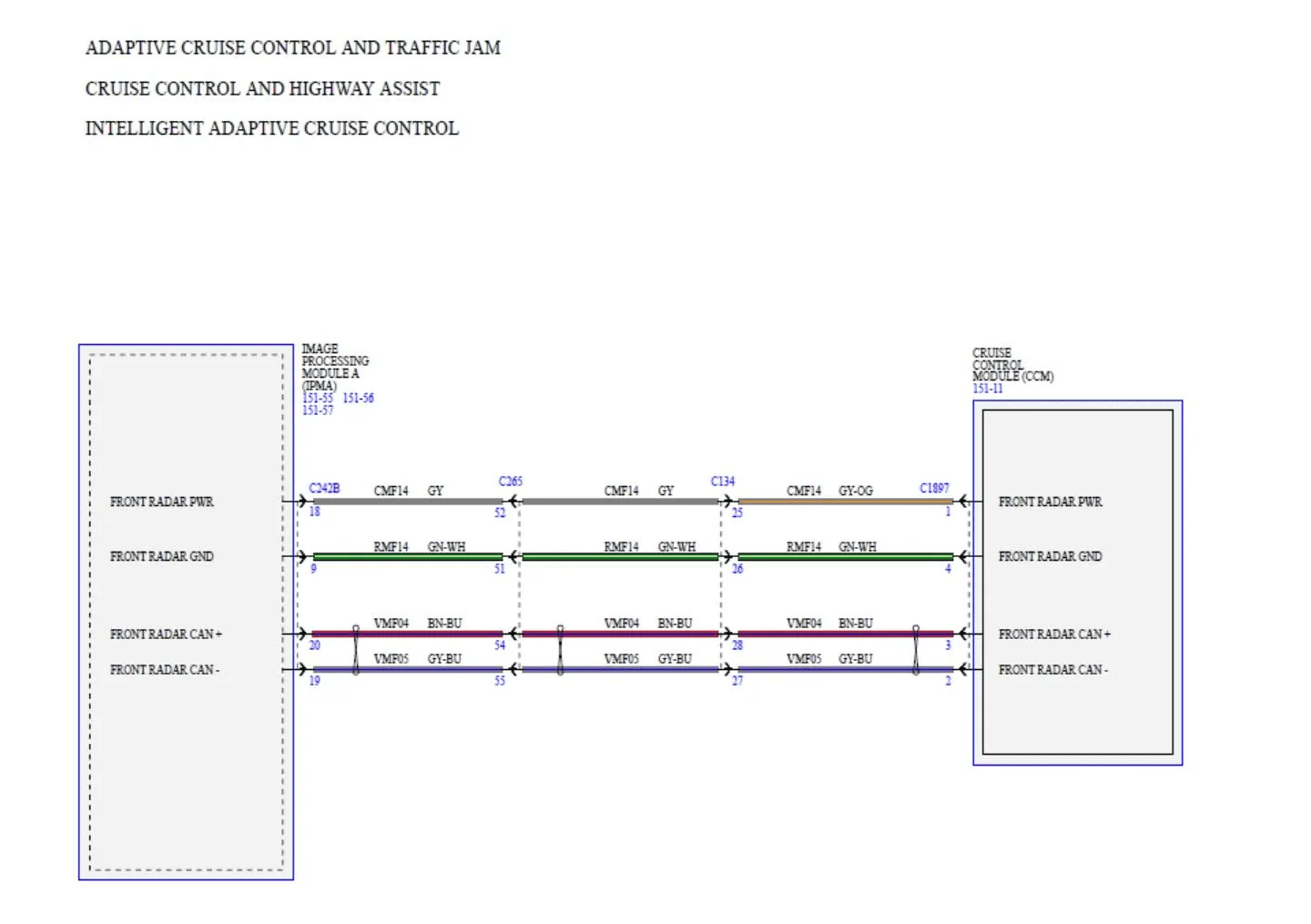

@steveje and I have been working on this and I finally got it working last night.
As I mentioned earlier we both discovered we were missing the wiring between C134 (Main Front Bumper Level Lock Connector) and C265 (Passenger Kickpanel 50+pin Lever Lock Connector)

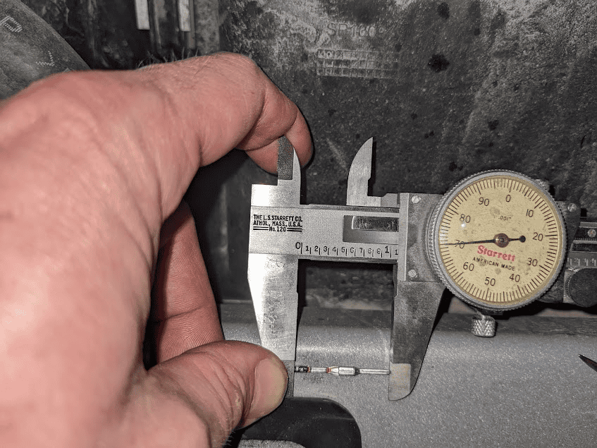

So since I'd already installed the bumper harness, I decided to go full OCD on the missing piece and match the factory wiring color scheme and maintain the IP rating and connectivity of C134.
Here are the pins I ordered:
https://www.digikey.com/en/products/detail/molex/0194170028/3183227
Here is the wire I ordered:
https://4rcustomswire.com/products/20-gauge-txl-wire-6-striped-colors-each-25-foot-long

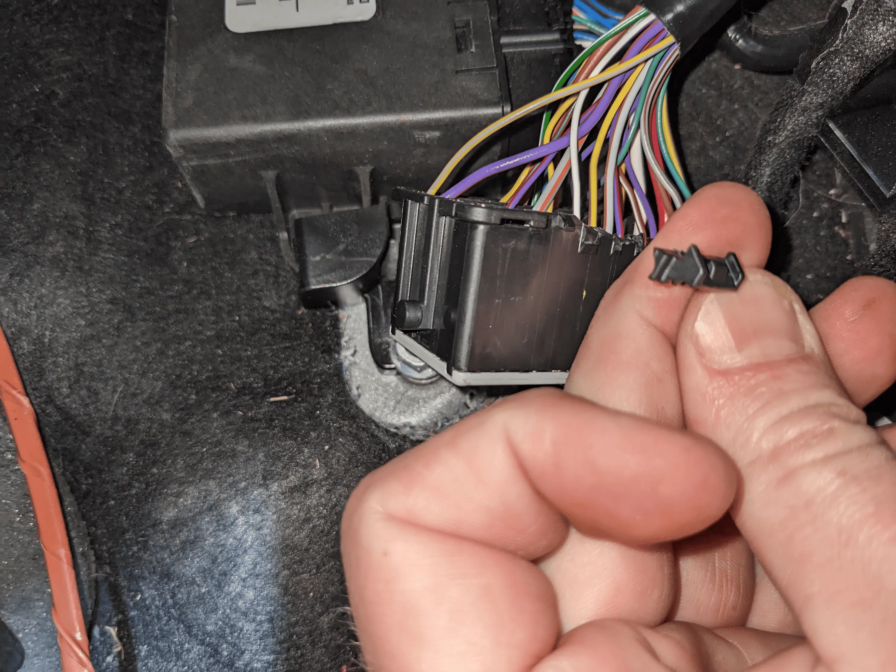

I did all this post bumper off work. Once the backup/PAWS speaker is removed you can easily get to C134 with one hand and work the lever to unhook it and bring it into the frunk bay for pin work. For the backup/PAWS speaker removal I've been using a 1000Ohm resistor since the week I got the truck, but after removing it during this job and discovering that it's just a 4Ohm speaker I discovered you can replace it with a Ford Injector and get the IP rating of the connector back :)

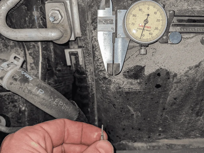

So, here is a video of how to add the pins to C134:
https://photos.app.goo.gl/CCwe7fXHhBoCezgz7

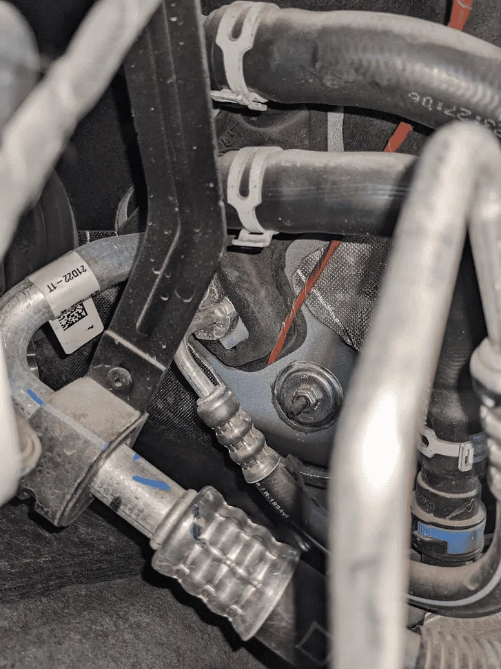

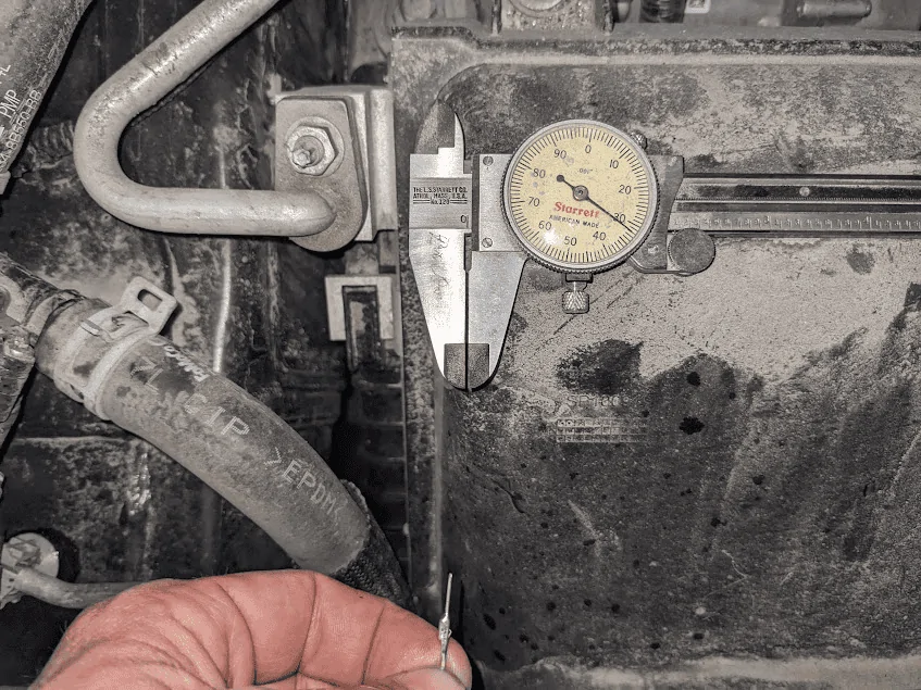

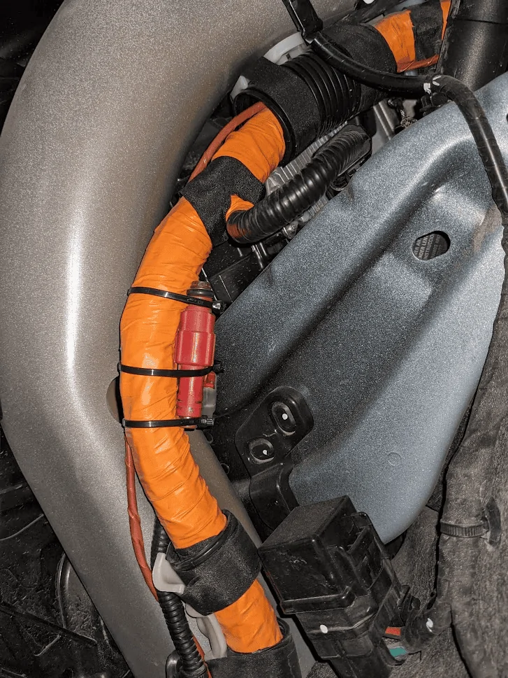

Here is where I went through the firewall:
Ford F-150 Lightning DIY: Installing ACC (Adaptive Cruise Control) and LKA (Lane Keep Alert) to 2022 F-150 Lightning XLT 1680969426744

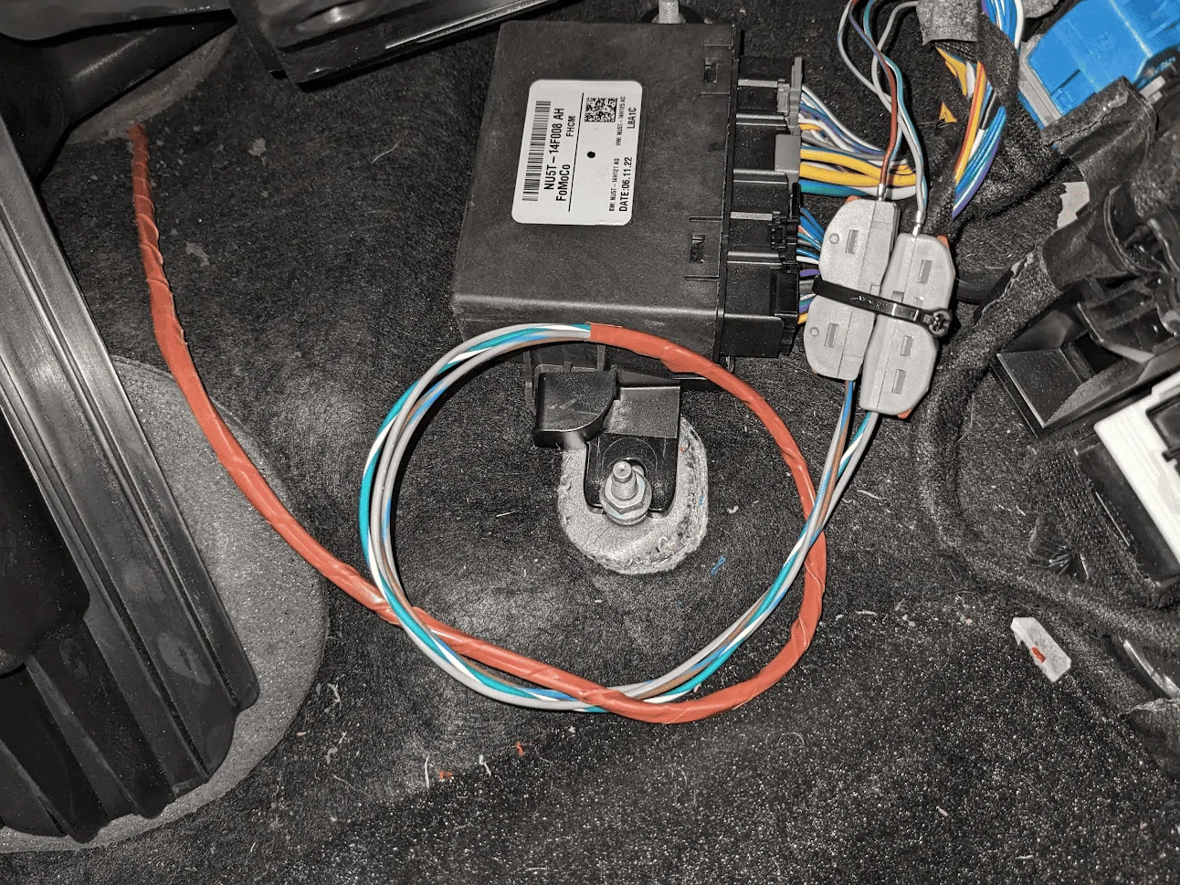

And here is the final splice to the factory pins I extracted from C265:
Ford F-150 Lightning DIY: Installing ACC (Adaptive Cruise Control) and LKA (Lane Keep Alert) to 2022 F-150 Lightning XLT 1680969497247
If you're following Jason's original post just know that you will not receive power to the CCM until you execute the IMPA changes as that module supplies power directly to the CCM. You can basically execute all module changes except the VIN -> CCM, then you can rediscover and find the module.

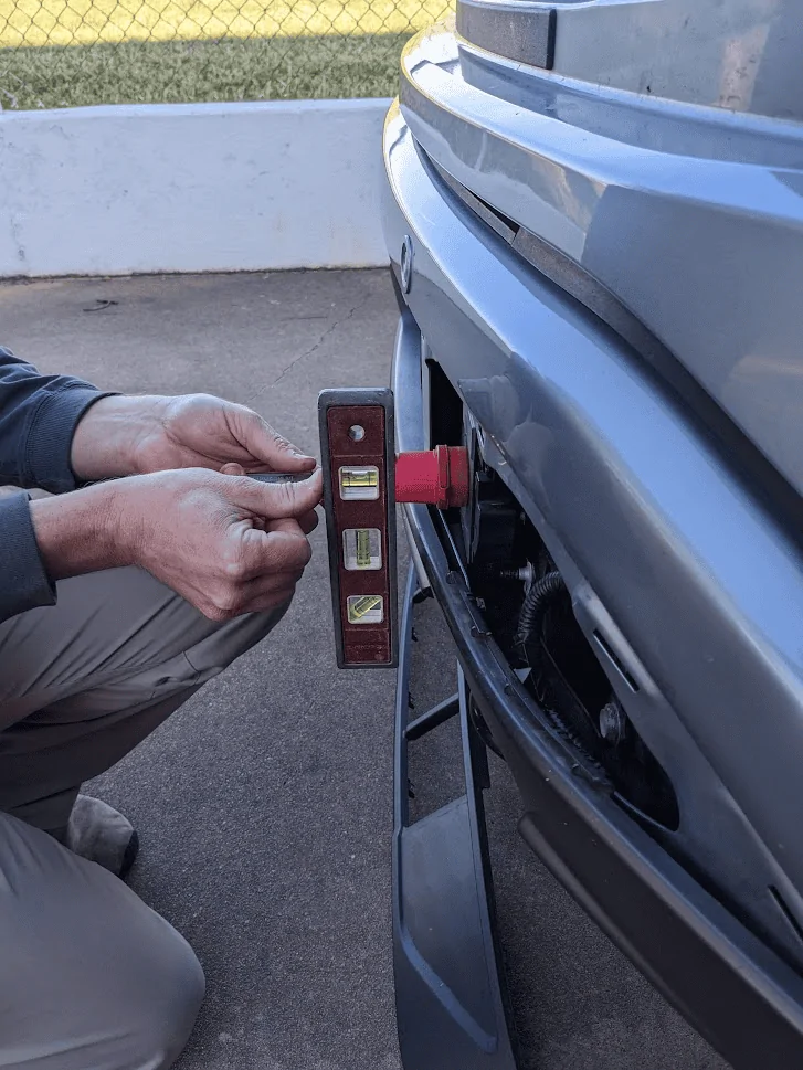

Also, make sure you don't forget to level the vertical of the CCM:
Ford F-150 Lightning DIY: Installing ACC (Adaptive Cruise Control) and LKA (Lane Keep Alert) to 2022 F-150 Lightning XLT 1680969705803
and clear all DTCs before attempting to calibrate the horizontal in FORScan.

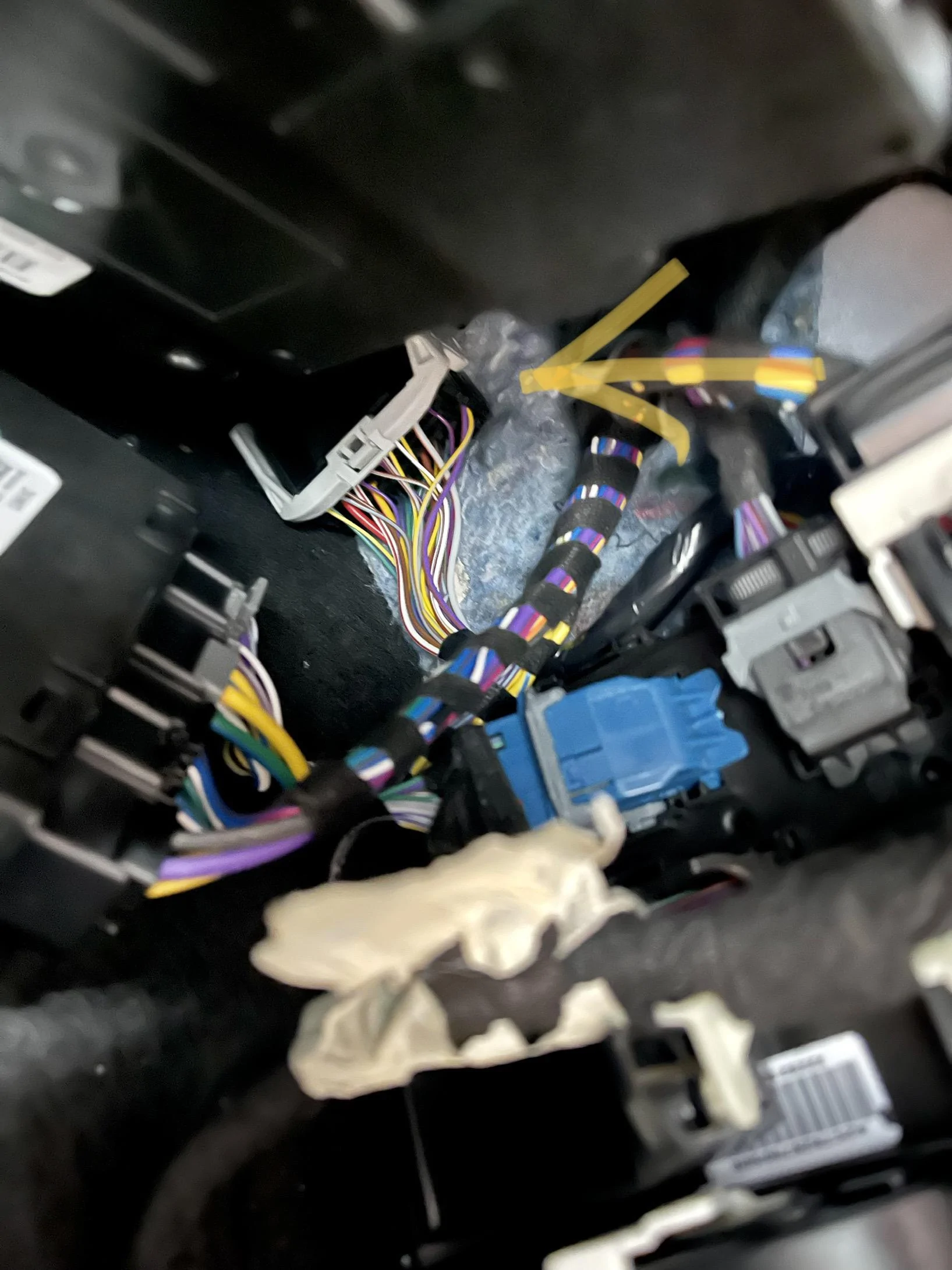

FantastIc work Zach. I have a 23 Pro with tow tech package and have been working with Brotato on getting ACC in my truck. For some reason his 22 XLT 310 package had the correct wiring. We have installed all of the hardware but like most others, we are missing these four wires in my install. Thank you for the video. That is super helpful.
I dug into my passenger side kick panel and want to ensure I am looking at the correct C265 connector. I have attached a photo for confirmation. So you just removed the pins from the connector and directly spliced into them? How difficult was it to remove those pins from C265? Doesn't appear there is a lot of space in there for my hands.
I have ordered wires and pins and hope to have success in the next couple of weeks. Thanks again for all of your help with this.

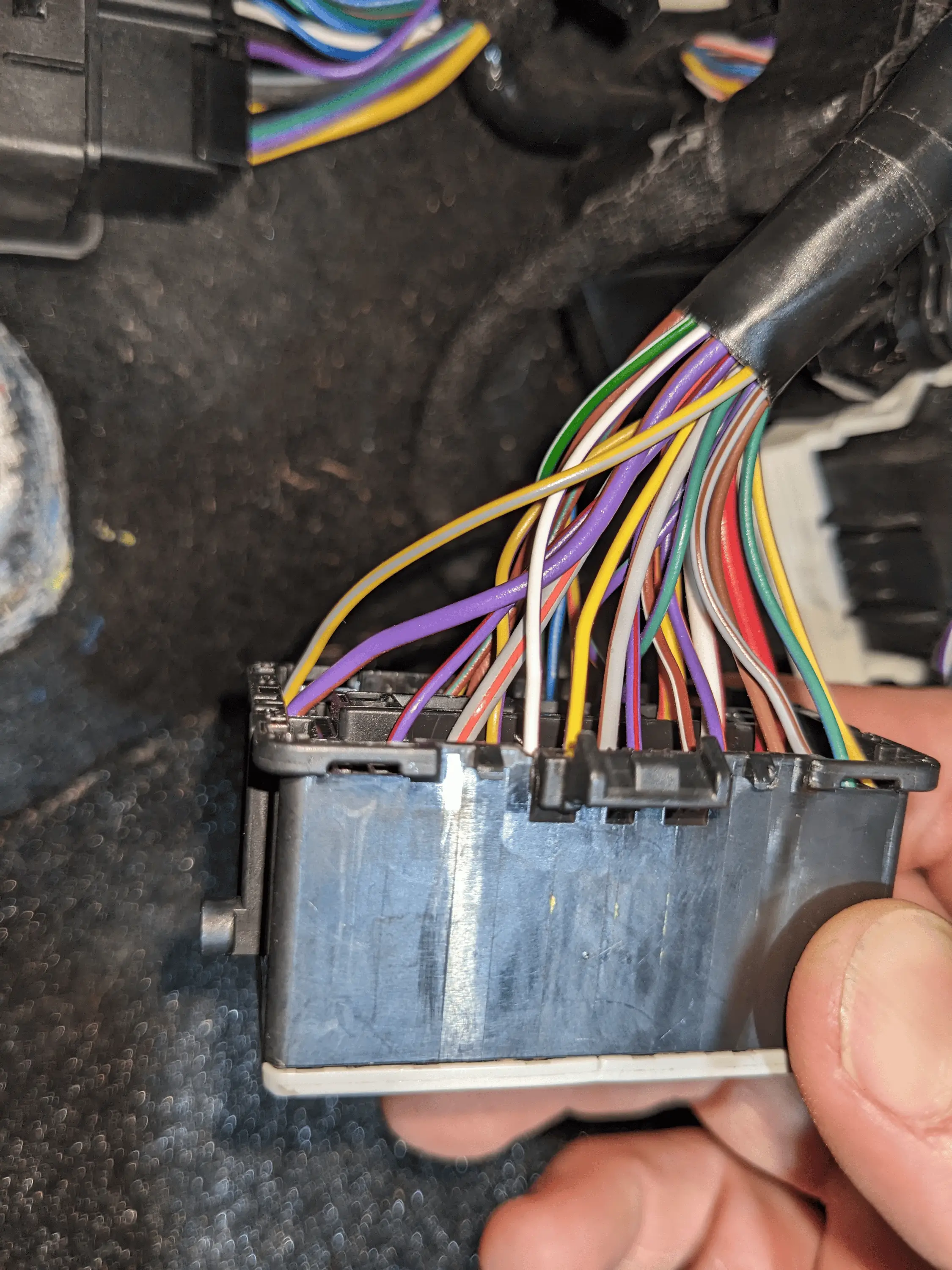

I don't think we will ever understand the rhyme or reason as to why some wires exist when they are not needed and some are left out. With all the supply chain problems I imagine sometimes to keep the production line running they will use a harness piece of a higher package on a vehicle if the correct one is for some reason not available at that very moment.

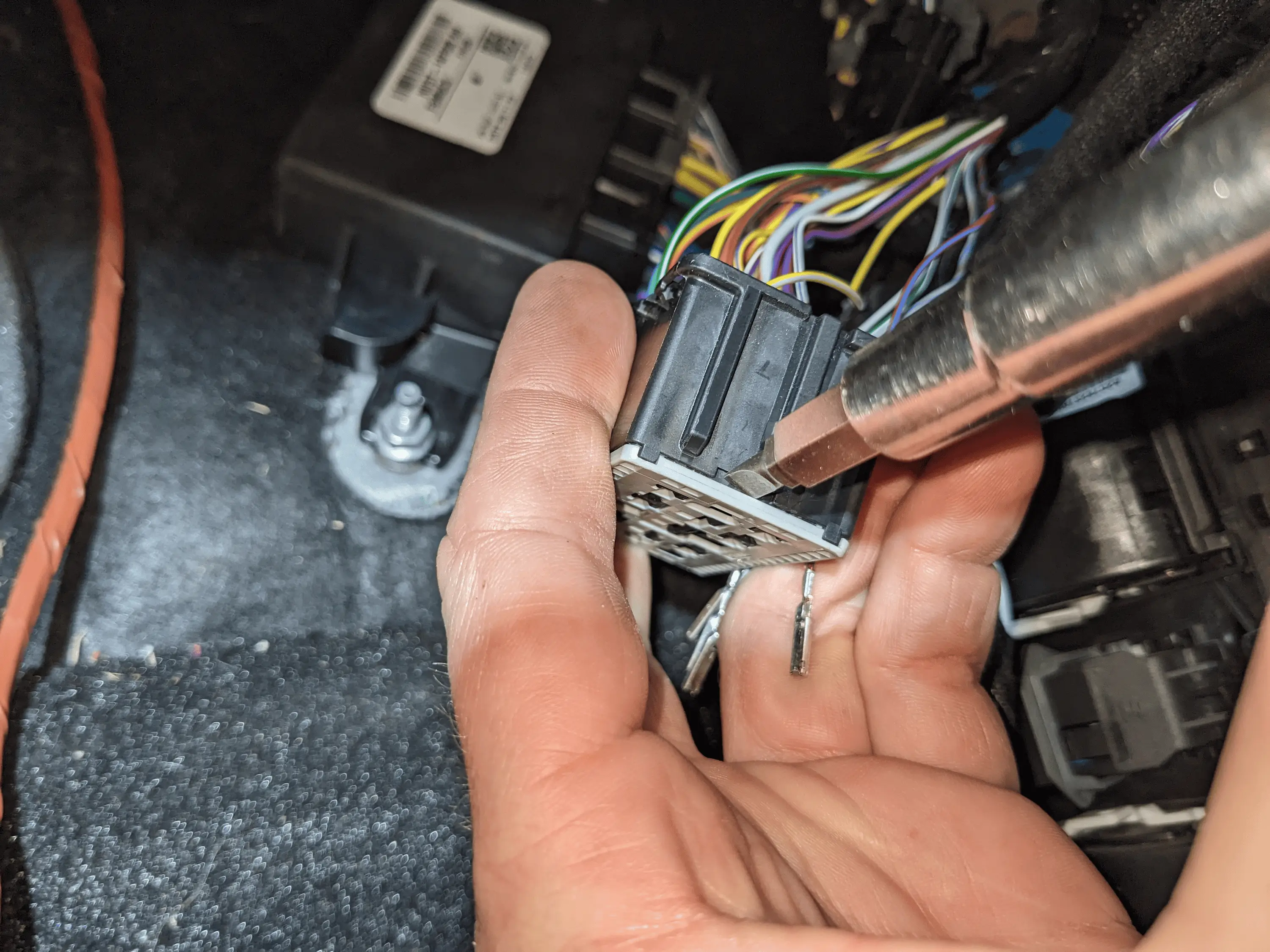

Correct, that is C265, both Steve and I reached in there with one hand and a pry tool to pry the lever open and broke a small piece of the connecter when prying it open. I could tell there was some kind of clip, but with the limited space and only one hand we both resorted to a pry tool. I'm still not 100% sure how to unclip the lever, I tried many things with one hand, but I did take a few good pics.
Ford F-150 Lightning DIY: Installing ACC (Adaptive Cruise Control) and LKA (Lane Keep Alert) to 2022 F-150 Lightning XLT 1681017945534
Here is what it would look like if it was not broken off. I simply set it back into place to take this picture
Ford F-150 Lightning DIY: Installing ACC (Adaptive Cruise Control) and LKA (Lane Keep Alert) to 2022 F-150 Lightning XLT 1681018109449
Once you get this female end released you can pull it out and bring it down to have just enough room to work on it. You pry and release the retainer like this
Ford F-150 Lightning DIY: Installing ACC (Adaptive Cruise Control) and LKA (Lane Keep Alert) to 2022 F-150 Lightning XLT 1681018270260

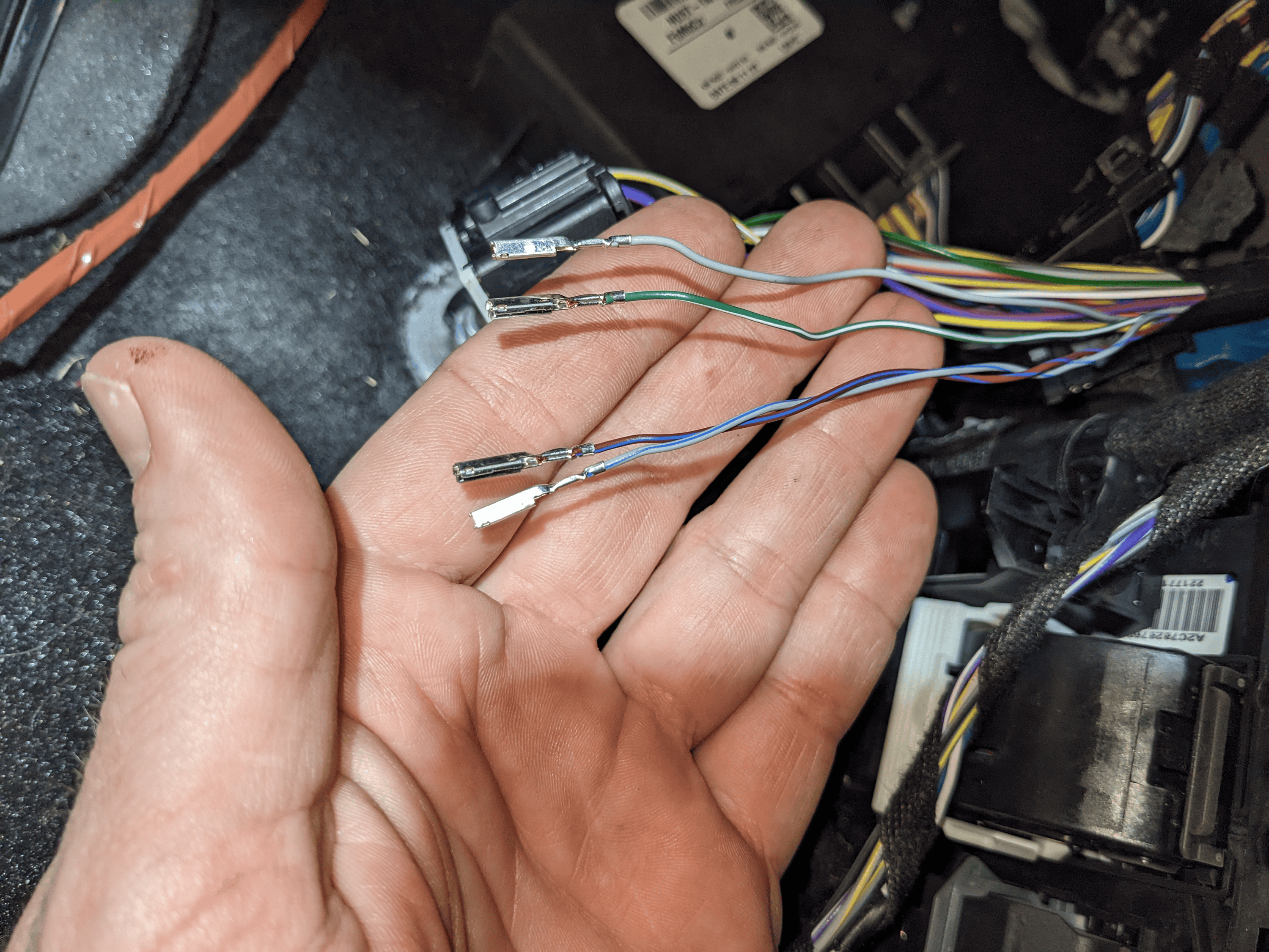

Once you have the retainer out you remove the pins with a pic in a very similar fashion to C134.
I left the factory female pins crimped on and simply inserted them into WAGO in-line Lever-Nuts
Ford F-150 Lightning DIY: Installing ACC (Adaptive Cruise Control) and LKA (Lane Keep Alert) to 2022 F-150 Lightning XLT 1681018474751

During the calibration, I got an error on the dash saying “front sensor not aligned”. The error stayed on the dash during the entire calibration. Once calibration completed, the error went away. Just making note of this because I was worried about my sensor being misaligned.
Other than that, the original guide, plus the additional 4 wires from the bumper harness to the C265 harness got me working.
