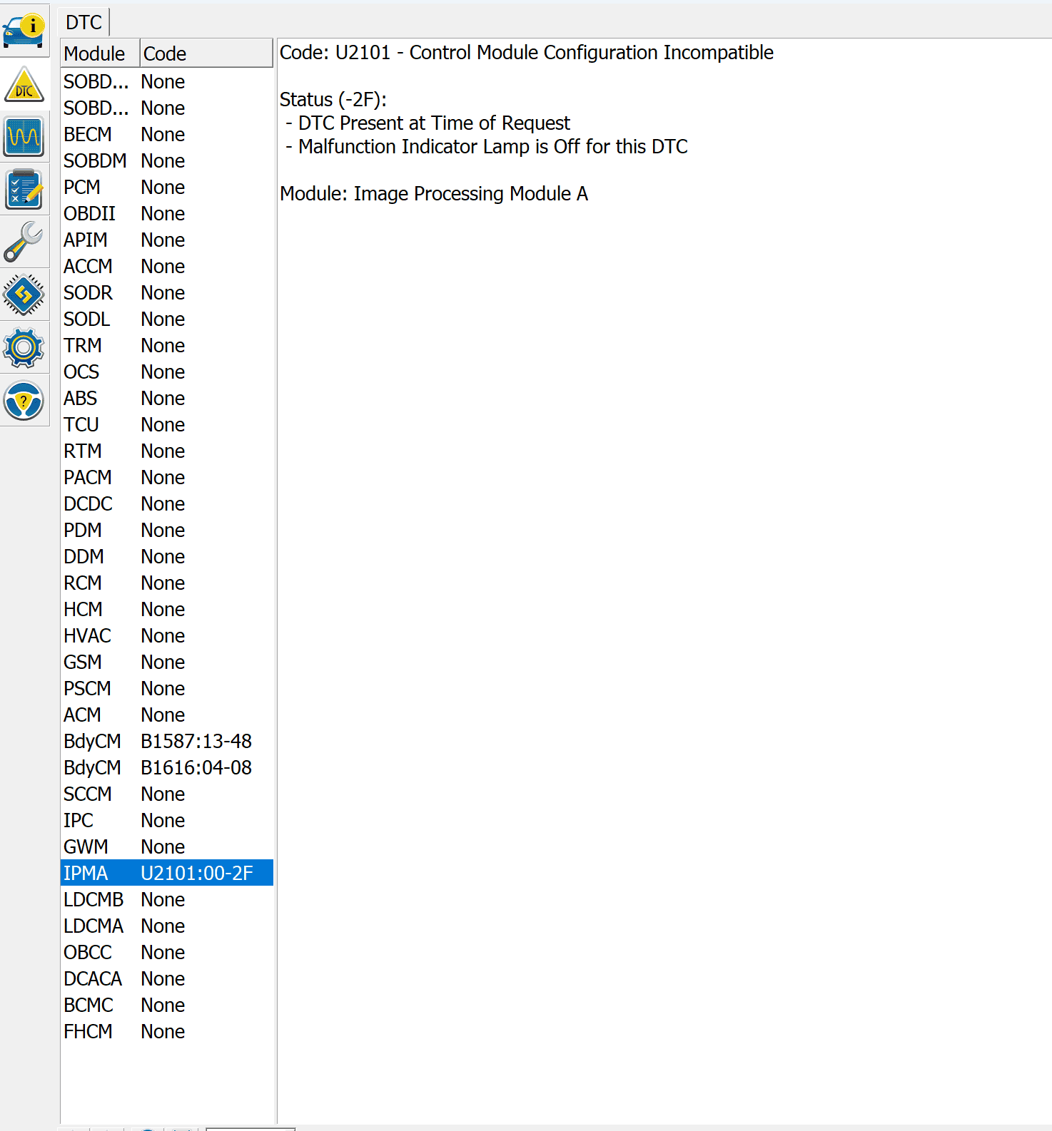

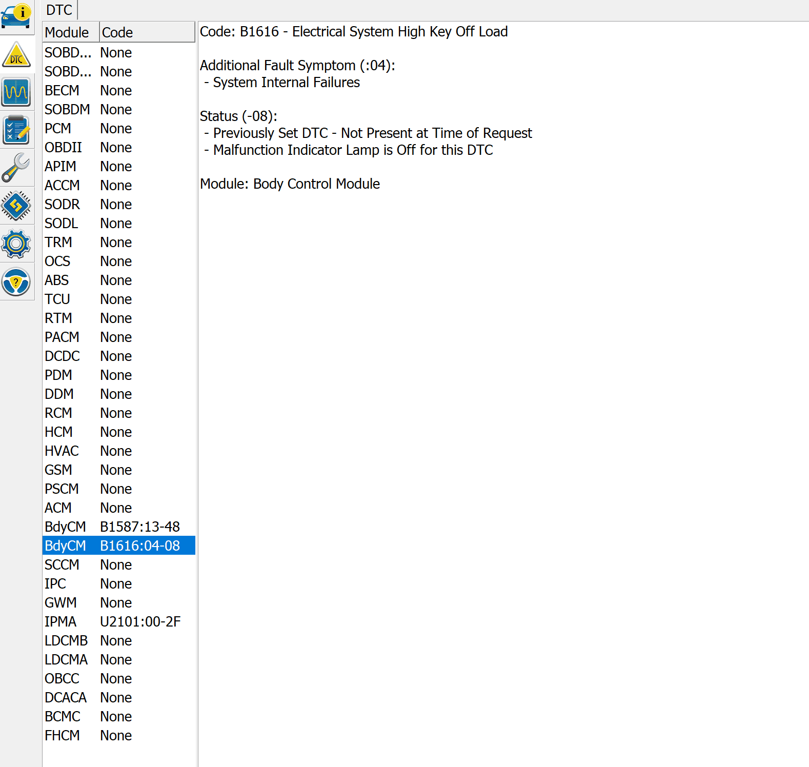

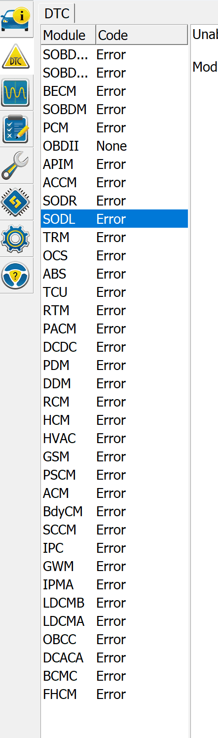

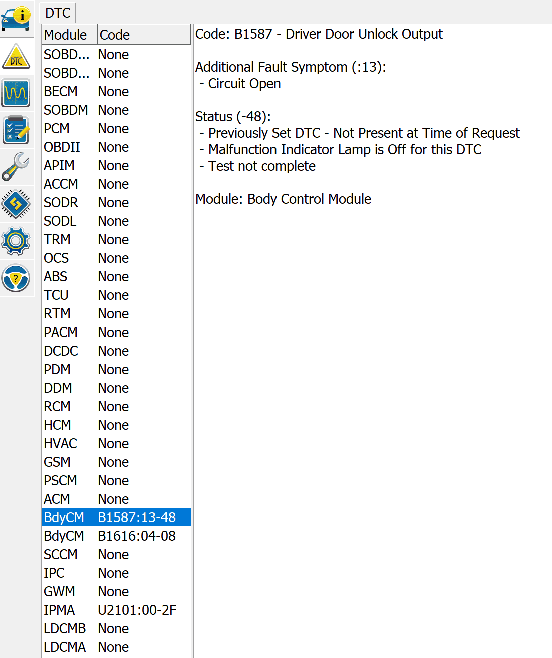

Another issue. I disconnected FORScan after playing around and plugged it back in. I suddenly got a bunch of errors. All of the modules in fact showed DTCs.
I disconnected and reconnected and when I did I did not select my first vehicle save, instead letting it rescan everything. This time, there were not DTCs everywhere-just three of them.
It says BdyCM B1587:13-48 Driver Door Unlock Output, BdyCM B1616:04-08 Code B1616 - Electrical System High Key Off Load, IPMA U2101:00-2F Code U2101 Control Module Configuration Incompatible.
Did I mess things up? Here are a couple screenshots. I'm going to stop until I hear back. Maybe I got too adventurous in testing it. Note-I did open the Module Firmware Update configuration to play by clicking download and test, but I never clicked program. I dont know if that messed some of this up or if it was my earlier changes or what.
Ford F-150 Lightning DIY: Installing Passive Entry To A 2022 F-150 Lightning XLT Screenshot 2023-07-17 at 3.26.37 PM
Ford F-150 Lightning DIY: Installing Passive Entry To A 2022 F-150 Lightning XLT Screenshot 2023-07-17 at 3.27.24 PM
Ford F-150 Lightning DIY: Installing Passive Entry To A 2022 F-150 Lightning XLT Screenshot 2023-07-17 at 3.31.57 PM
Ford F-150 Lightning DIY: Installing Passive Entry To A 2022 F-150 Lightning XLT Screenshot 2023-07-17 at 3.32.13 PM
Ford F-150 Lightning DIY: Installing Passive Entry To A 2022 F-150 Lightning XLT Screenshot 2023-07-17 at 3.32.24 PM
Thanks.
Not sure on all the errors, but the firmware files are ones that you would actually get from ZSC100. You really can't screw them up, but they're loaded one by one into the system. It's not like the other forscan changes that you'd make.

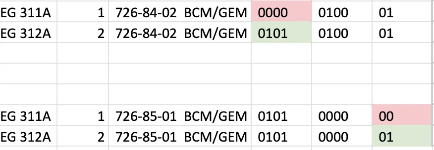

Change 1 was:
BdyCM 726-62-01 FROM: 0201 0050 00E3 TO: 0001 0050 00E3
Change 2 was:
IPMA 706-01-01 FROM 0E00 8015 0ABC TO: 0E00 8014 0ABC
That's all I did in FORScan with the "write" function.

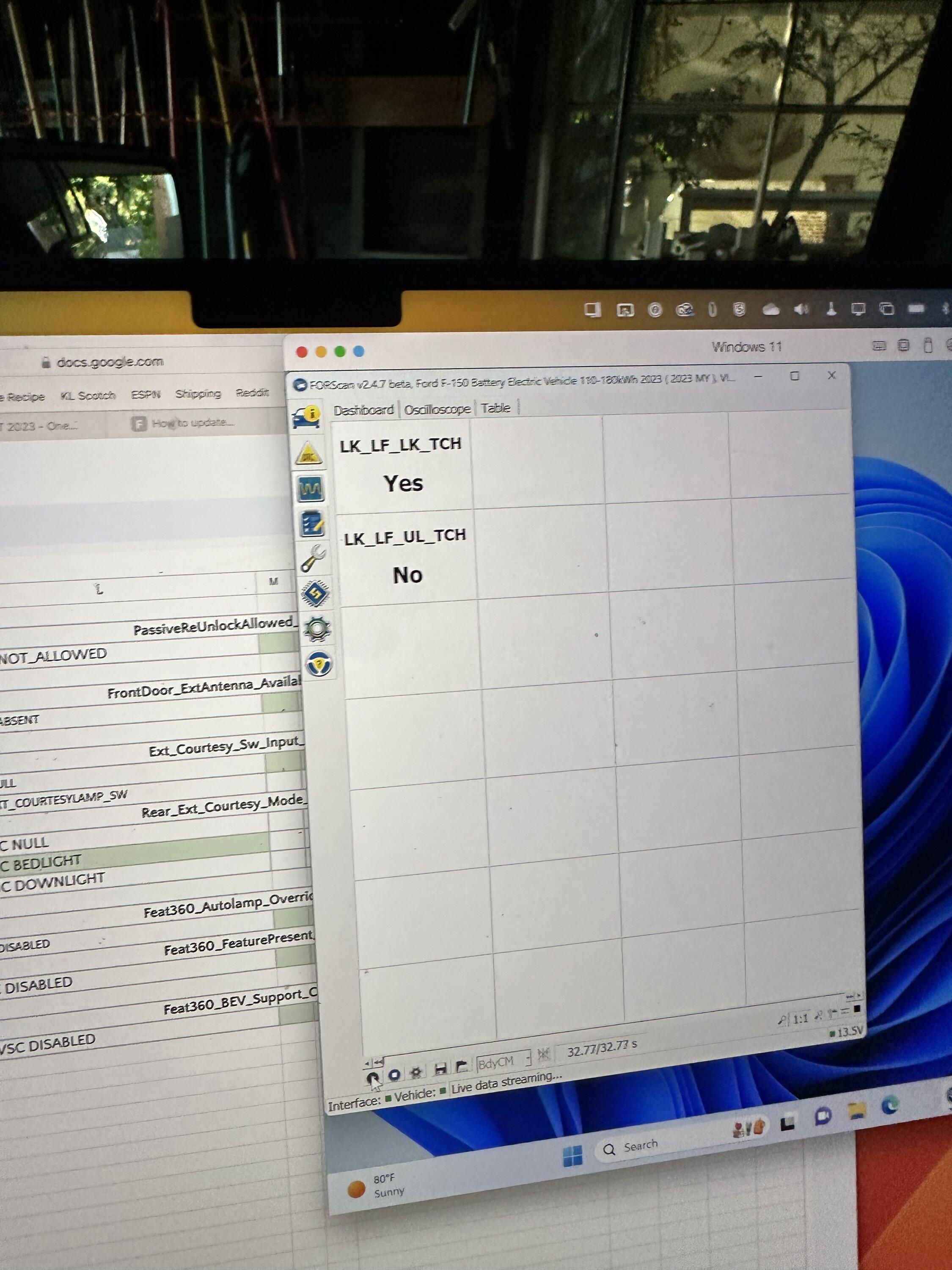

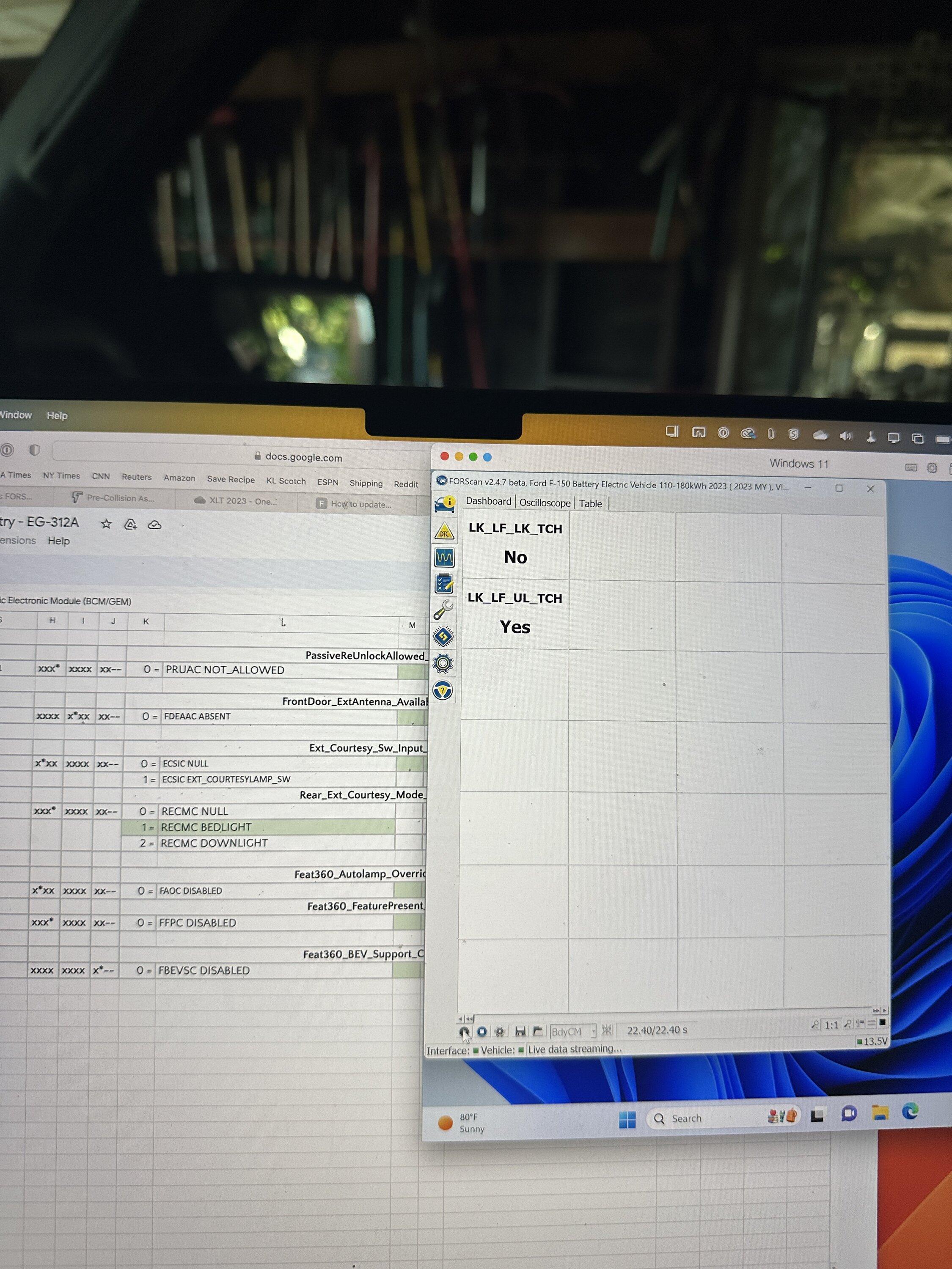

Final Update for today and hopefully last time I need your guys' help with this project lol. I have not felt like such a novice at anything in quite a while and can't express my gratitude enough to all you that have been helping.
First-I still have the Precollison Assist Unavailble warning on the dash, no drivers assistance and the DTC still shows up. No idea what thats about but it was not there before the project. I cleared the other DTCs from the BdyCM and they did not come back. I’m guessing that since it is in the IPSM module and I only changed one integer there for the annoying rear back up alert warning everytime that it must be related to that. Is it best to just change that number back to what it was or to reload the saved file completely?
Now, I have updated all of the BCM files from Zach's post here:
There were two I did not update-the final two. These were already in my Forscan as the green versions for some reason (2023 Pro)
Ford F-150 Lightning DIY: Installing Passive Entry To A 2022 F-150 Lightning XLT 1689644999995
I was then able to load the two modules (lk lf lk tch and ul) and test them in the dash board. They "worked" in that if I touched the button one would say yes, then if I waited a few seconds and touched again, the other would say yes. They did not respond if I held or touched over and over (which makes sense I suppose)

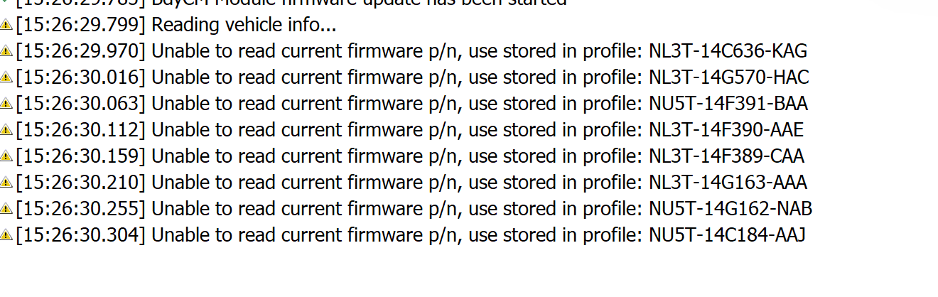

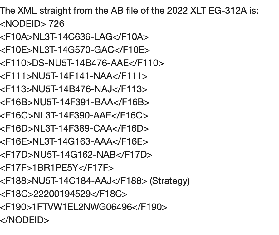

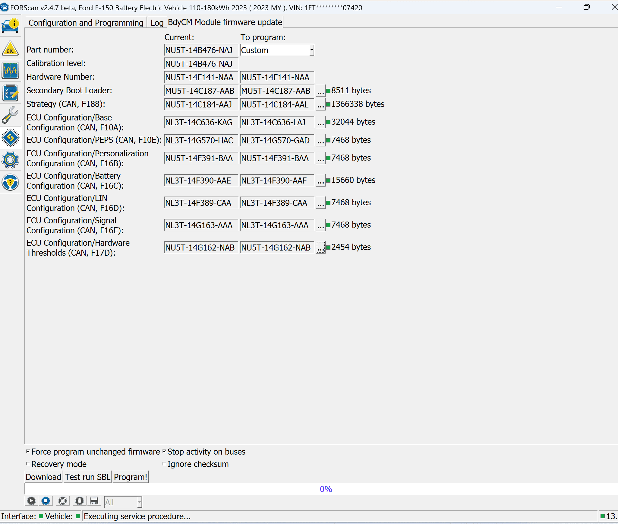

I then decided to see if I could figure out HOW to do the firmware upgrade without actually doing it. I got to this point and wanted to make sure that I am supposed to have it look like this and then press "program". Is that right? Is there anything else I am supposed to do first or after? Is that it? Here is what it looks like. I did not click any other buttons, just hit stop after selecting the files to make the screenshot.
Ford F-150 Lightning DIY: Installing Passive Entry To A 2022 F-150 Lightning XLT Screenshot 2023-07-17 at 6.45.40 PM

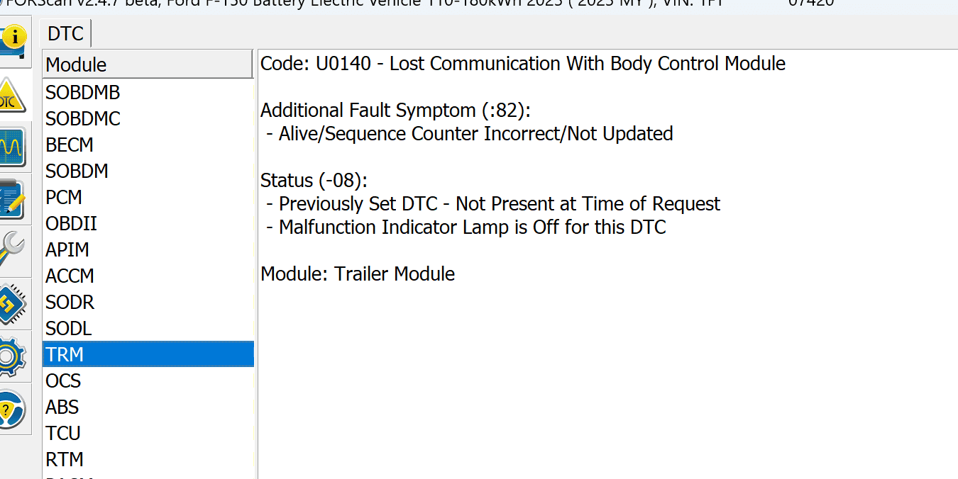

Finally, after doing all of the above I checked for DTCs again and lo and behold not only do I have the precollison one there but a new one now popped up for some sort of trailer thing. Would this have been related to a flag or integer I changed? What's weird is that it is in the TRM module and I did not do anything in the TRM module BUT it says "lost communication with body control module"
Ford F-150 Lightning DIY: Installing Passive Entry To A 2022 F-150 Lightning XLT Screenshot 2023-07-17 at 6.40.22 PM
So, where I'm at:
1. Need verification that all I do for the firmware is select the files in the manner I have above and then hit "program" and that my dashboard indicates the hardware is correct.
2. Assistance with the precollison issues
3. Assistance with the TRM issue-must have been something I did from the list of forscan changes for the door sensor, right?

1. Yup, that's all you need to do. Just make sure you're using a wired connection to your computer (at least that is what is recommended) and you have sufficient power on your laptop and truck. It's pretty much foolproof, you can't even select a wrong file. Forscan defaults to the one that you need to install.
2. I would revert back any changes that you made. If you know what your values were originally, just switch them back. If you saved your asbuilt values you can just reload those.
3. You'll get various errors and dtcs just from unplugging items. I'd just clear everything out once you're done and see if anything comes back. I get DTC's from time to time anyway, I'm assuming that anyone can (mine seem to come from the adaptive cruise control not being able to read speed limit signs every once in a while).
