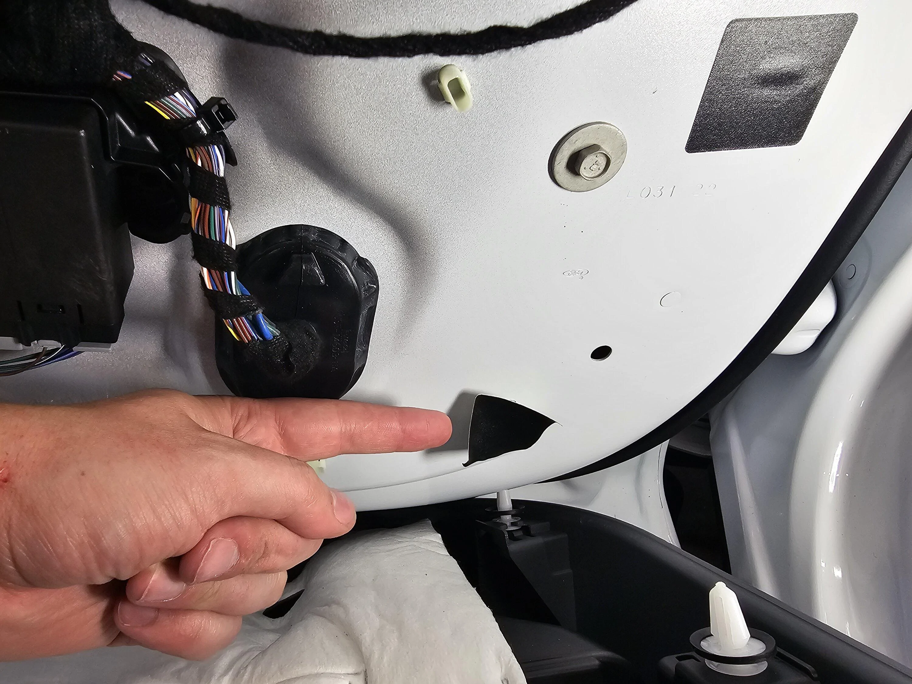

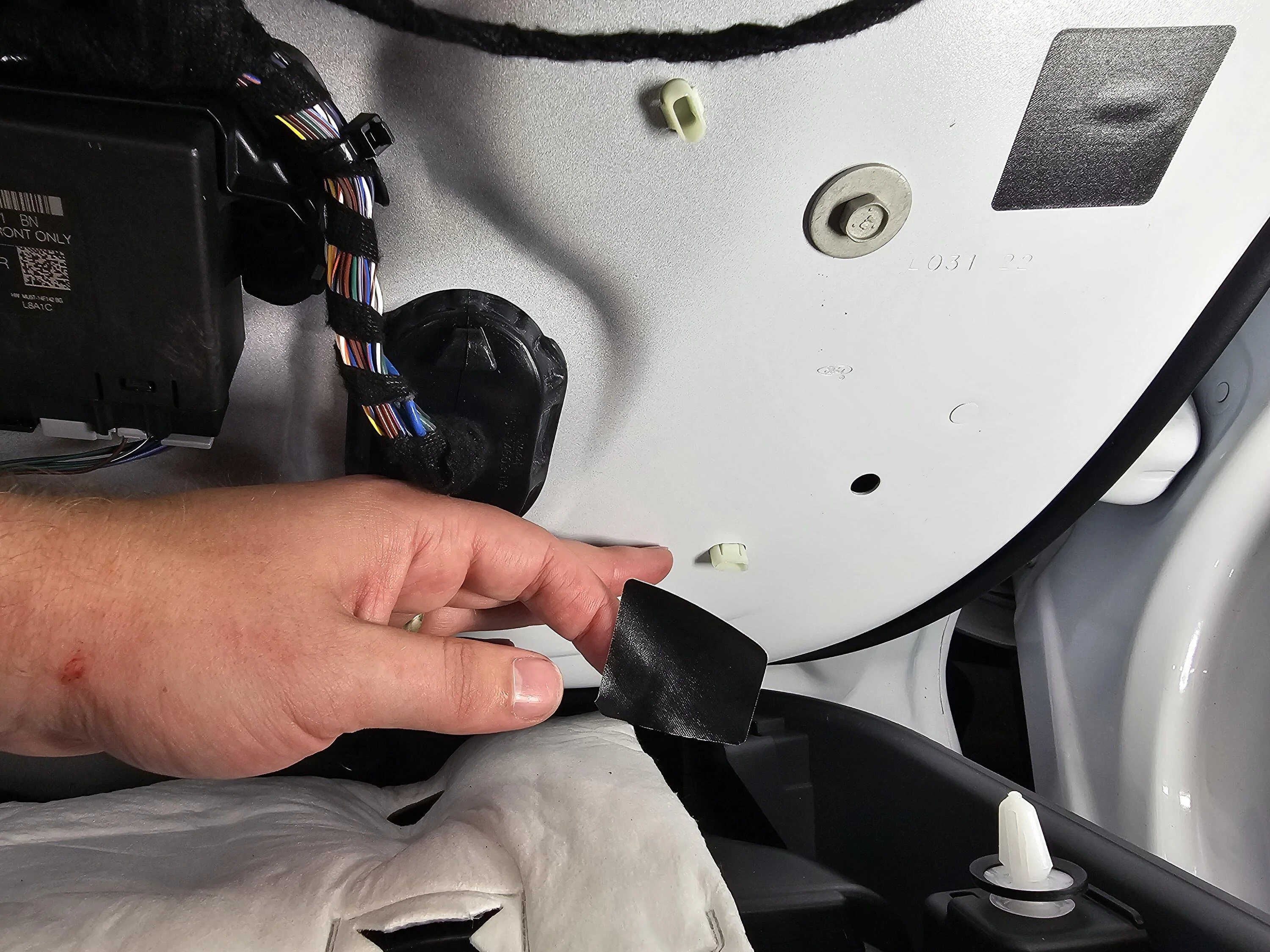

Wanted to share a few notes:
22 pro Tow tech/maxx tow.
Got driver side working per the well written instructions awesome! And the approach lighting is also sweet!
I would add for anyone that is more paranoid you can pull down a copy of the stock firmware before flashing the BCM right from forscan will deposit all the files for you "as built" firmware so to speak in your configurations folder.
also found one of the wire pins needed some tape on the door removed so it could slot in for the driver harness. just something easy to miss
Ford F-150 Lightning DIY: Installing Passive Entry To A 2022 F-150 Lightning XLT 20230917_173343
its here south east of the wire gasket going to the inside of the door
Ford F-150 Lightning DIY: Installing Passive Entry To A 2022 F-150 Lightning XLT 20230917_173349
figure worth noting for anyone who gets a phantom rattle might be that guy as its hard plastic which IMHO may be worse than the wrapped wire wiggling around in terms of rattle.
The plastic with the "goop" sealant also seemed pretty easy to deal with if you pull on the plastic and use a sharp razor blade to just slice thru the sealant (not the plastic)
I also found a pretty easy way to deal with our friend the main plug that snaps into the body of the truck. ill try and upload, basically using your hand reach the back side and rock the plug toward you will get a small pop then pick/screwdriver the middle of the side that's towards you and it will pop out easy
