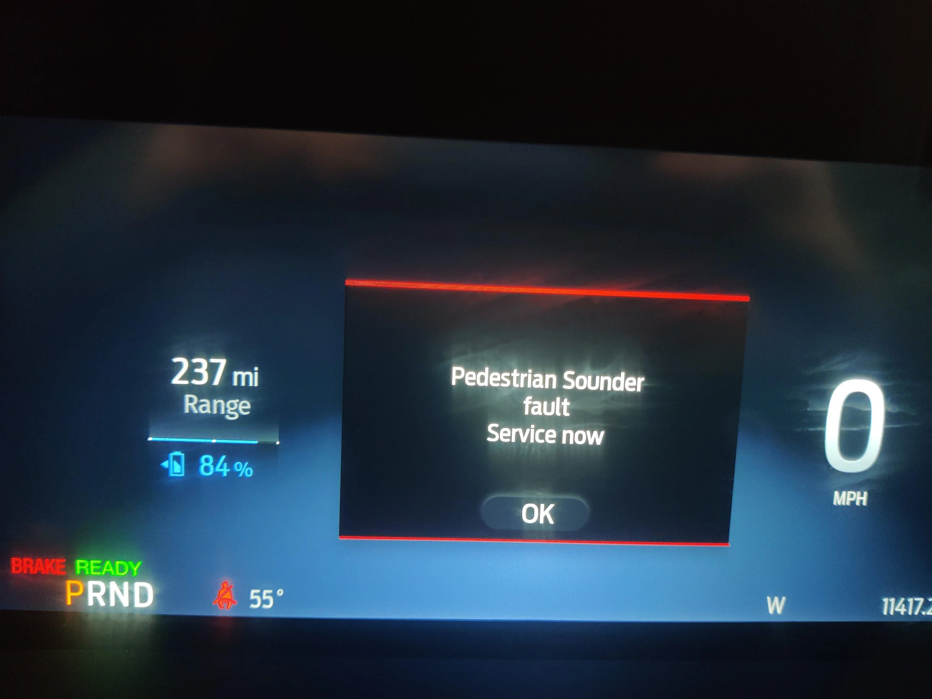

- Disable frunk beep. This requires unplugging the frunk speaker. www.youtube.com/watch?v=UdWVnZ5vNgM
- Disable backup beeper. This also disables the low-speed pedestrian noise, so please be careful with this one. These noises are federally mandated, and you will be ridin' dirty without them. You'll need to install the megaohm speaker delete kit: https://www.megaohmmotorsports.com/product/ford-psbk-ece
