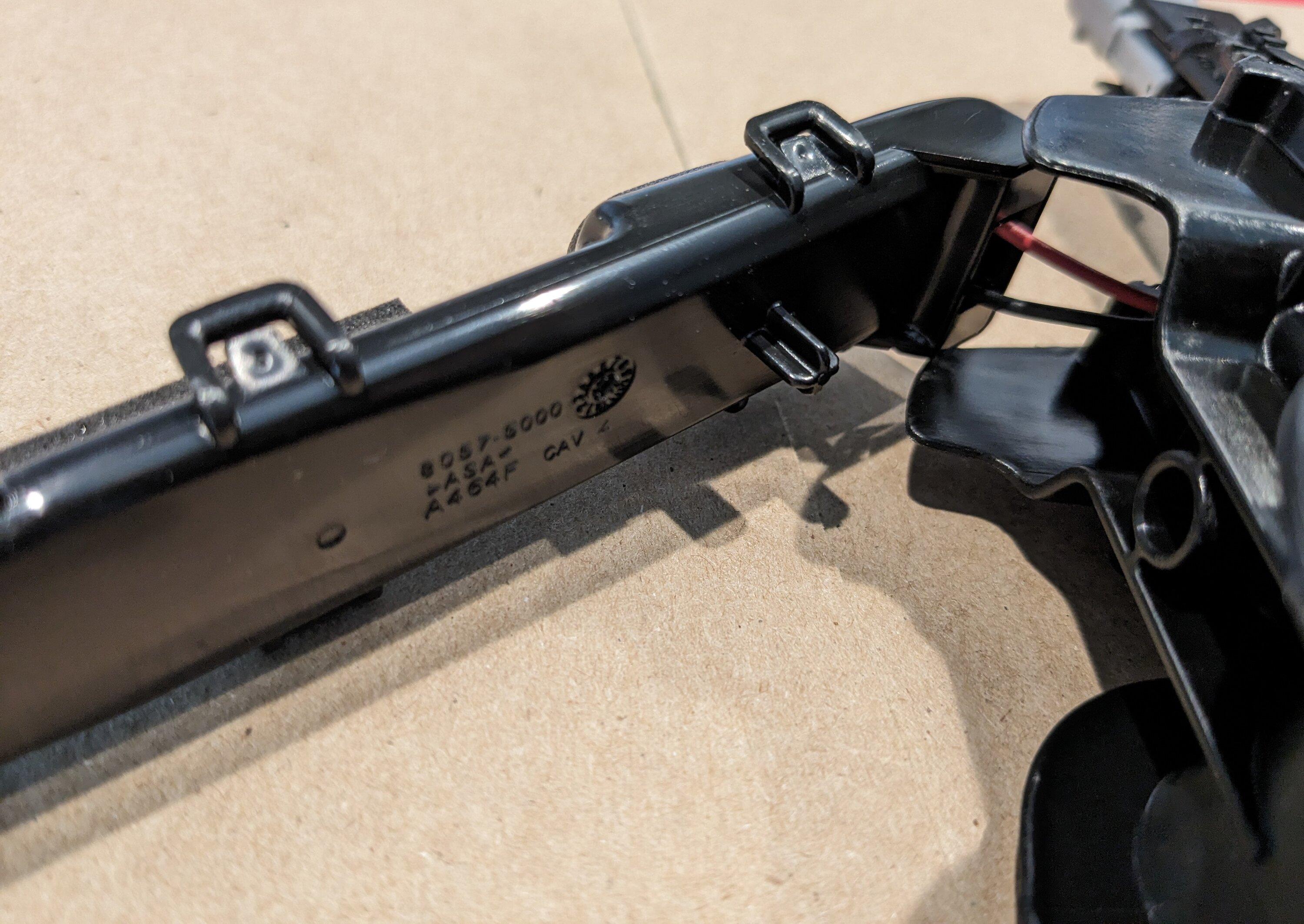

I can confirm that the cover from Bronco handle M2DZ-7822405-CB is swappable with the cover from F-150 handle ML3Z-1522405-DCPTM.
So, now, I have a paint-to-match Bronco intelligent access handle burning a hole in my pocket. Anyone have instructions on how to add intelligent access to a Bronco?

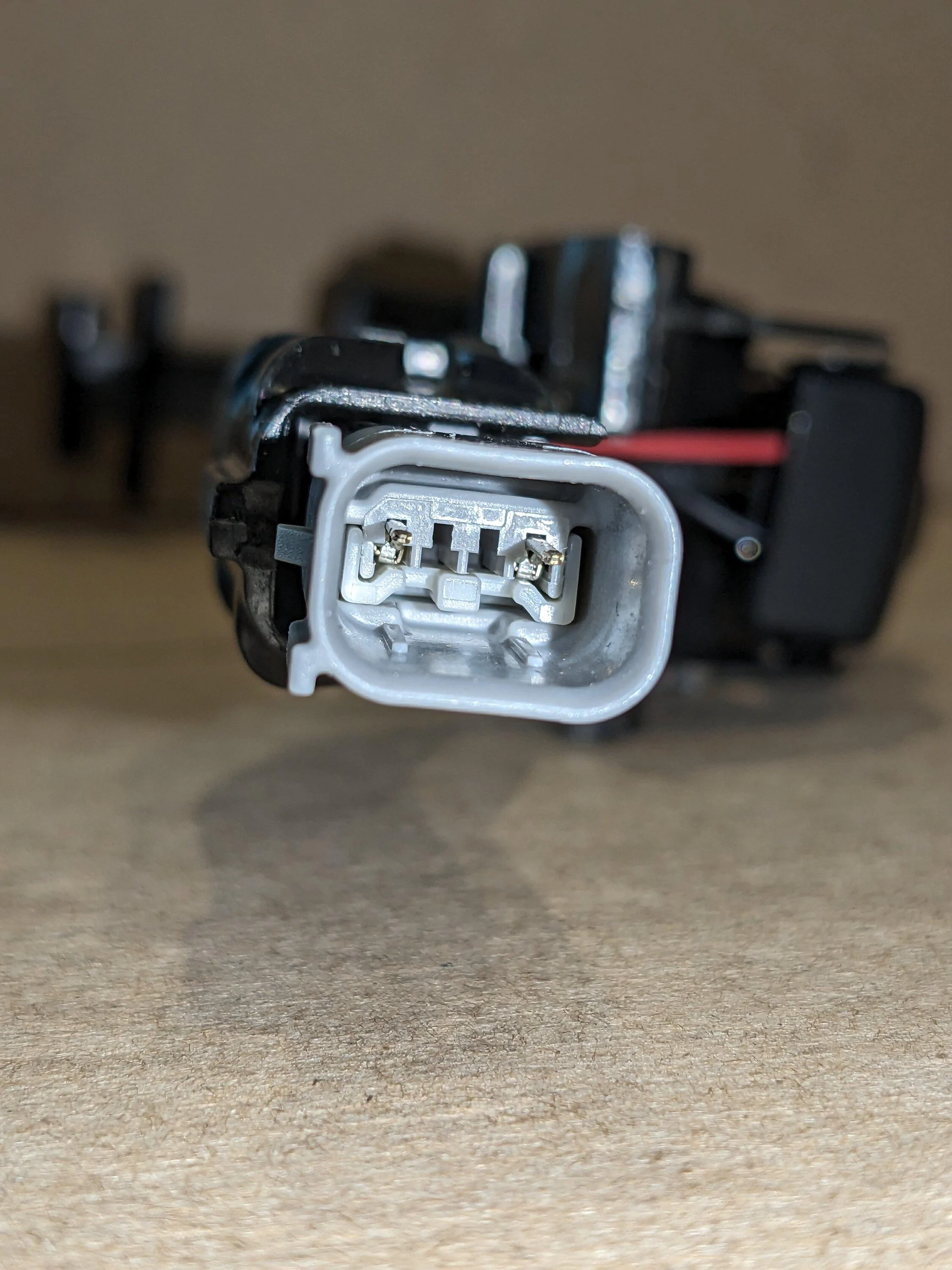

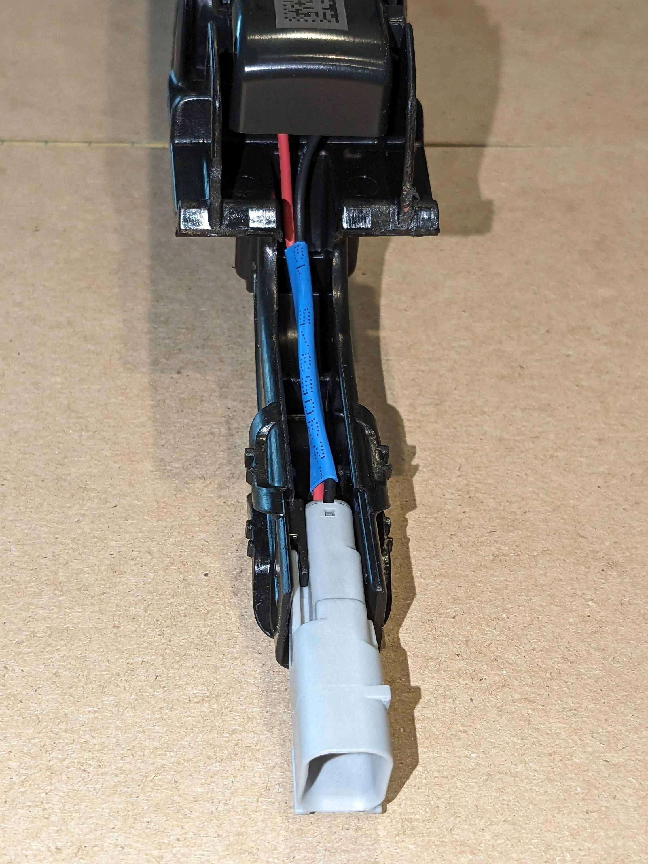

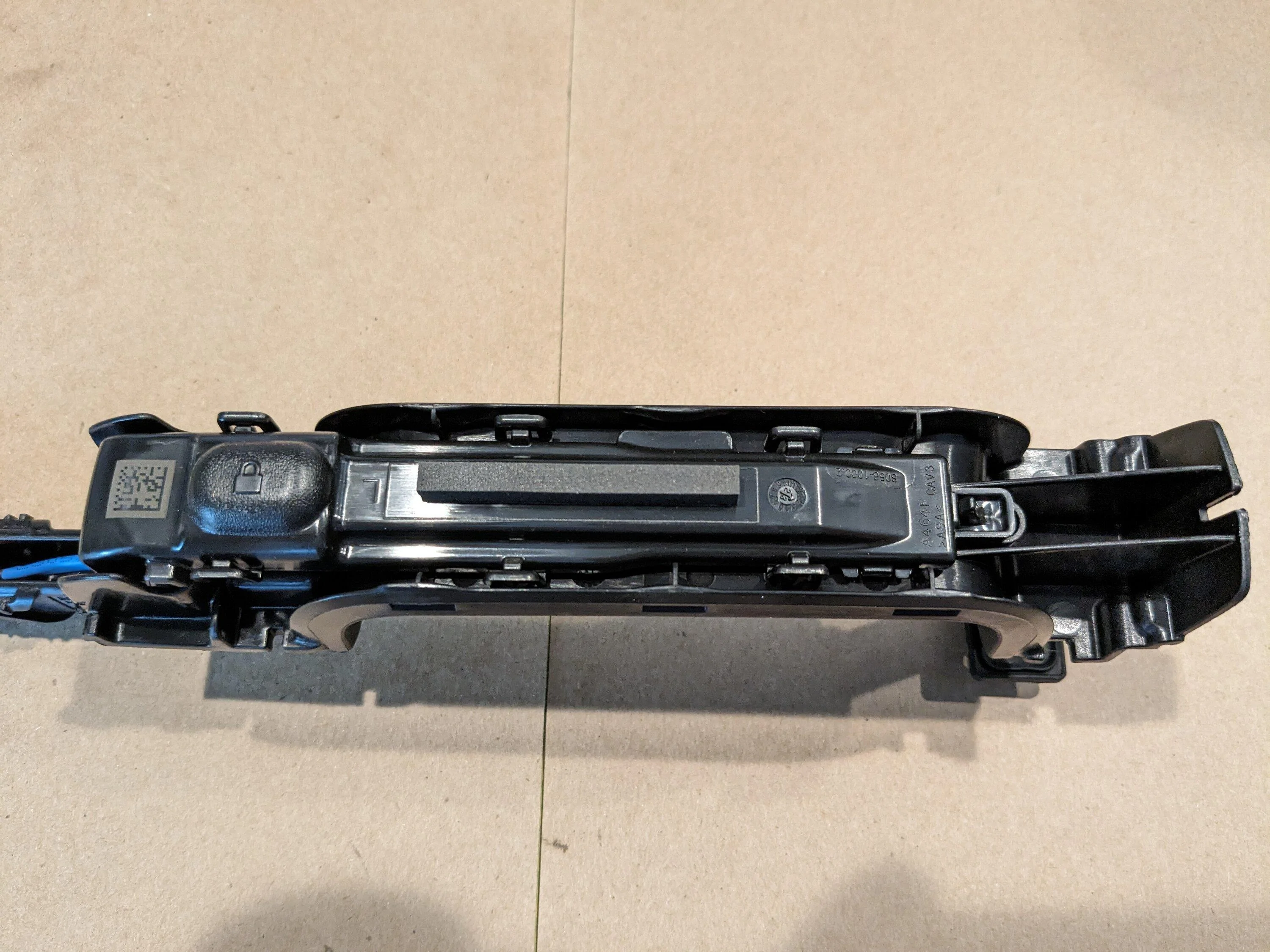

The connector on the Bronco handle looks the same, but a different color and with only two wires.
Ford F-150 Lightning DIY: Installing Passive Entry To A 2022 F-150 Lightning XLT PXL_20230711_190209564
Ford F-150 Lightning DIY: Installing Passive Entry To A 2022 F-150 Lightning XLT PXL_20230711_190523802~2
Ford F-150 Lightning DIY: Installing Passive Entry To A 2022 F-150 Lightning XLT PXL_20230711_190939361
Ford F-150 Lightning DIY: Installing Passive Entry To A 2022 F-150 Lightning XLT PXL_20230711_190845313

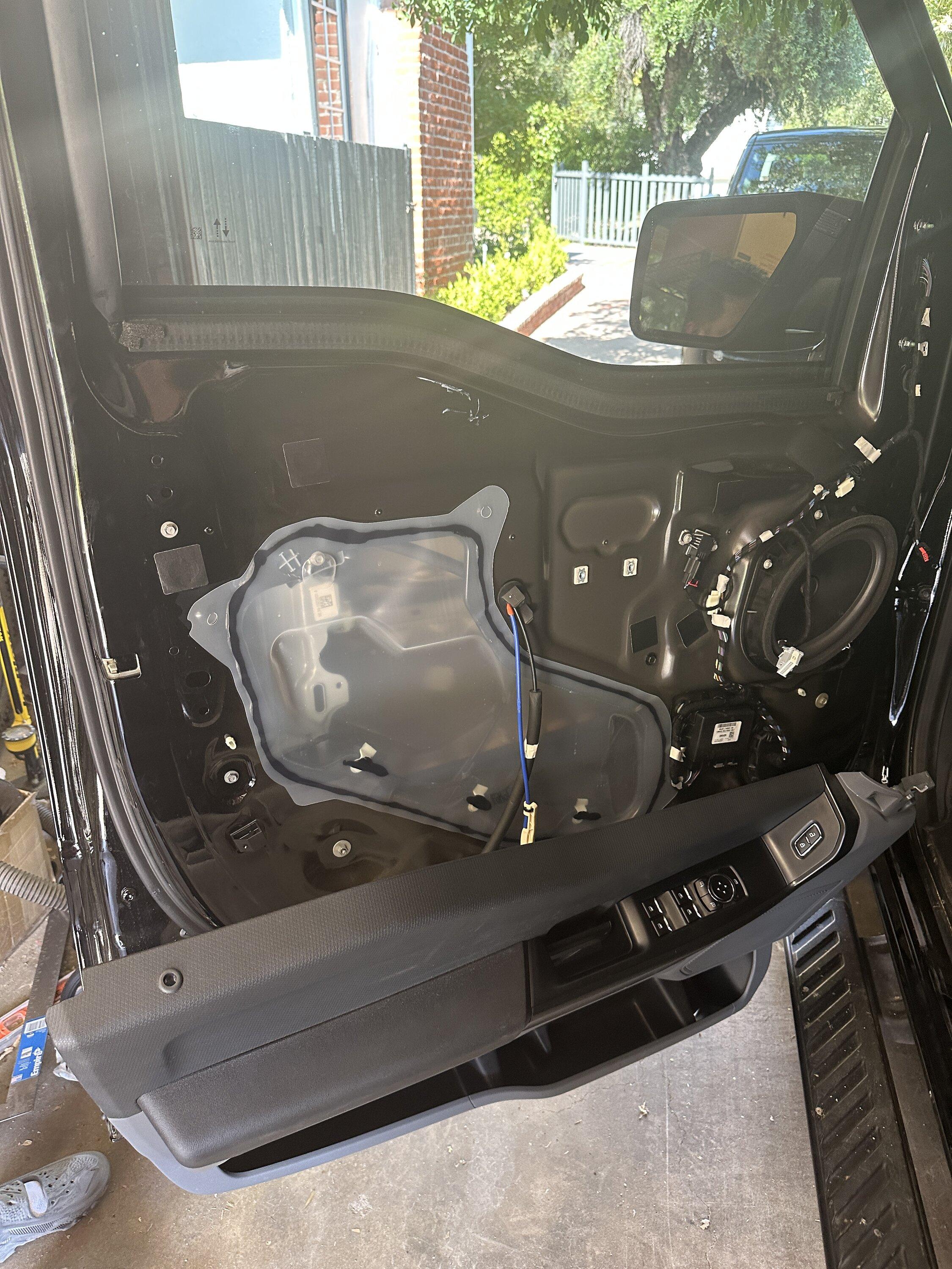

hi! I hope that offer to help still stands lol. I have the door off, and the new button installed. I now have a couple questions:
1. I have the door panel off but the inner and outer steel doors are together still. Am I supposed to take that apart somehow? I watched the YouTube you posted and it was just the door panel.
2. where is the part you dremel “in the door” after the button?

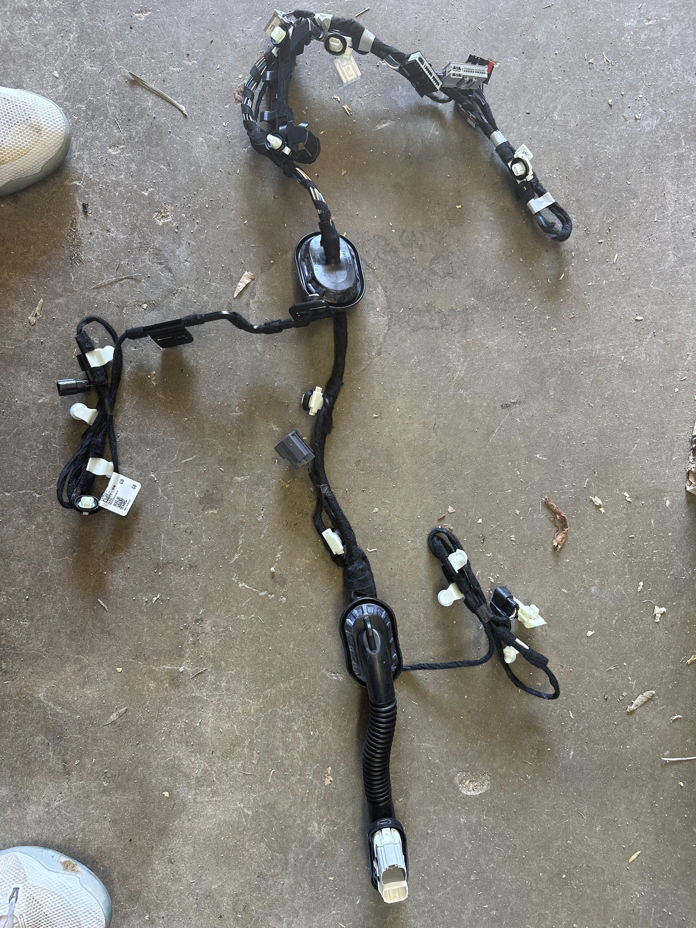

3. The harness I got from the parts list is more than just the door jamb side. Do I use all of it or just the short piece from door to vehicle door jamb?
4. How do you connect and feed the wire from the door to the harness?

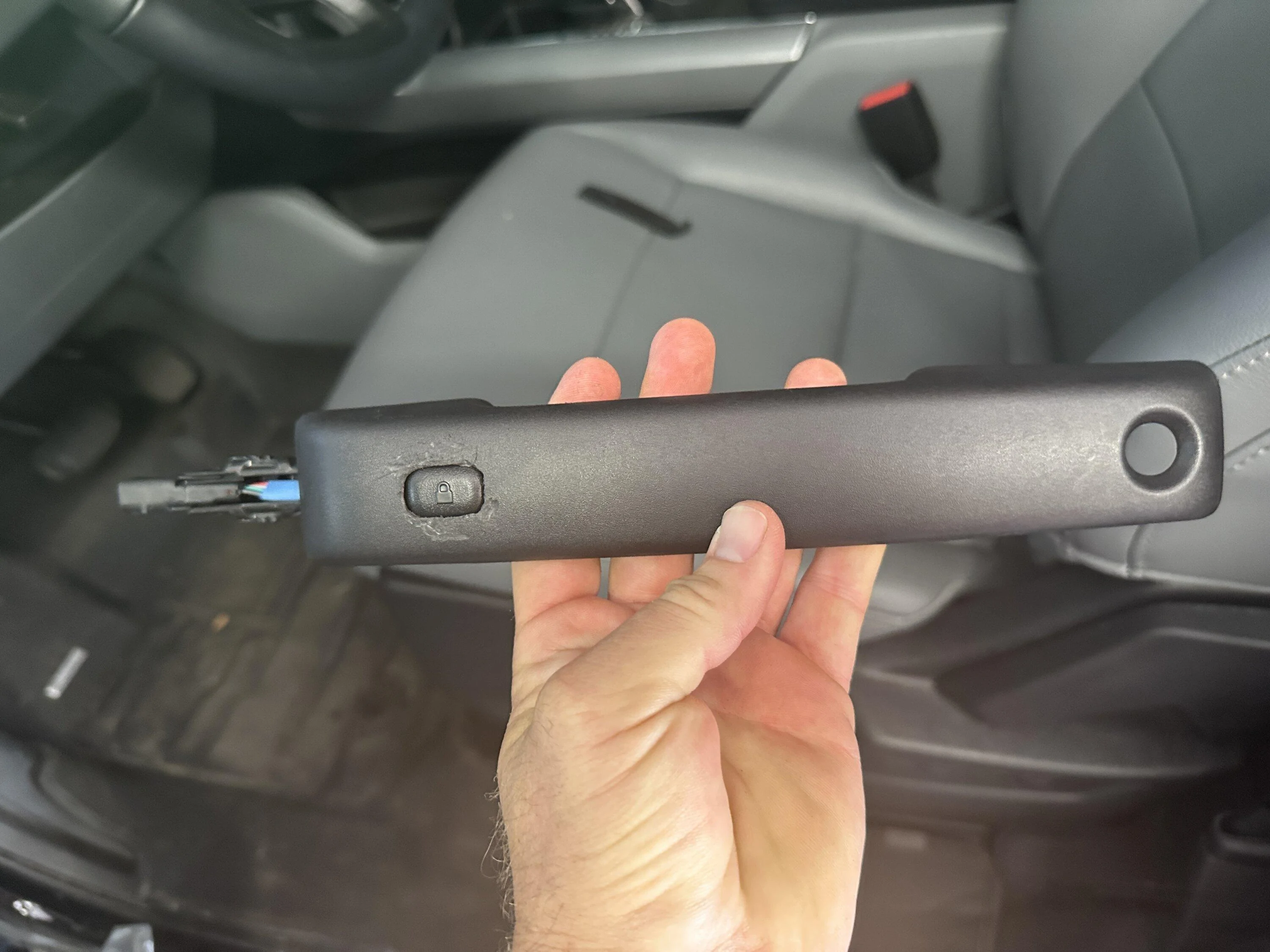

5. I did a really really shitty job with the dremel. Do you know if the abs handles are available alone so I can retry?
Here’s where I’m at:
There is a bolt you take loose at the bottom of the window track when fishing out/in that port of the harness, You need to take off the plastic and the speaker you will need to reach in lots of the access holes.
You reach it by putting the entire dremel/drill inside the door through one of the access holes. It is part of the plastic frame where the door handle connector pokes through and pivots.
You used the entire door harness as is, You are replacing the factory door harness. Yes it's a lot of connectors and yes it is a lot of work.
Getting the door jamb connectors, unsnapped and unhooked is the hardest part and there are many tips/pics here in this thread past.
My God, did you do that with a army swiss knife 🤣🤣🤣. Others have recently confirmed the bronco door handle shells do work (part numbers in this thread). Or for 35$ you can try again with the factory textured ABS handle.
This mod is not easy, but stay at it and you will get it.

my problem with the dremel was two-fold. 1. I’m terrible with it. 2. I did not have the right bit. I had to start with a drill then use the tapered grinder. It was really, really challenging to chamfer the inside enough to get the lock/unlock for the new parts to fit. To get the angle I kept hitting the collet onto the plastic and that slight touch was enough to mar it. After the first two mistakes I realized “fuck it, imma get a new one and try again” and stopped caring haha.
you wouldn’t happen to know the part number for the stock abs handle cover to try again is would you? No worries if not. I’m sure I could search enough to find it.
thank you again
Correct the clear plastic sheet, if you are careful the black adhesive comes off with it and will go right back on just like factory.
Yes I have the part number and I have a spare I might be willing to just do for you.
Definitely need the speaker hole for routing the harness. But I think you grind out the little black plastic rib from the bigger hole in the middle.
