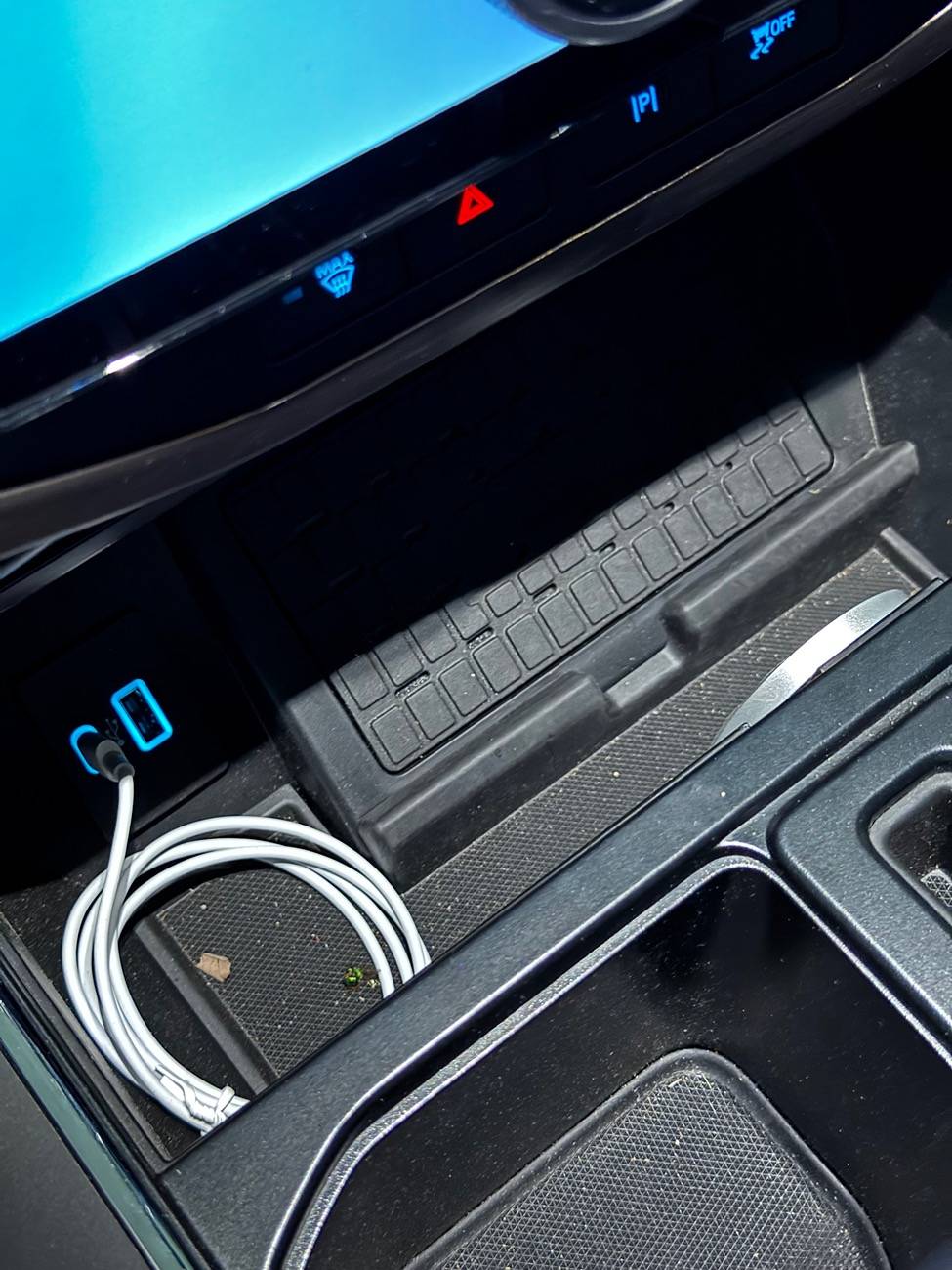

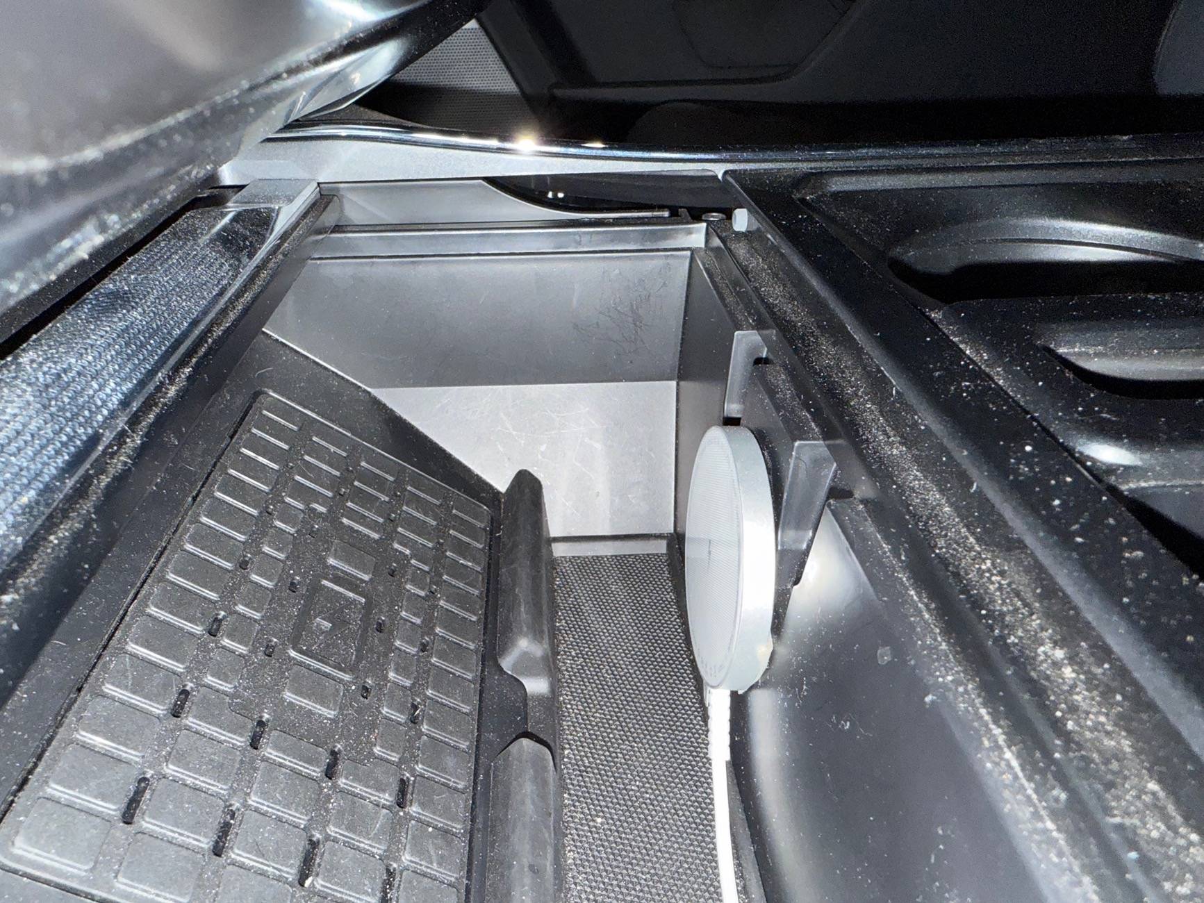

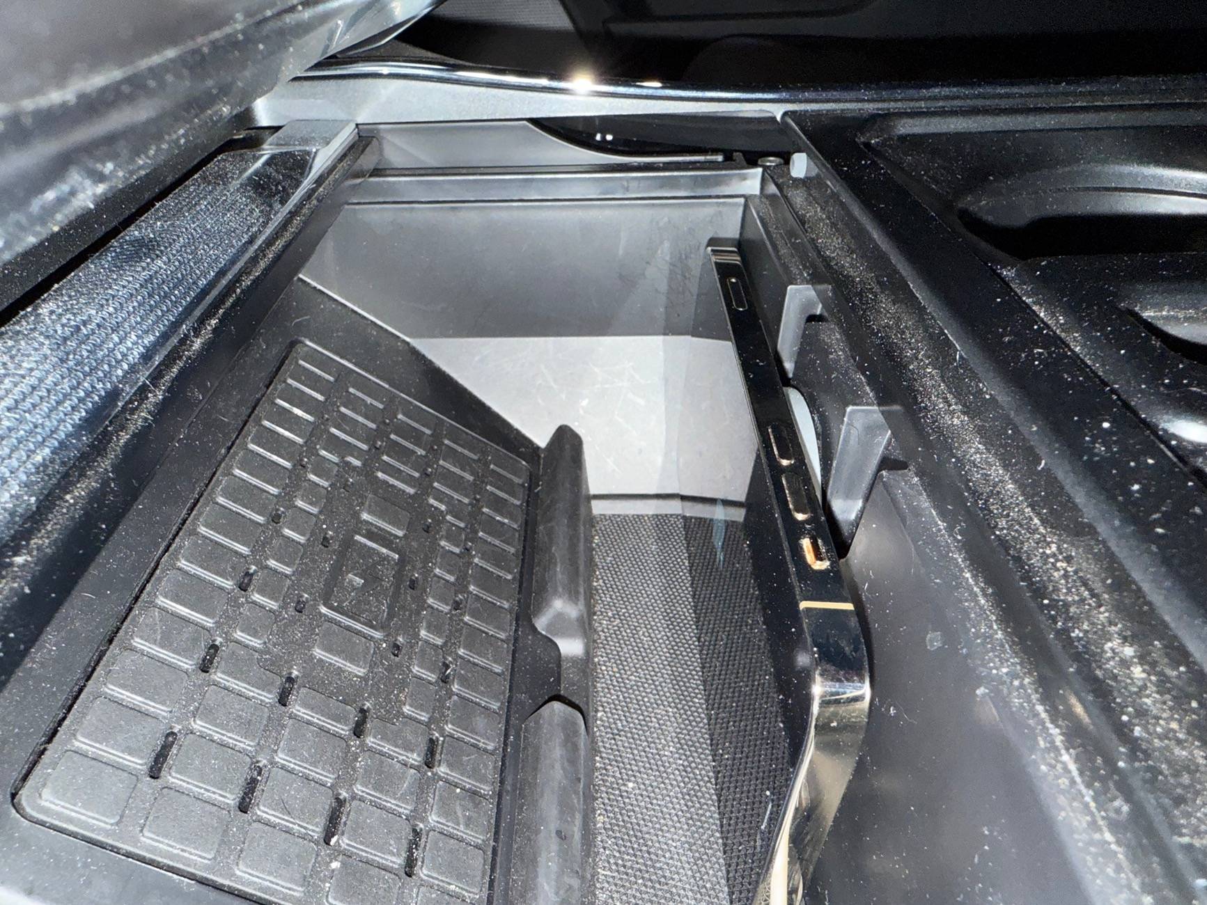

As many have noted on the forum, the Ford wireless phone charger is not good. I refer to mine as the ’phone heater’. So, not wanting to give up on wireless charging I installed a MagSafe puck (i think these are iPhone only so YMMV). I also did not want to install it somewhere on the dash or center console and have a wire running around. It’s worked out to be very slick and is far superior to the built-in charger in terms of heat to charging ratio. Anyway, figured I’d share for anyone who has similar complaints and desires.
Ingredients:
  1. MagSafe charging puck
  2. Double sided tape (I used 3M double sided body panel tape which is seriously incredible stuff)
Result (the dust level and dead fly are somewhat embarrassing, but such is life):
Ford F-150 Lightning DIY MagSafe iPhone Charger Setup IMG_0917
Ford F-150 Lightning DIY MagSafe iPhone Charger Setup IMG_0919
Ford F-150 Lightning DIY MagSafe iPhone Charger Setup IMG_0920
The MagSafe puck is arranged so that the drawer cover still closes without issue. Hopefully this is useful to someone!
