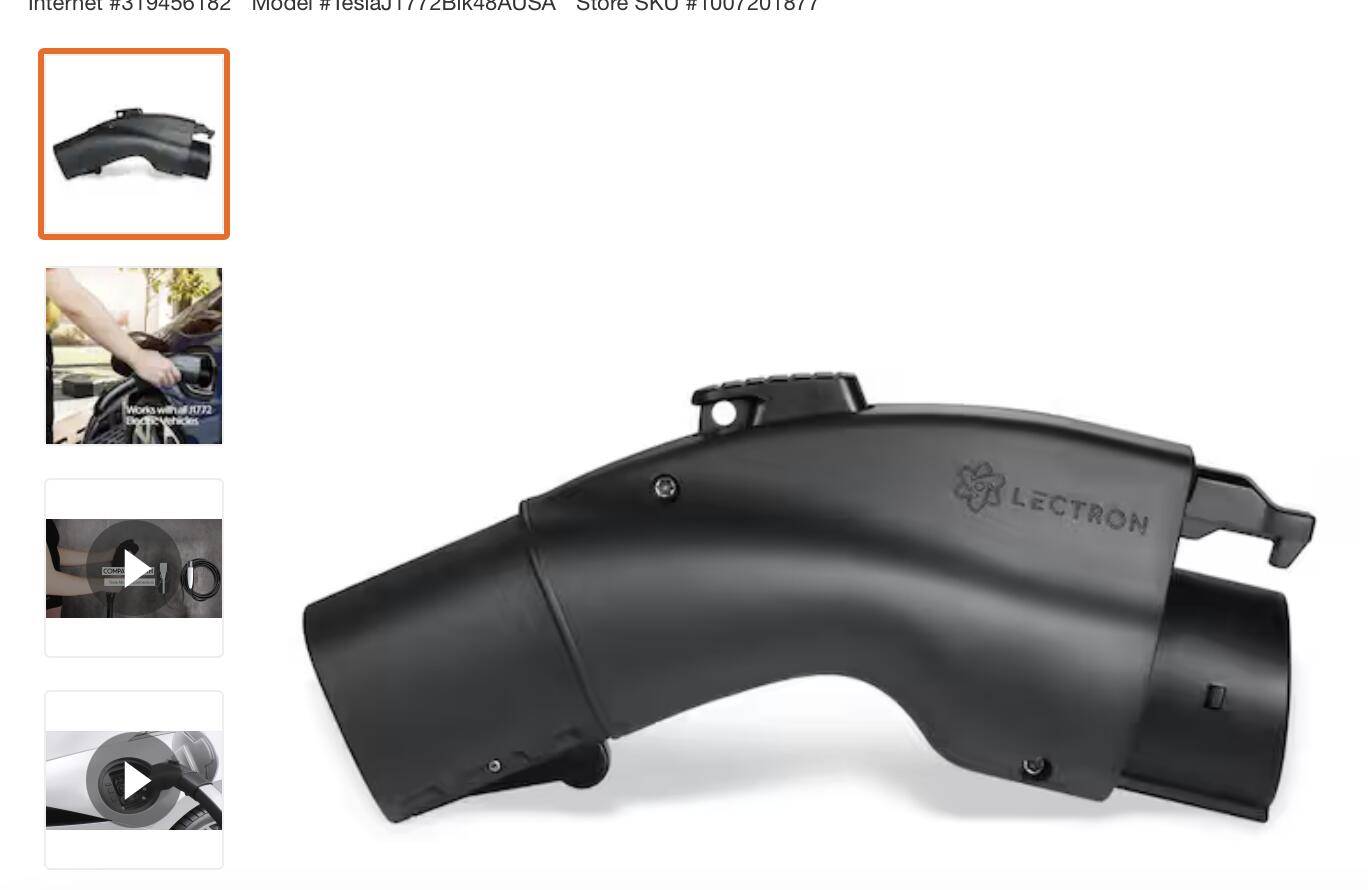

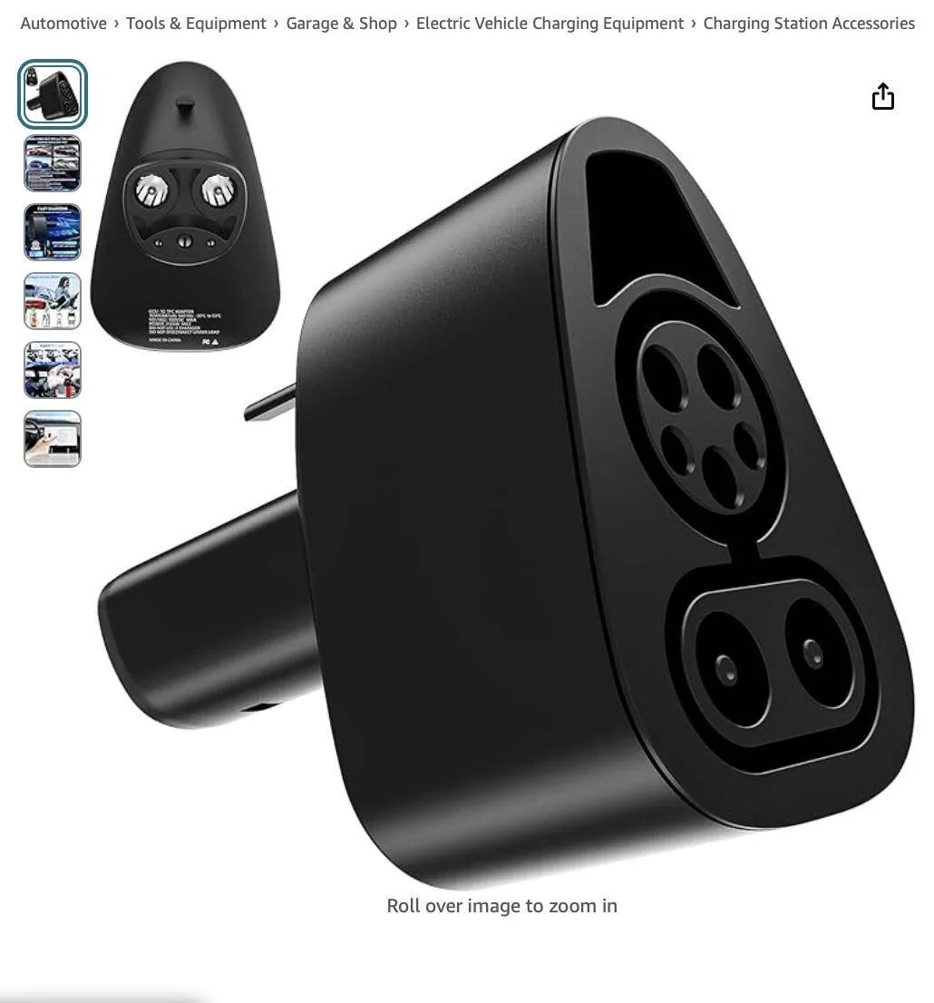

I bought a Thunderstorm Light from A2Z CCS1 to NACS and paired it with the A2Z NACS to J1772 adapter and I can confirm it works. Power flows thru the J1772 adapter.
Only difficulty I ran into was removing the NACS to J1772 adapter from the thunderstorm light. There is a lock and unlock slider on the bottom of the NACS to J1772 adapter but I am having a hard time separating them. I don't have a NACS vehicle now so not that big of a deal for me. Will report if I find a solution.
