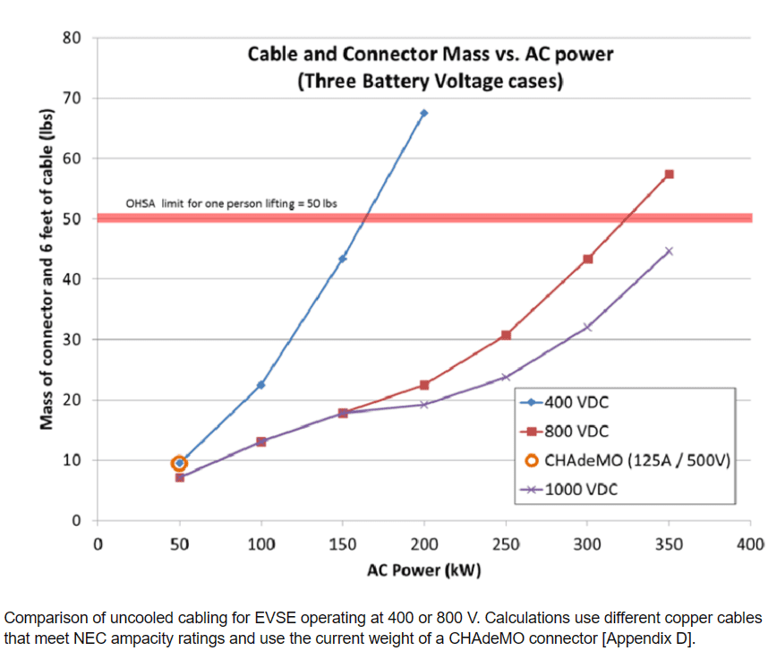

What are you basing that on? That’s over 400 amperes.
This chart I found one time showing 6 feet of uncooled cable. v3 superchargers operate at 400v (blue line), looks like 6 feet of cable would be able to handle it and weigh 45lbs. Now, let's take into account that we only really need an extra 4 feet or so, and also can relax the cooling scenario a bit because it isn't something that will be used repeatedly by customers all day long every day.
