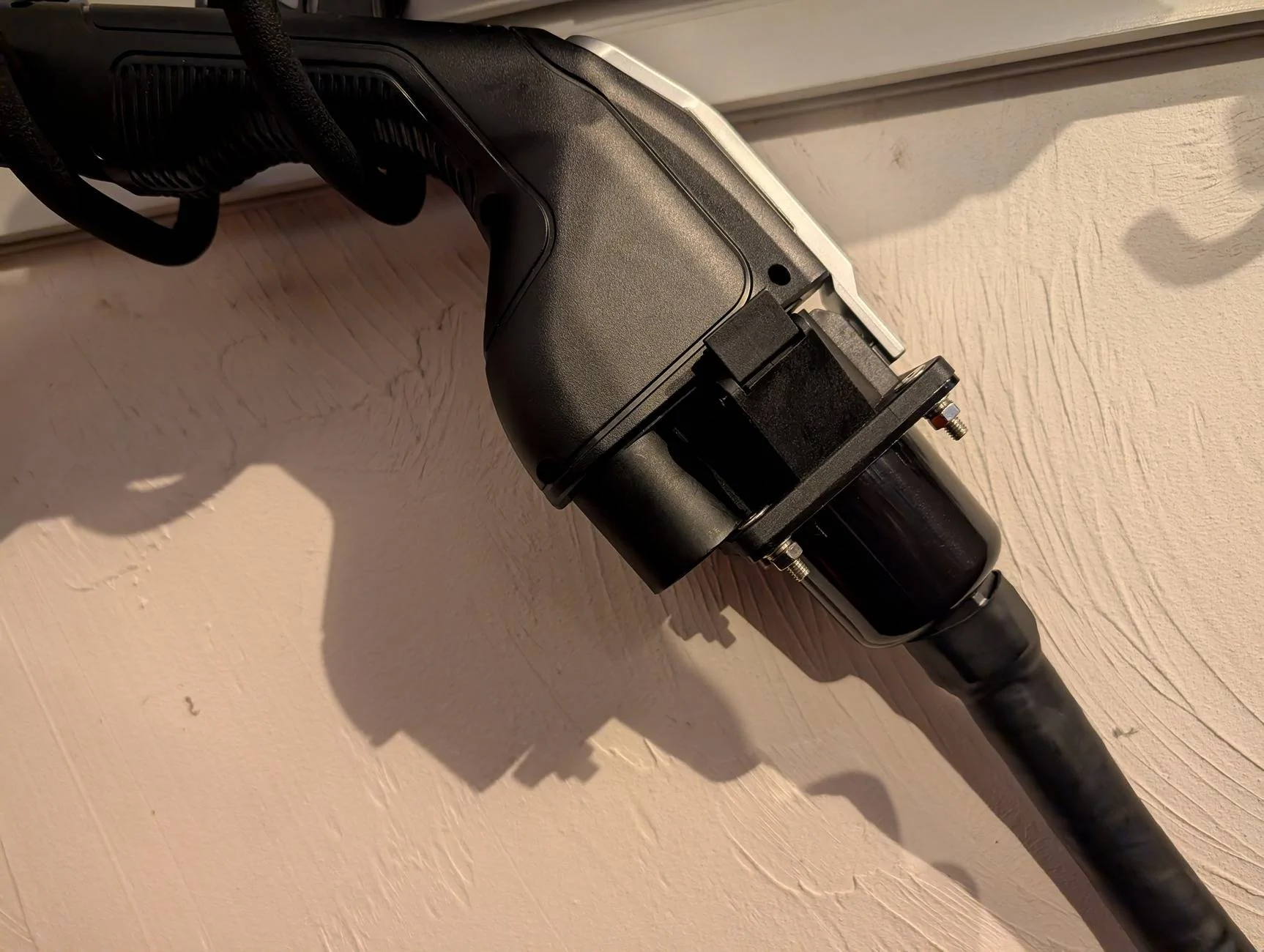

I've done this and it works:
I got a 25 foot j1772 extension cable. It's got the standard plug for the car at one end and the other end is the opposite gender.
On the extension cord I notched the plastic so the FCSP connector clicks in the j1772 side. The DC pins are exposed but unused for charging as stated previously in the thread.
I use this to charge my PHEV at 3.3kW. Seems much safer than the wall plug which would get hot and need to run for 18 hours. I don't use it like this outdoors.
I've also used this combination with a Tesla j1772 adapter at the end of it to charge a Model 3. It worked but the FCSP wouldn't start properly unless we slowly ramped the amperage up from the Tesla...that would be another nice feature to have on our Lightnings.

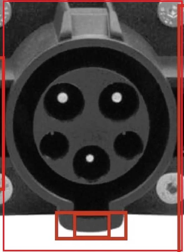

A few months ago (Jan 2024) I suggested that exact thing ought to work - but I didn't try it myself.
Is this where you modified the extension cable to make it fit:
Ford F-150 Lightning Does a CCS1 to J1772 adapter exist? 00-CCS1 to J1772 DIY-2
It looked to me that maybe just removing that bit of plastic at the bottom would do the trick.
Glad it worked.
What 25 ft J1772 cable did you buy and where - link?
Glad it worked.
Yep just cut off that part you highlighted so the CCS connection didn't interfere. No modifications to anything electrical.
It looks like I ordered a 20ft cable from Lectron last year in September. Not sure if it is still available. The unit I got is branded Duosida though.
