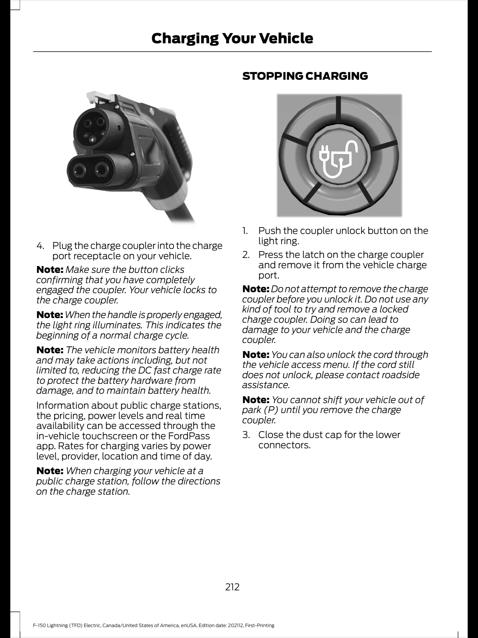

JustaProGuy
Hi I see an unlock button next to my charging port but it doesn't seem like the truck locks the charging cable from being removed? Anyone know how to lock the charging cable to prevent removal?
