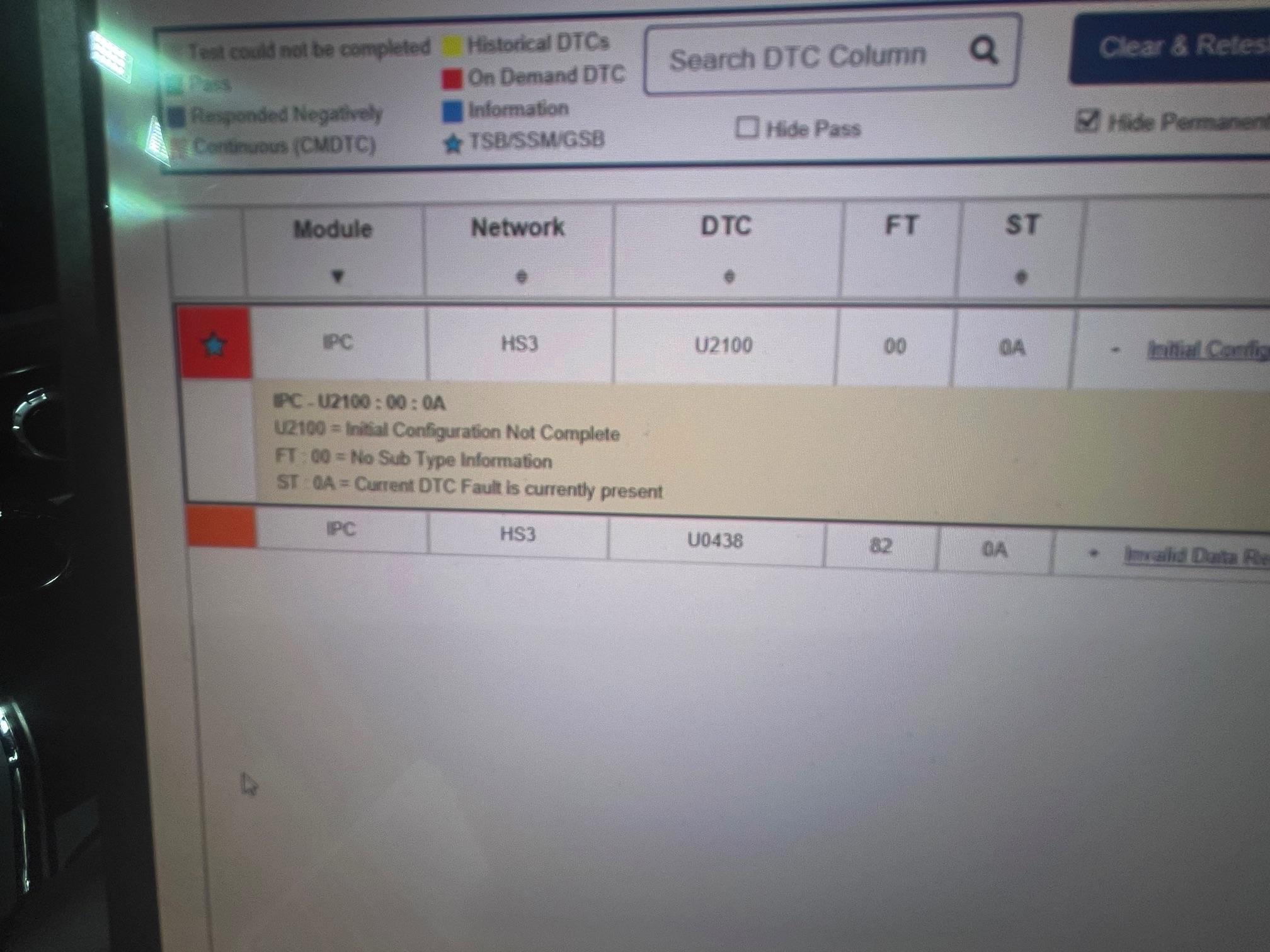

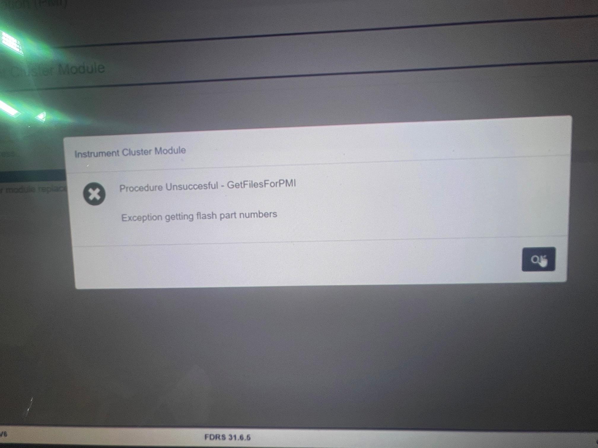

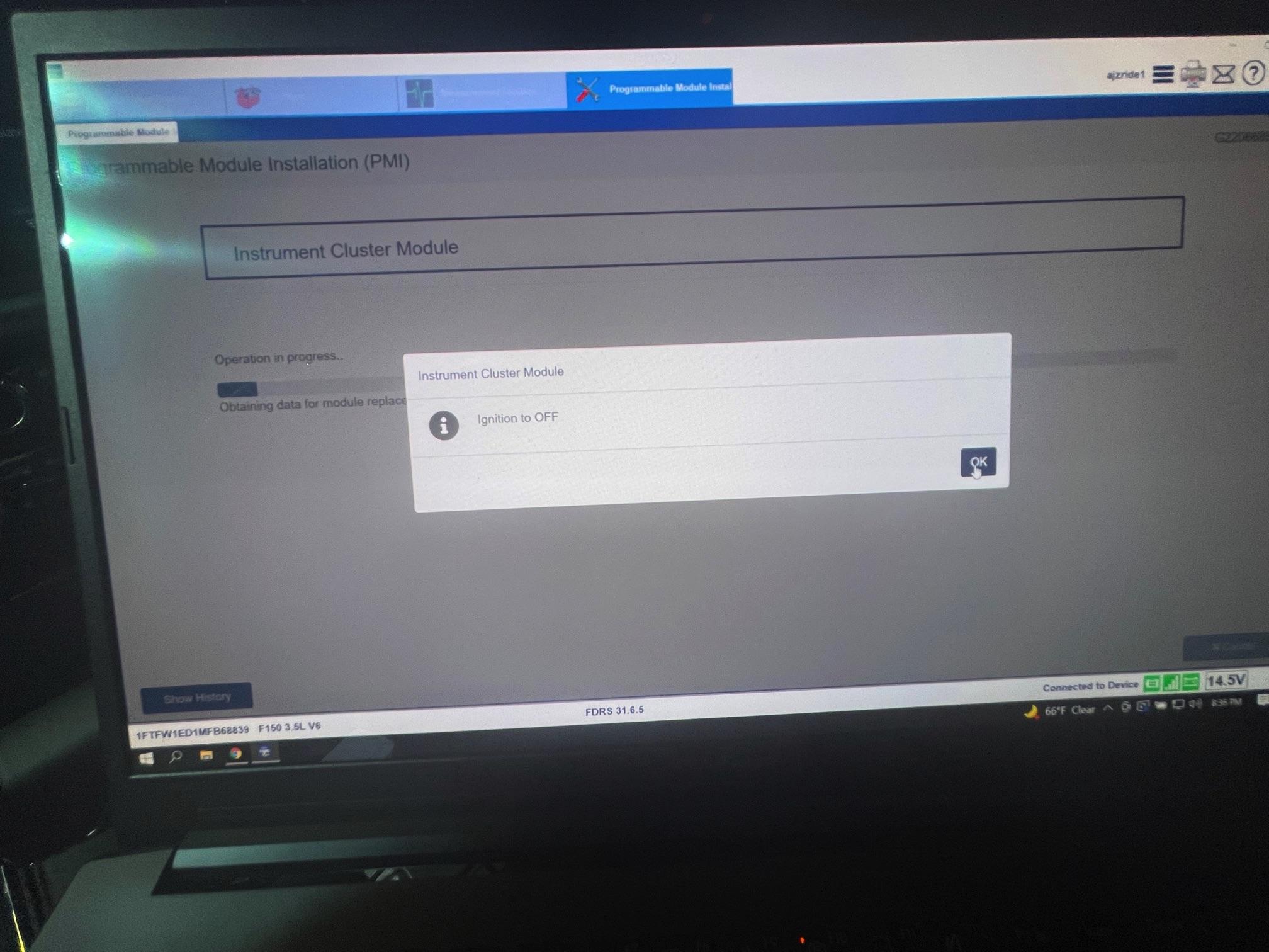

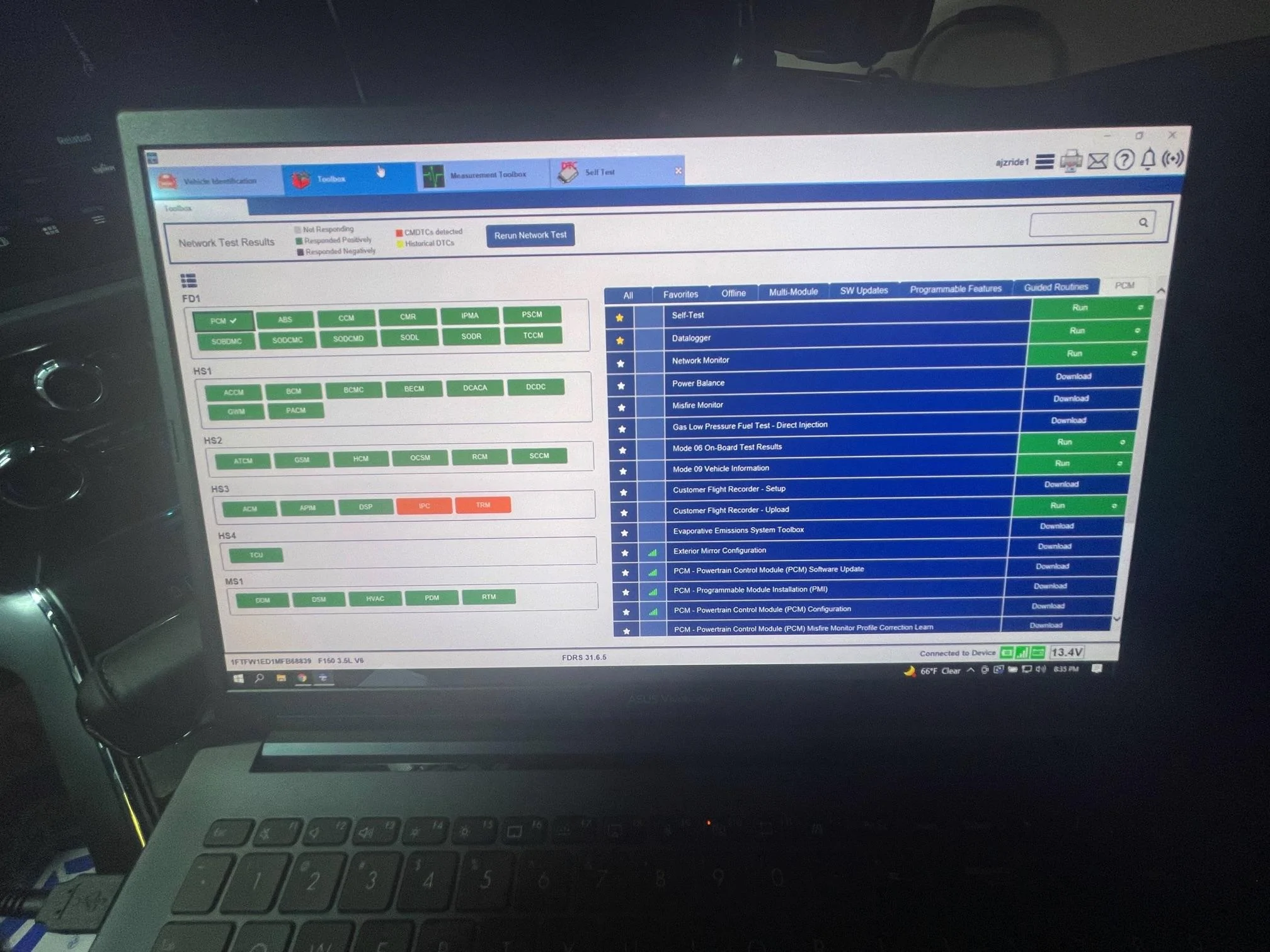

I gave up on the F-150 and stayed up all night doing the Mach-E. Finished about ten minutes ago. Installed every update in FDRS but my sync is still not current and no blue cruise.
No new updates for the truck either, will have to try and PMI the IPC again
I hate hate ford so bad I can’t see straight right now.
