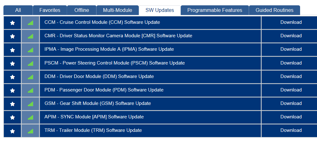

I updated to Revision 244 a while back before my FDRS license expired. After following the thread and reading every single comment, I ordered the Mongoose (arriving today) and will start the next steps. Would someone mind checking my VIN to make sure I have updates before I pony up for the next 30 days? It would be much appreciated! 1FTFW1EDXMFB51683

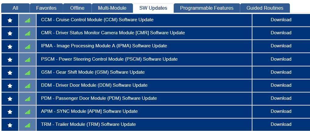

Ford F-150 Lightning ECU module programming guide using FDRS 1FTFW1EDXMFB51683
Note: Even after completing those, I think you will then get an additional APIM/GWM update that is not currently listed.
Ford F-150 Lightning ECU module programming guide using FDRS kevinwright.PNG

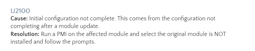

I'm still getting reverse brake assist unavailable alerts, even after a 100 mile drive last night where I was able to go dozens of times with no steering inputs for 30 seconds. Could it be related to my IPC U2100, or should I be looking into something else?
Not sure this will help but I got this from Bob Mac's documentation.
Ford F-150 Lightning ECU module programming guide using FDRS Screenshot 2022-03-22 114643

Thanks Kelly, but I've literally tried to PMI it over ten times. It fails every time. I'm not sure why an IPC U2100 would affect reverse brake assist though.

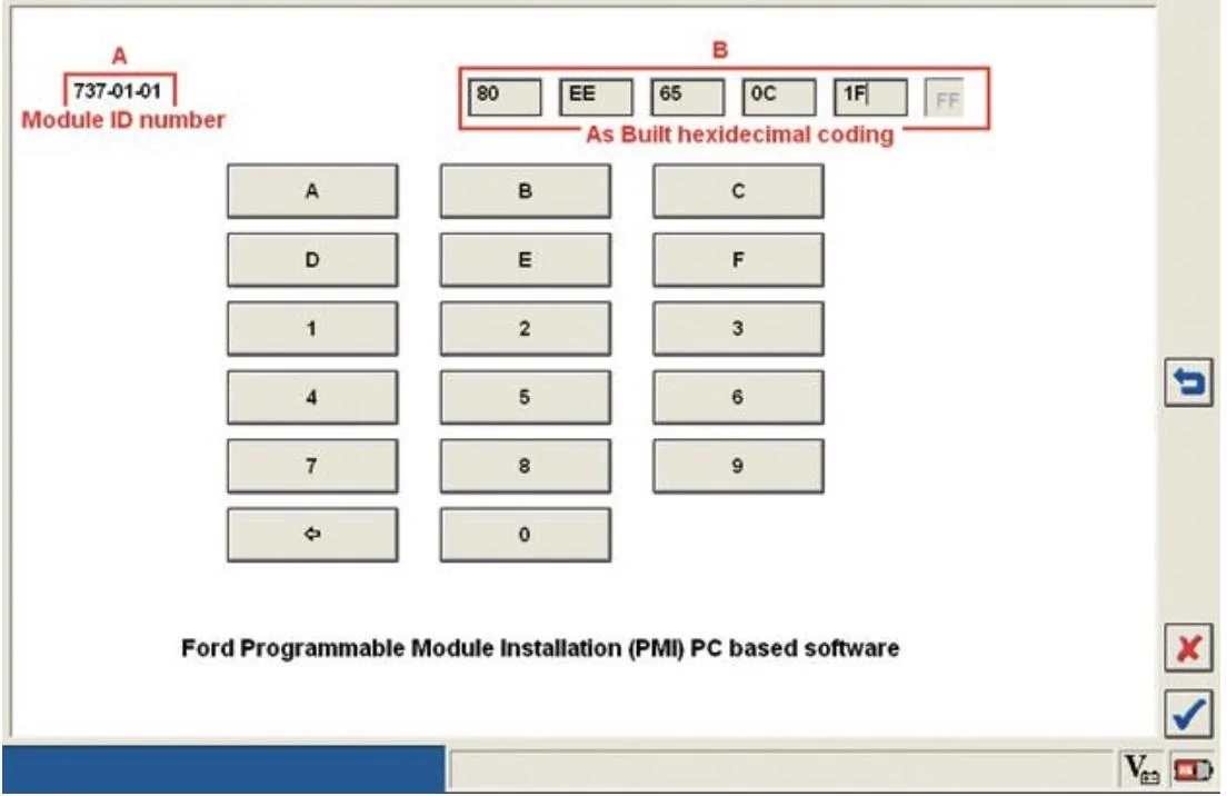

IDS had an As built editor (shown in the screen shot below). Is this function easily accessible within FRDS or does the software have to be fooled into trying to PMI an ECU while its offline or tricked somehow to get to this stage? Also, does the checksum have to be manually calculated when doing this?
Russian sanctions are limiting the usual options for many people, so I'm interested in learning the proper way to edit As Built data with FRDS.
Ford F-150 Lightning ECU module programming guide using FDRS 5
