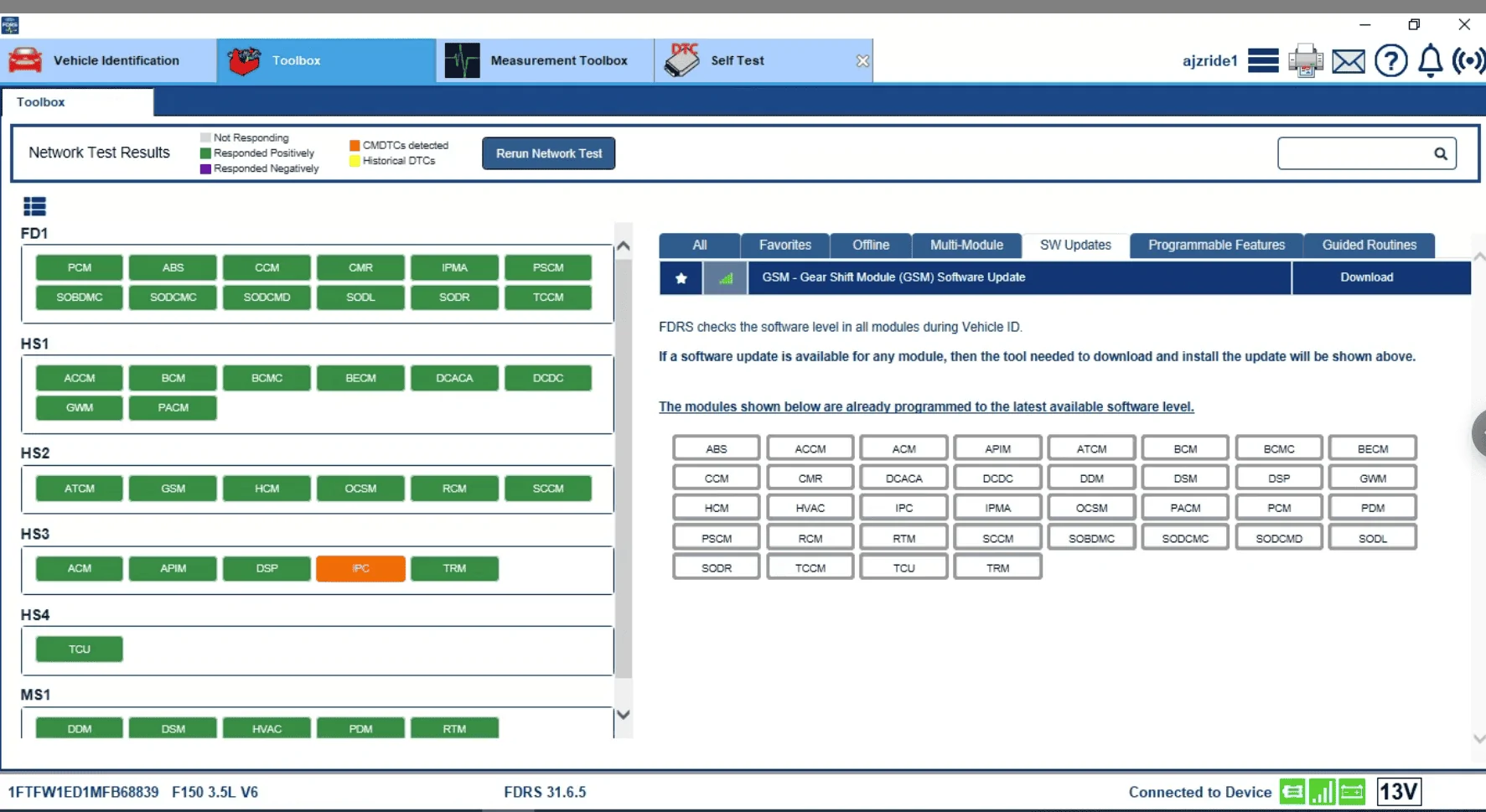

No issues checking for updates earlier today. For others here, every update in my list that was hanging around despite being applied went away except the GSM. Not sure why FDRS likes me and hides stuff I've applied.

The only update I have showing available is the GSM, which I have tried and verified it is a ghost update.
this shows up on mine always too. No way to clear it. All other updates completed and cleared fine.
