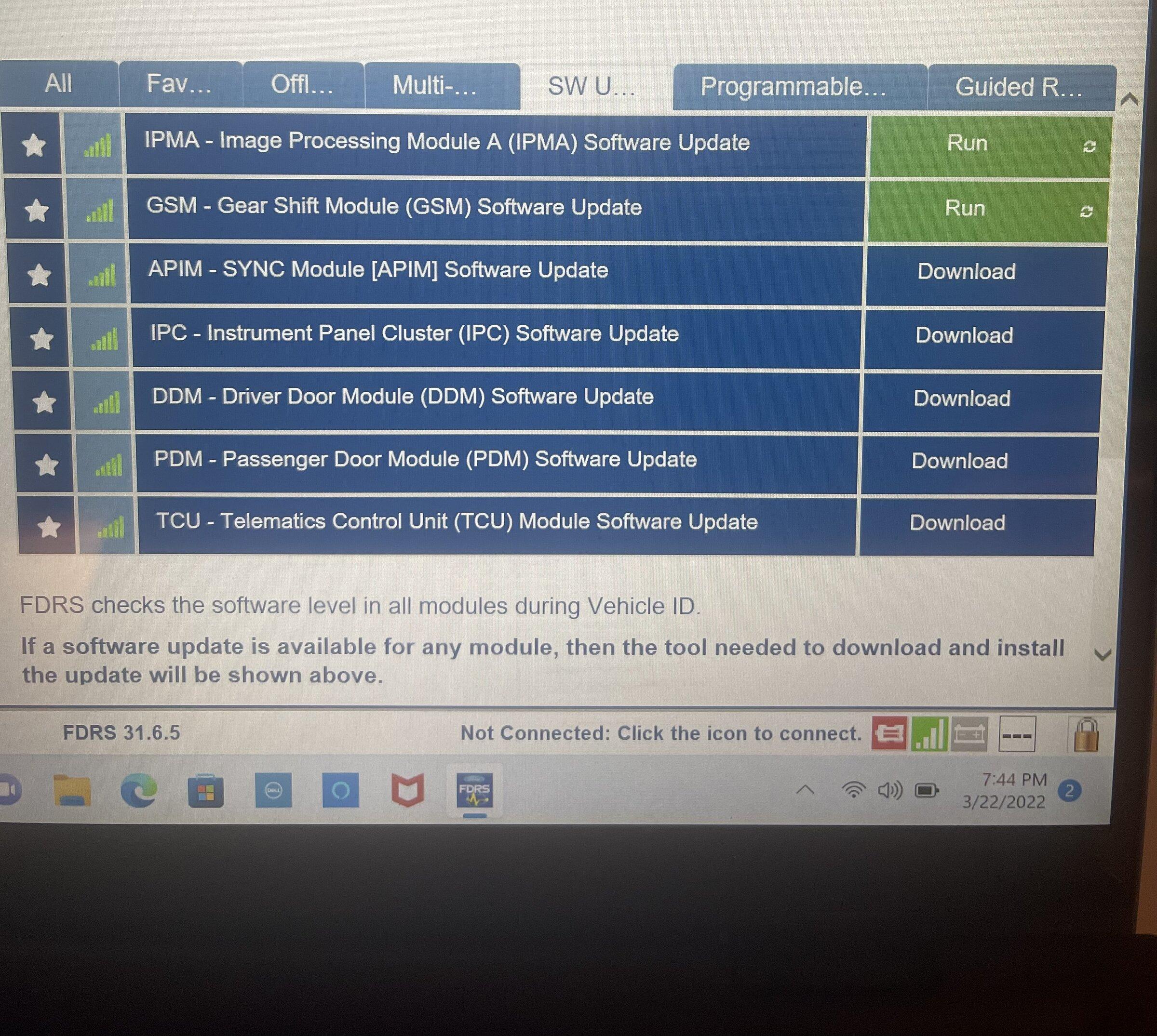

Working my way through the updates. During the ipma when it was time to turn the ignition off and then back on it said something failed but couldn’t catch it. There was another time where an error popped up when it said to turn the ignition off then on. Should I run the update on it again?
If you get a fail always reverify. I have mentioned this before but if you verify TOO quickly after turning on the ignition you will get the first couple files to fail. I dont usually even turn it off. If you do though WAIT to do anything until the truck is back on completely. You can re run the update and it will detect if its up to date and decide what to do
Thanks. That was prob my issue is I didn’t wait long enough for the boot up. Sorry if I missed your previous post, good to know I can just hit ok and not power cycle.
When it tells me to restart the truck for an update. I turn the ignition off, open the door and let the instrument cluster and center stack display both go dark, then close the door and turn the ignition on and wait for both screens to get to their "home" or startup display before proceeding further in FDRS.

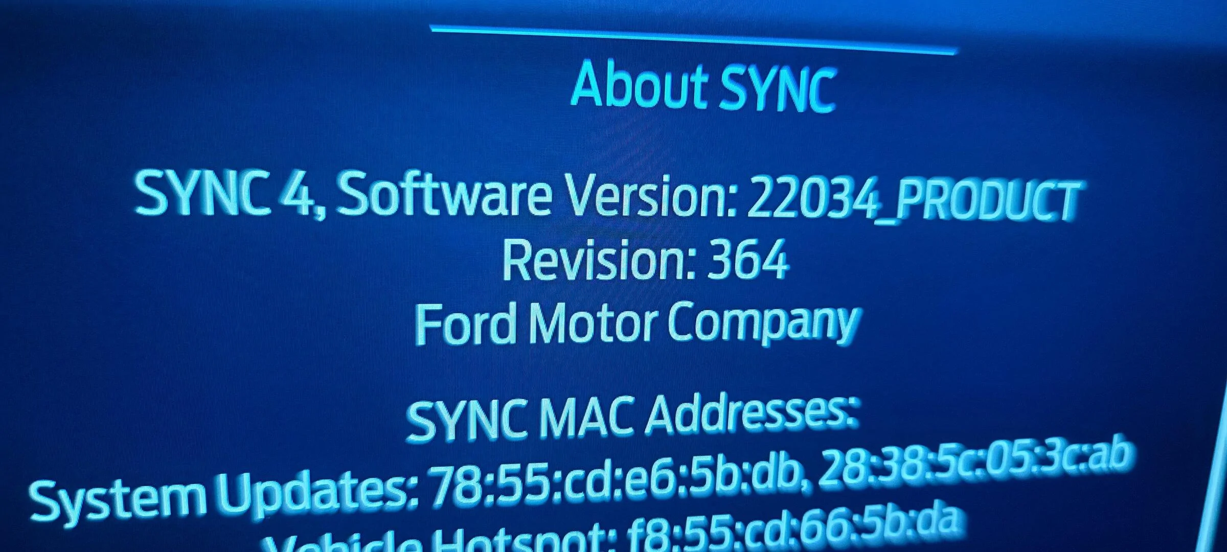

Are you at? :

Are you at? :
22028 was the latest offered to me as of this afternoon.
