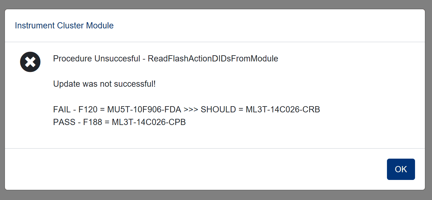

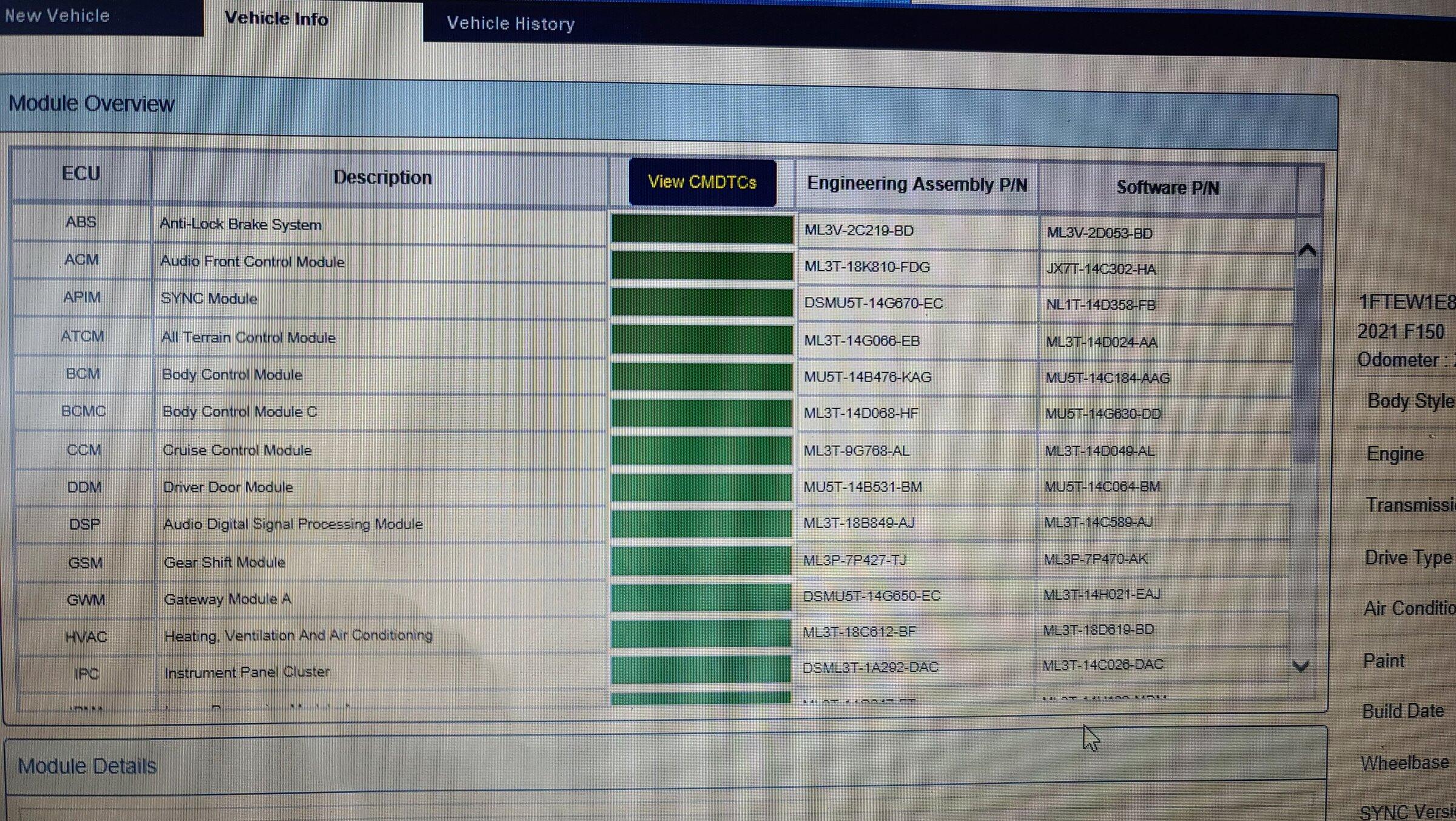

Say I made changes in the BCM, IPC, and APIM with Forscan and want to revert back to stock but didn't save the stock files. Is there a way to revert back to stock? I'm still having issues where the GWM won't update even though I'm getting the USB update successful message. I'm thinking maybe the Forscan changes may be interfering but not 100% sure. Here's my software part #'s if this helps.
Ford F-150 Lightning ECU module programming guide using FDRS 20220325_190345
Ford F-150 Lightning ECU module programming guide using FDRS 20220325_190400

@20ecoboost21
You GWM looks very similar to where my IPC got stuck. A MU5T number in one column and a ML3T in the other column. In theory a PMI should be able to correct this by wiping the whole thing away and restoring a last know good configuration, but unfortunately that doesn't appear to be the way and PMI really works in FDRS. I'm not sure what the solution is, but based on my experience that is what you need to be troubleshooting.
If you didn't take backups of your as-built before you started ForScan changes this it will be very hard to put things back like they were. The how-to guide in the forum walks you through making the backups, and I keep mine stored in about 4 spots in case I ever need them.

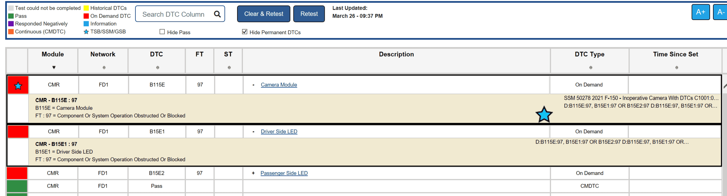

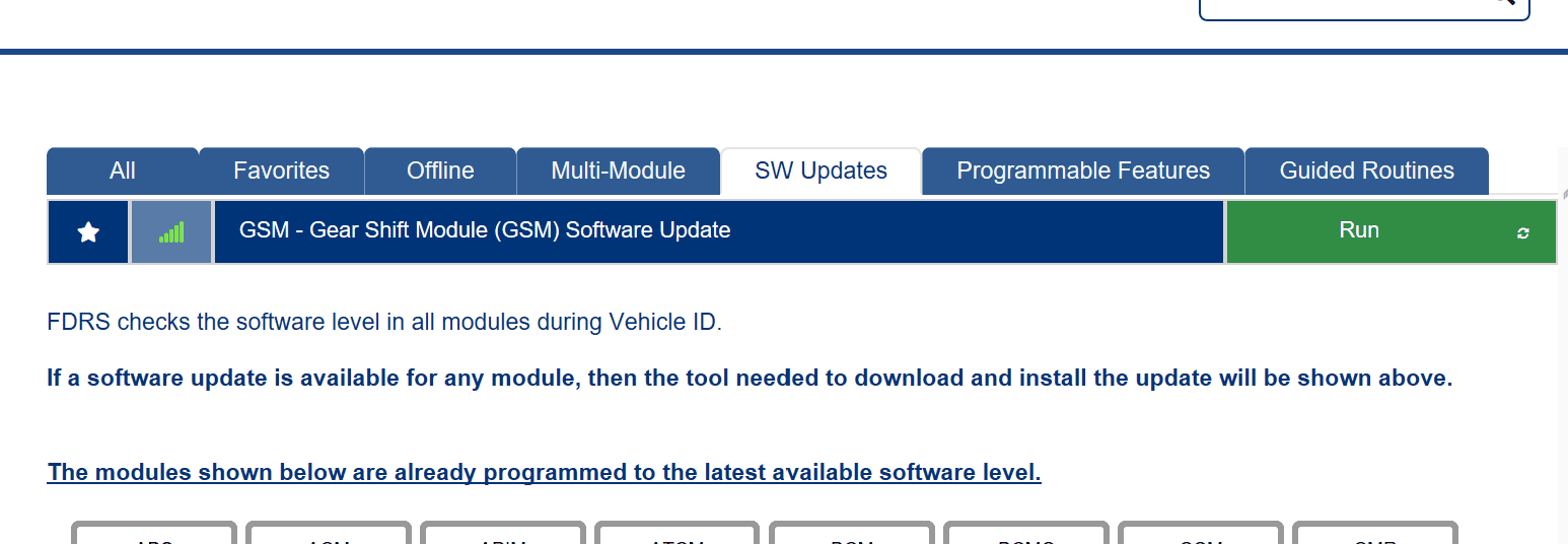

Ok ... When I started I had tons of updates. Sorry forgot to screenshot or count before diving in. After banging my head on my steering wheel for the better part of the last 24 hours, I have gotten them all updated ... minus one that completes but never seems to go away.
Ford F-150 Lightning ECU module programming guide using FDRS loneupdate
Now that I am done I am experiencing 2 issues (in FDRS ... not impacting anything that I can tell in the truck): ICM
Ford F-150 Lightning ECU module programming guide using FDRS icmfail
and CMR: again ... all cameras and lights working fine.
Ford F-150 Lightning ECU module programming guide using FDRS cmrfail

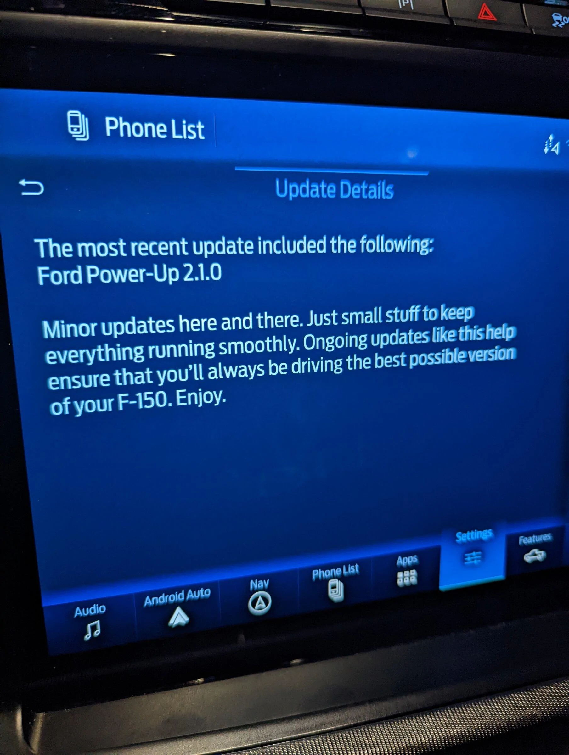

Also, even after all of that GWM and APIM updating ... I am still on SYNC 2.1 (BIG SADFACE).
Any idea how I can clear these issues and maybe shake loose any other sync updates? Note that my truck was literally one of the first off the lines as I bought it in 12/2020. full prep package.

For reference: here are my sync version screens:
Ford F-150 Lightning ECU module programming guide using FDRS PXL_20220327_014516412
Ford F-150 Lightning ECU module programming guide using FDRS PXL_20220327_014454809
