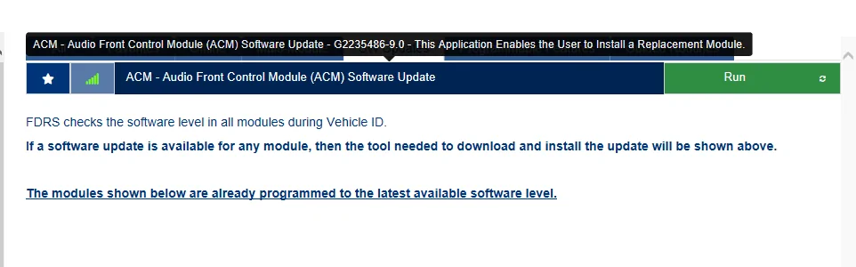

Ok so with a 302A, 8 inch cluster, with 360 cams, no BC
I'm at 21281 revision 244 and not seeing anymore updates.
I only have an ACM "update" showing that seems to be for adding a woofer (it asks if adding one) that just fails:
Ford F-150 Lightning ECU module programming guide using FDRS 1648324334840
Not sure if it's normal to be stuck here at 244 now or not. But no cams at speed or on the side yet so hopefully not as those were what I was hoping to get ?ā€ā™‚
I am thinking you guys have a similar issue to the 12ā€ cluster guys a file mismatch in the cluster update prevents the updates
