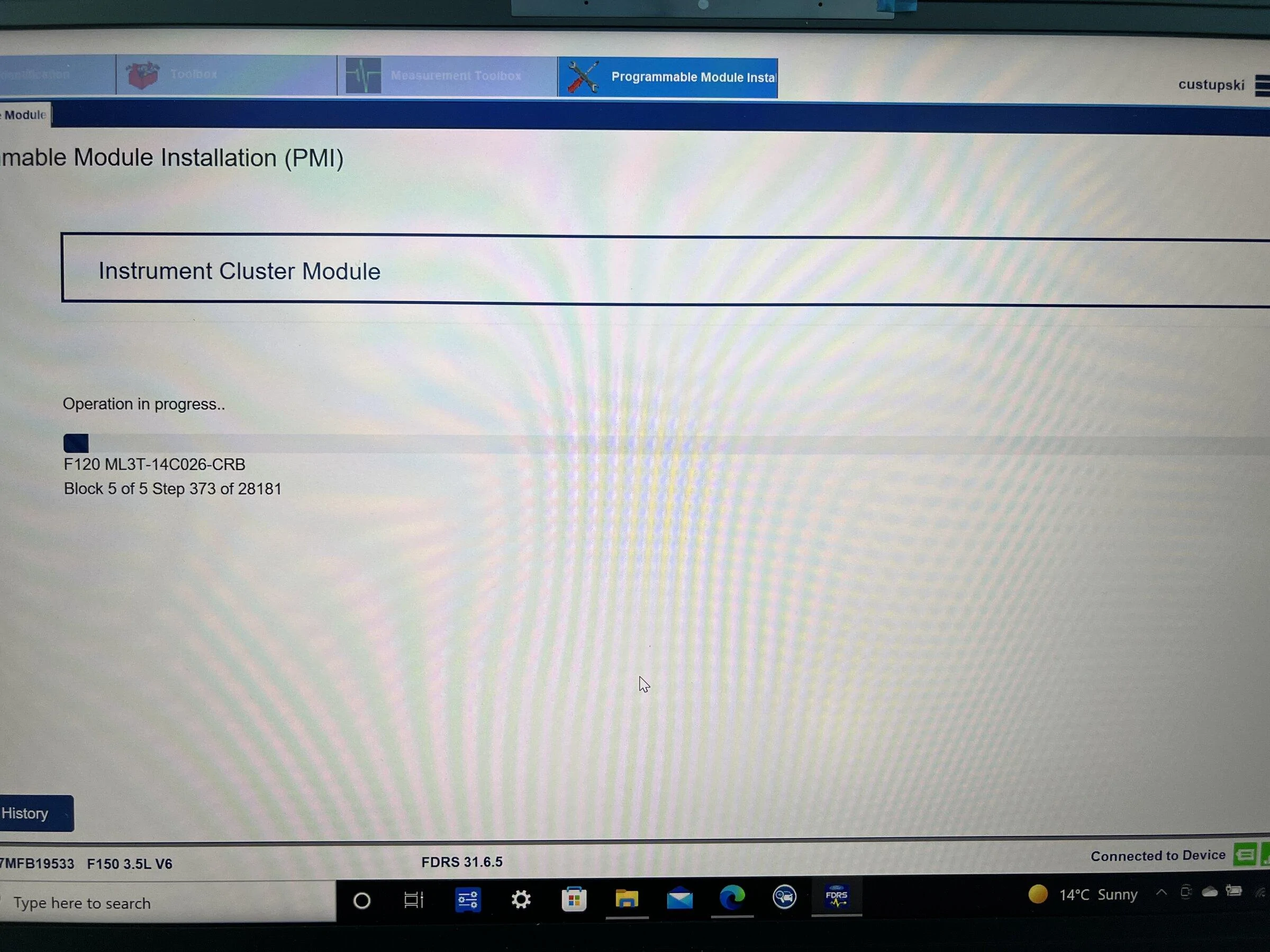

Jesse-Infotainment
Jesse
May 27, 2021
1,084
1,432
Dallas
2024 F150 Lightning Platinum
Jesse. I can’t remember, but aren’t there some protections in FDRS that prevent cancellation after a certain point? I recall seeing the “cancel” button grayed out once FDRS got to a certain point in the update process.
But what you absolutely don’t want to do is log out, pull the plug or do something else like that to stop the process. If the cancel button is grayed out, you probably better just let it keep going or you’re likely to brick the module.
Well This is just an example but one person is here
I would suggest it is not a good idea to stop here during the IPC .
It does grey out I think but if it doesn’t .. this would probably be the worst time to do it
