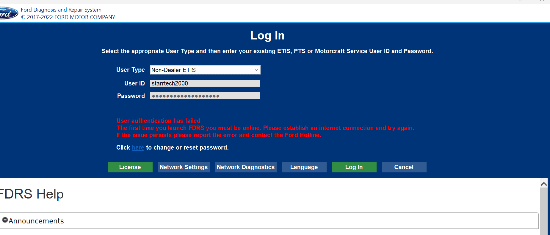

I don't have an option to login with my Motorcraft acccount...
The options are Non-Dealer ETIS, Dealer Employee, and Independent Operator/Non-Dealer.
I'm also getting a Cannot Reach FDRS Servers error... I'm definitely connected to the internet...
Help please and thank you. I already paid for the 2 day license and activated FDRS with it but can't log in...

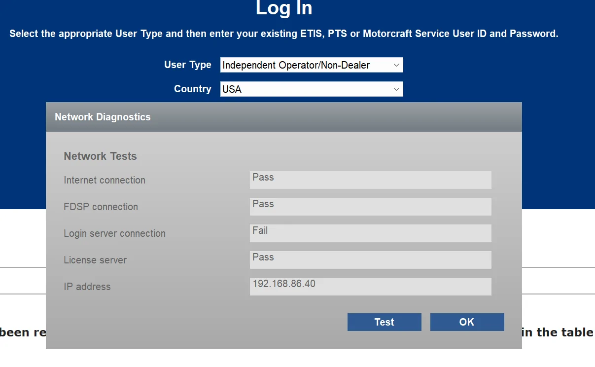

Looks like the Login Server is down on the day I chose to buy a license and do my updates... COOL!

ps. got FDRS to work by downgrading versions... Something wrong with the newest build and login server...

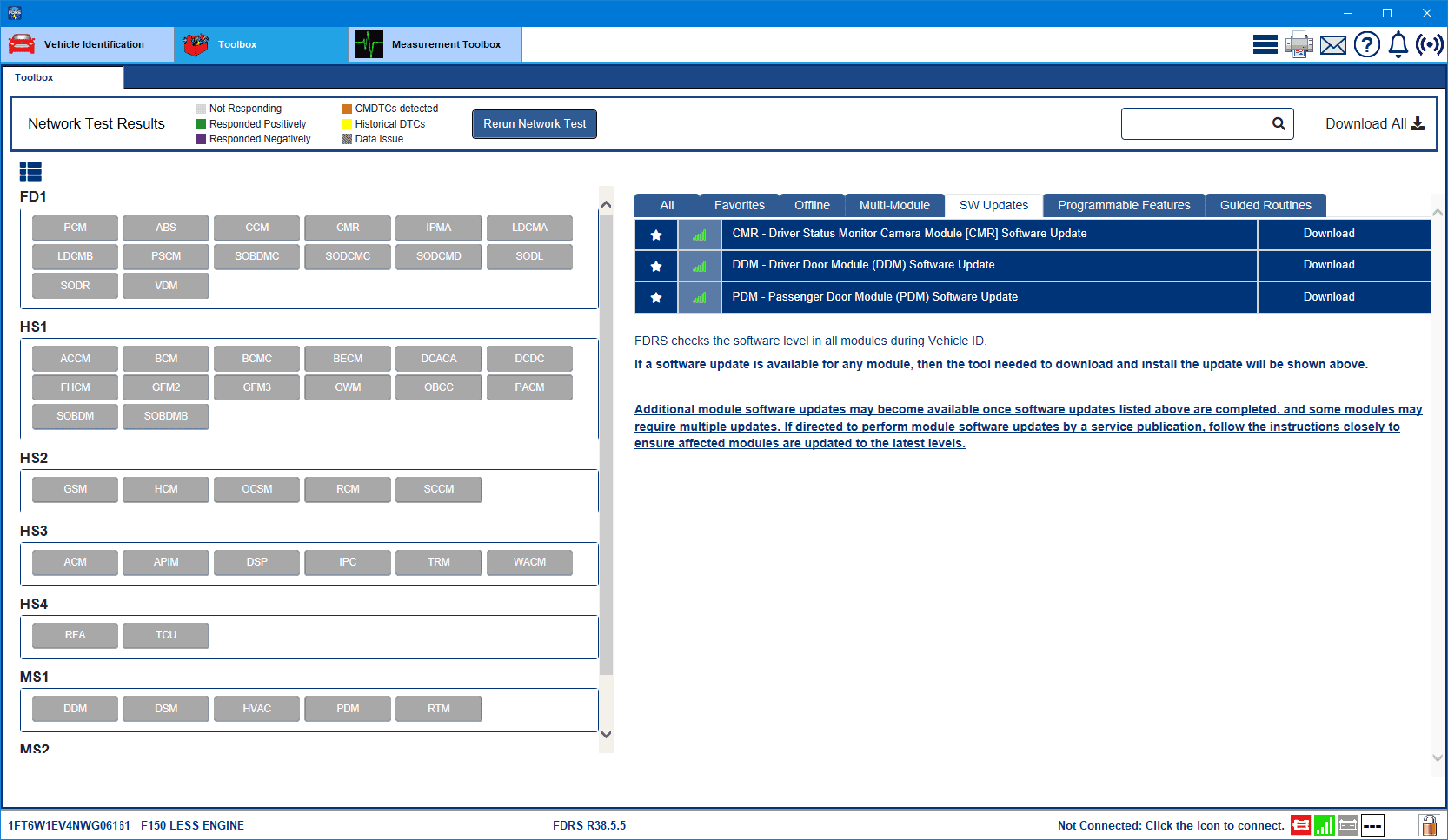

So..was running some VINs this evening and checked my truck to find three new updates.
Ford F-150 Lightning ECU module programming guide using FDRS Lightning_CMR_doors_11-Nov-23
I had already run across the two door updates from a '23 model VIN I ran for someone..and the CMR update showed up this morning on my '23 model Mach-E as well. Not sure what any of these are intended to correct or enhance yet.

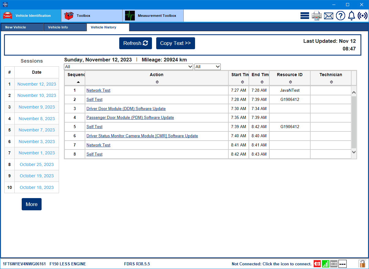

All done.
The doors took 4 minutes each and the CMR an hour.
