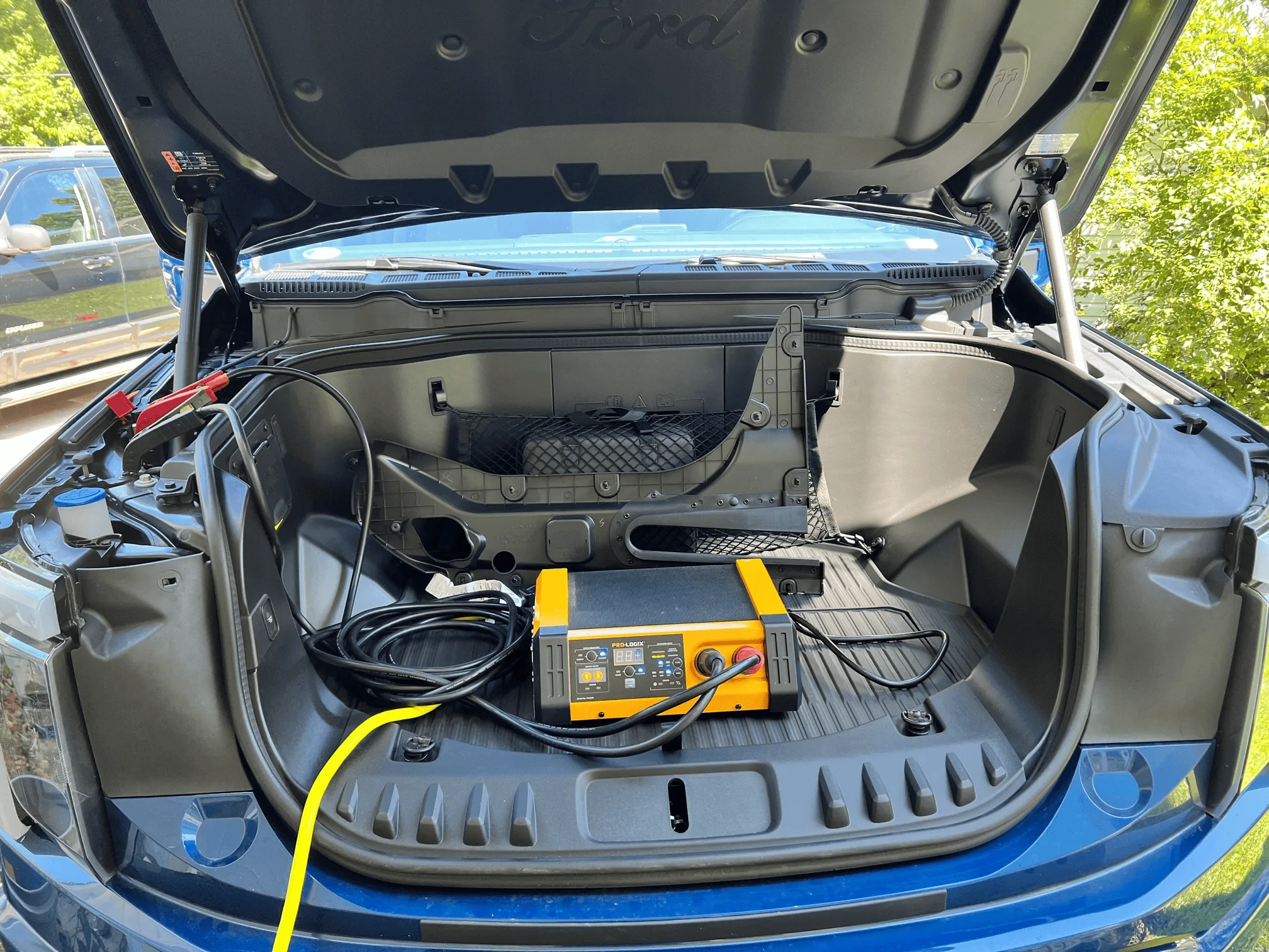

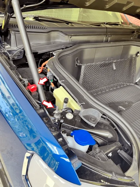

How can I connect the battery charger?
I saw the op said don't connect to the negative directly to the battery negative.
But I can't find where to connect the negative as the charger positive and negative cable can't be too far each other...
Does the jump post can be used for charging the 12v?
Mike G
Jan 6, 2022
1,921
2,842
N. AL, USA
Yes.
That right panel comes off using the plastic turnlocks.
Ford F-150 Lightning ECU module programming guide using FDRS Frunk_PL6100
Ford F-150 Lightning ECU module programming guide using FDRS Lightning_Jump_Connections

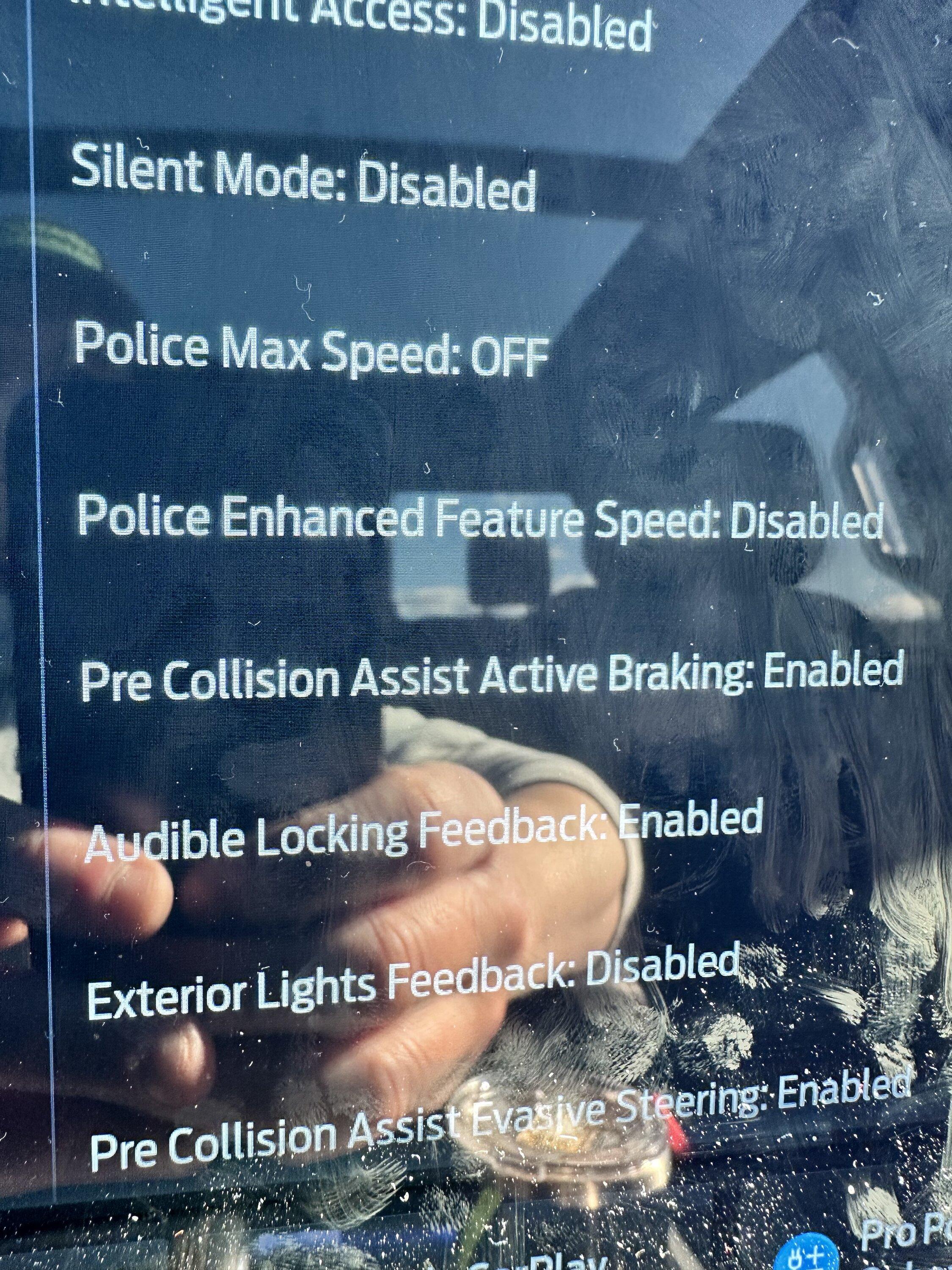

Can the police enhanced speed mode be enabled ?
Where are you seeing this? Obviously the 15.5" screen but what menus did you get into?
Reactions: GDN
3,799
4,913
Looks like someone has turned some of the Police vehicle settings on with Forscan.
ChrisCon
Jan 7, 2022
517
962
The Hamptons, NY
Bezel Diagnostics. turn the radio to AM or FM press and hold volume down and arrow seek left at the same time and this iis in the APM management screen I think.. I'll find it when I get back home.
@GDN I don't have Forscan or FDRS which is why I'm asking here. I just found this and some other interesting stuff in the bezel diagnostics and figured I'd ask.
3,799
4,913
Gotcha - so that makes sense if you are in diagnostics somewhere. All Ford trucks - ICE and the Lightning's have Police modes. I'm not sure what it takes to activate (I think Forscan will do it), but you are seeing some of the diagnostics that would go along with that. In Police mode you can get an all lights out mode, etc.
