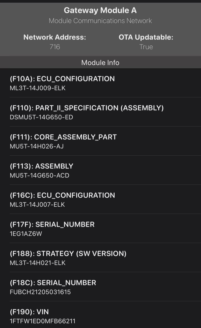

Just discovered that my GWM is corrupt, doesnt have the correct VIN. Been using the nano.

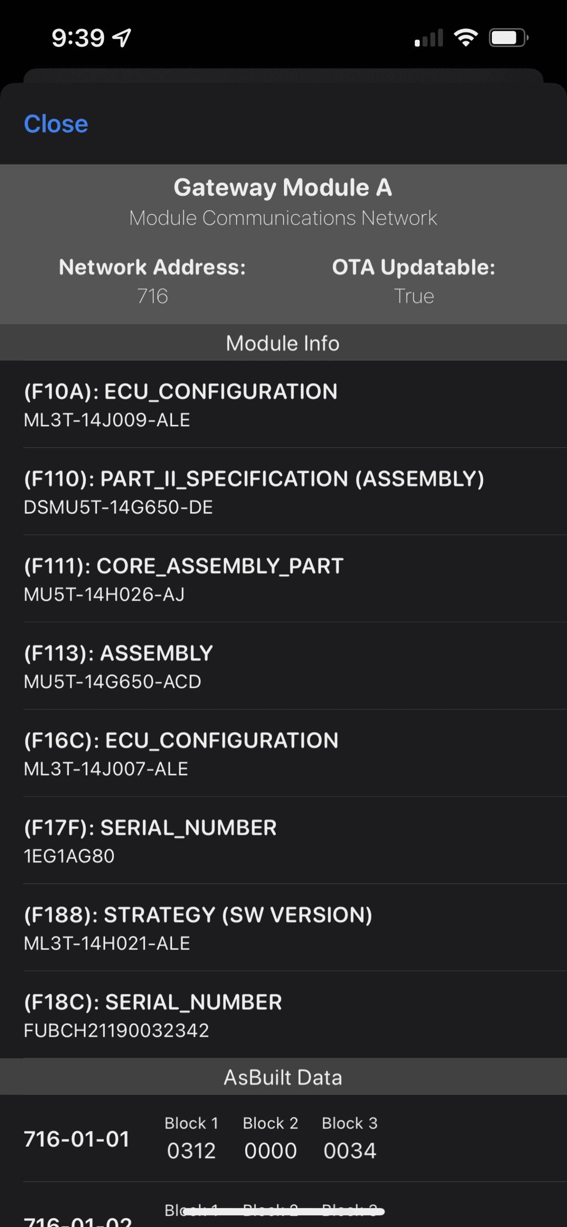

Maybe I’m running a different version of the FordPass widget but my GWM does not look like that.

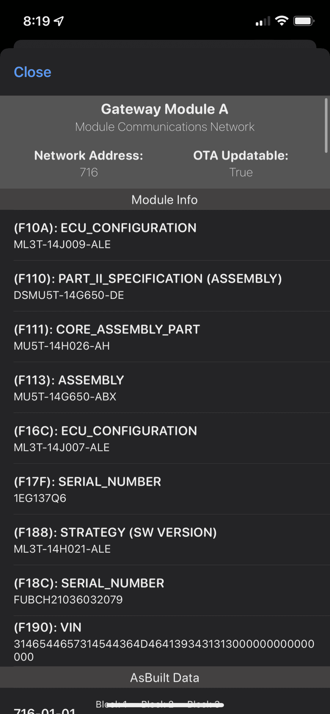

Mines different too. But mine doesn’t even show the VIN. Still on 20312 rev 245.

This could just be the difference in the GWM software level. Mine is up to date as of yesterday, yours seems to be a bit behind.

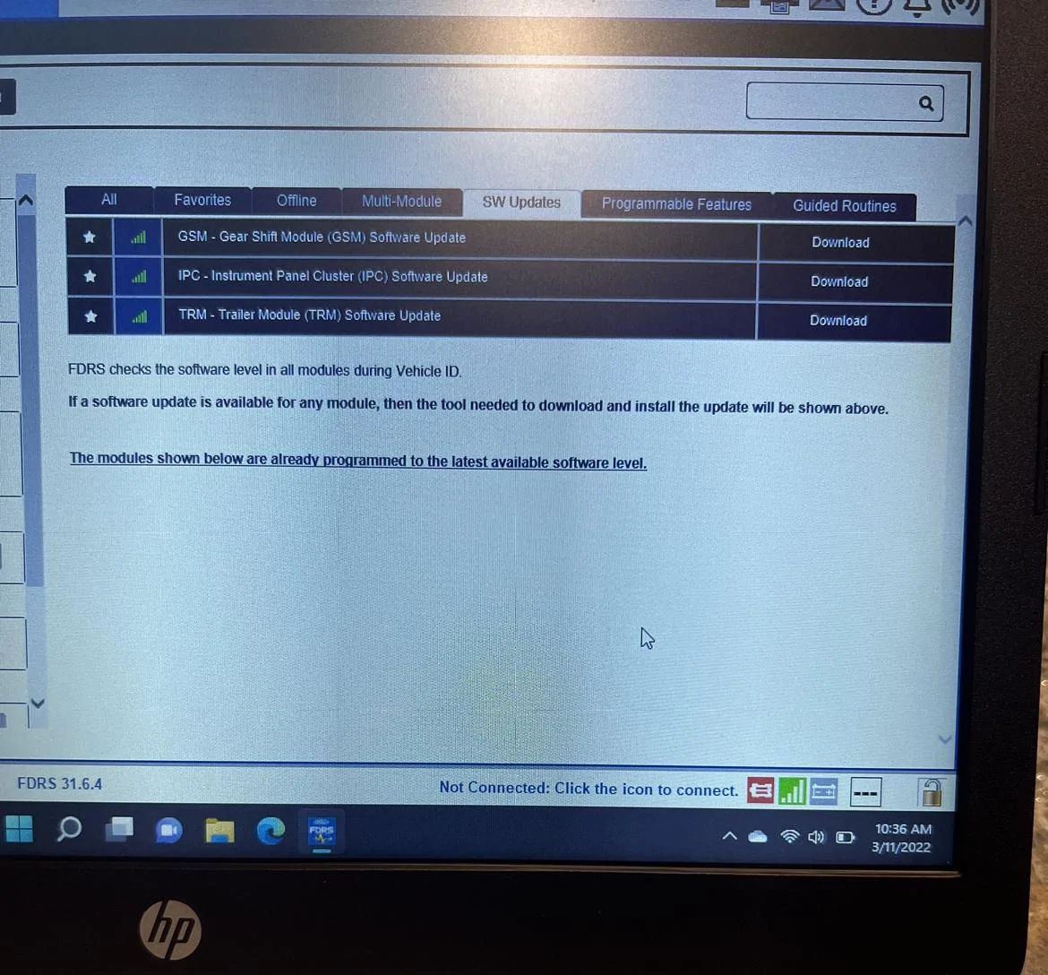

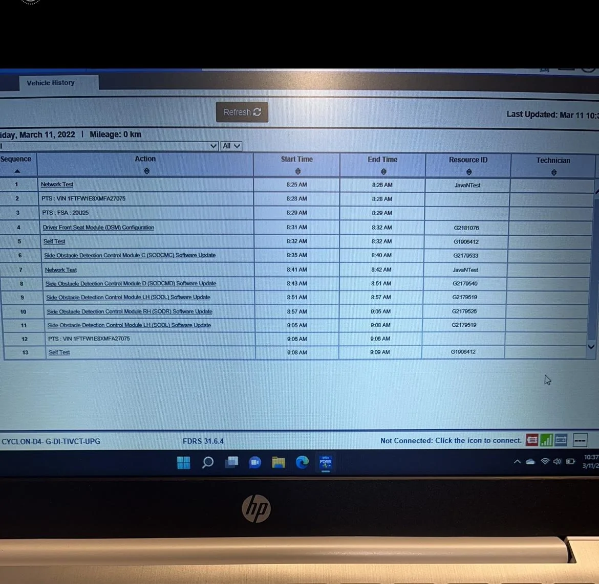

Looks like I'm getting my truck back today from Ford after my updating went wrong. I checked the FDRS and looked at what they completed. I'm guessing they didn't want to take the time to update the rest of the modules.

The GSM doesn't update, leave it alone. Do the TRM first and then look back a few posts and follow @Jesse-Infotainment 's post about how to do the IPC...
The dealer might also have left the TRM and the IPC alone because they can’t get warranty reimbursement for updating software that isn’t tied directly to a customer complaint. The IPC in particular would have cost them a lot of money to reflash if there was nothing wrong with it (other than being out of date) because it’s time-consuming.
