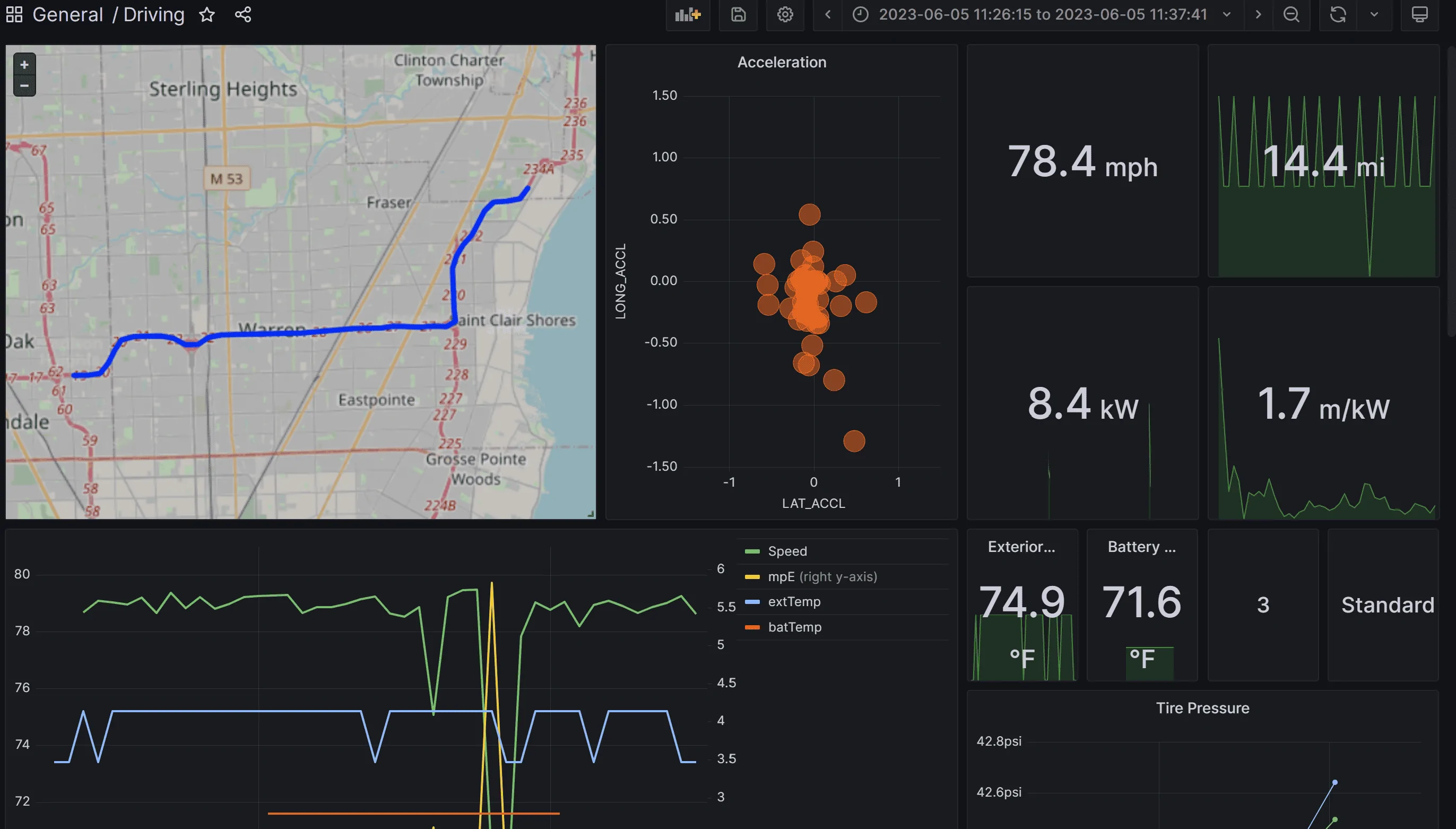

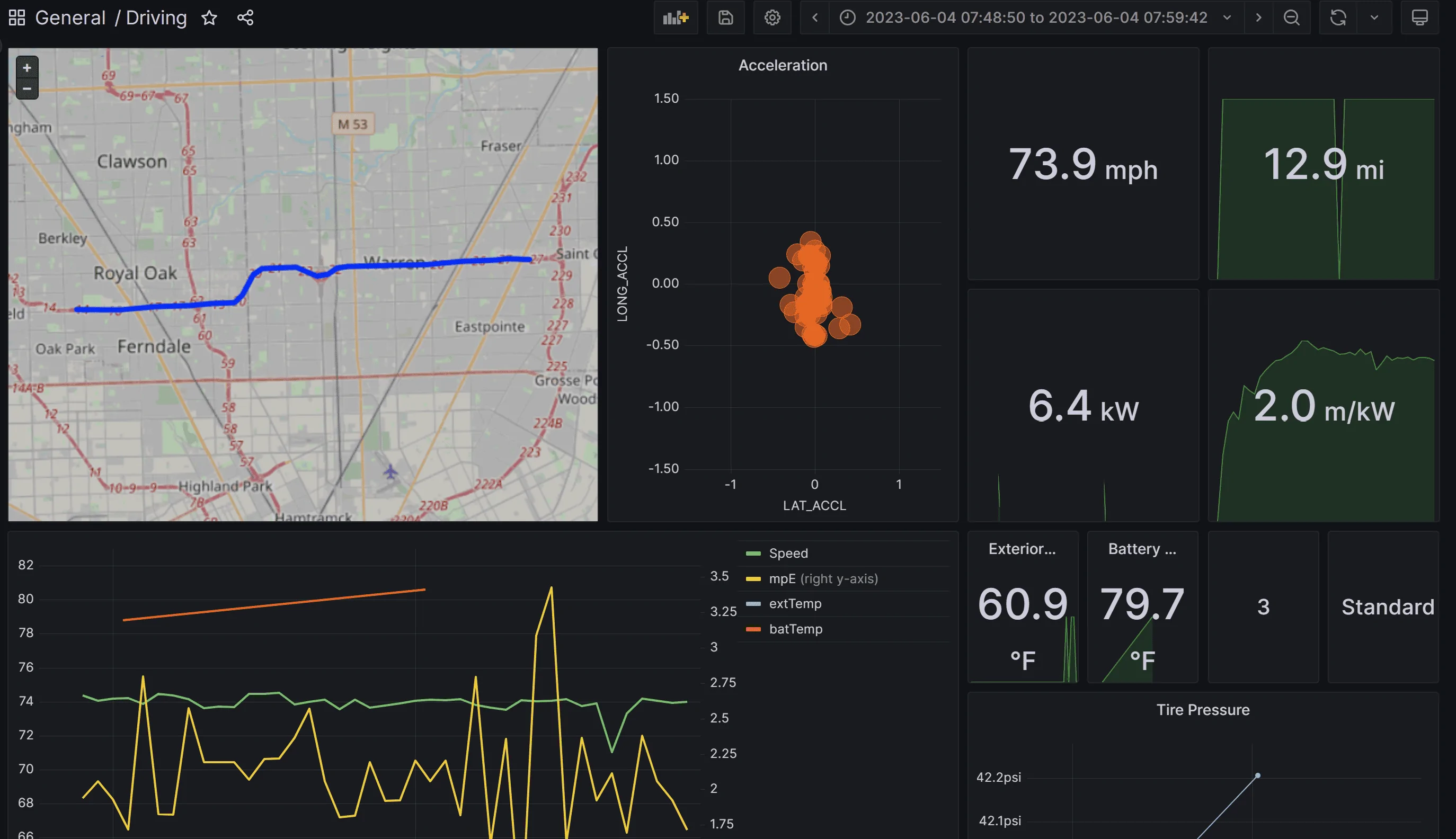

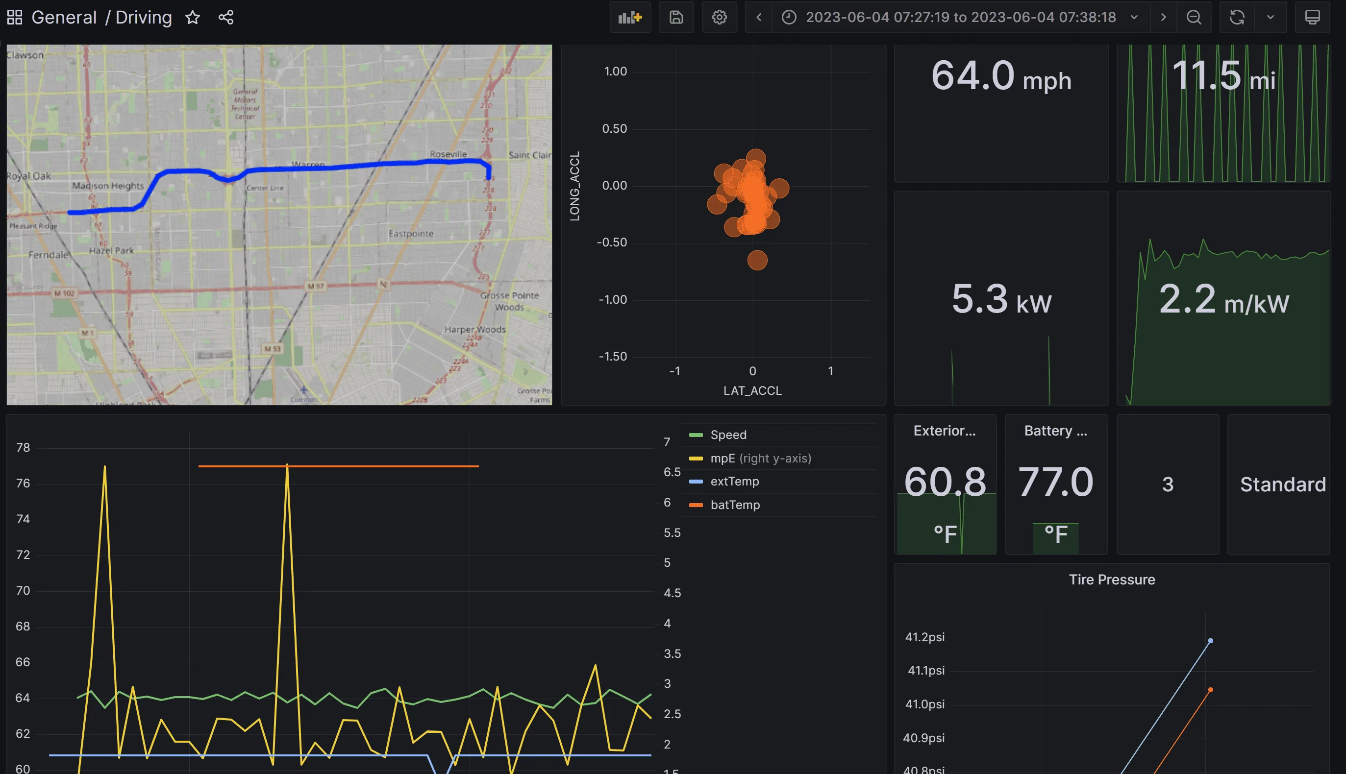

Here's a quick test I did this morning as I had some tinkering to do anyway...
65mph = 2.2 m/kW
75mph = 2.0 m/kW
80mph = 1.7 m/kW
It's not scientific by any means as each run is in opposing directions and as such not accounting for elevation changes , wind direction, etc. but that stretch is relatively flat and there was hardly any wind this morning so...
This run was with the Ford 22" (non aero) wheels, but ironically, another trip that I logged on the same section (different day so obviously different circumstances, but it wasn't raining) with the stock Lariat wheels, registered 1.9 m/kW @ 75mph so I'm kind of surprised / pleased the change didn't make it much worse.
[EDIT] Added a 80mph comparison as well.

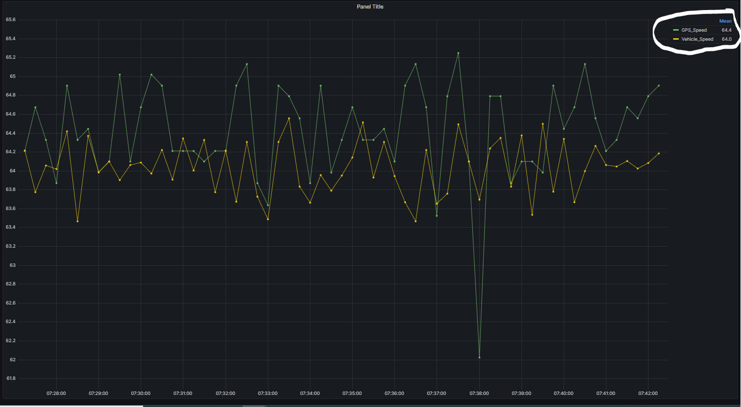

The only way you know that, as you know, is to test it scientifically. People have registered a 10% loss with non-aero wheels.

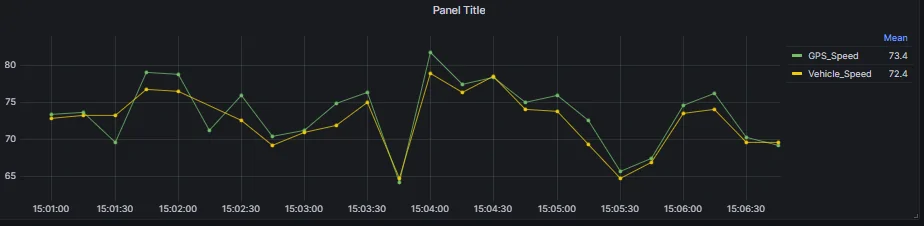

Question - how did you measure speed? If you changed the circumference of the tire, but the setting in the vehicle still has the old tires, then your speed is off.
Most people with non aero wheels are using "off road" tires with aggressive thread patterns so I don't think one can make a general statement that non-aero means a 10% loss, now, I'm not saying that it won't be a loss, it definitely will be, simply from non-aero and the fact that the 22's are 17lbs heavier (92 vs. 75 as measured on a scale) than the stock rims/wheels.
How much is hard to quantify and depends on a lot of factors, I was just happy / surprised it stayed roughly on par in my highly non scientific comparison and wasn't the "automatic" 10% loss.
I have other measurements just the day before I swapped tires that shows 2.1-2.2 m/kW @ 74mph on the OEM wheels, but those runs where too short and on a different stretch of road to be a "direct comparison".
The speed in the graph is vehicle speed as registered on the gauge cluster / by the vehicle, but compared to GPS speed (see below) it's only off by 0.5% with actual speed being higher.
OEM Wheels have roughly 1% difference (again, actual speed is higher)
22's
