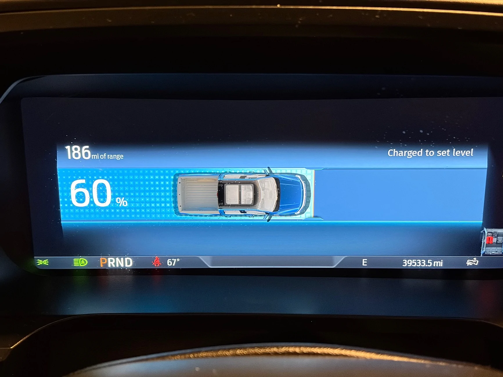

Did this today. Took just short of 6 hrs with a vLinker FS. No errors after update, which I was expecting a bunch. Loaded the AB and mod changes (glare free) everything works as it should. I like the animations and new icon locations better, but still room for improvement for my OCD in icon locations.

I just finished this today as well (little less than 5.5 hours). Only problem I experienced was the downloaded "files", shared here when they were originally posted...then was out of town for a few weeks.
The 2024_IPC.ab file I had saved was originally 300k'ish in size and was giving FORScan errors when trying to load all (after the IPC upgrade). Went back today to re-download, and it was around 120k in size and worked perfect.
@flyin525, did your symbols for the glare-free, widen/spreadout since this IPC upgrade? I thought maybe mine wasnt working but I noticed the left symbol (which used to be right next to the "green A") is now in the far left corner. Unfortunately, I didnt yet drive fast enough to see them in action.
EDIT: also did the PPO on, while truck-off change in APIM
Looks pretty similar in size for both headlight related icons though there is a space between them now where there wasn’t one before

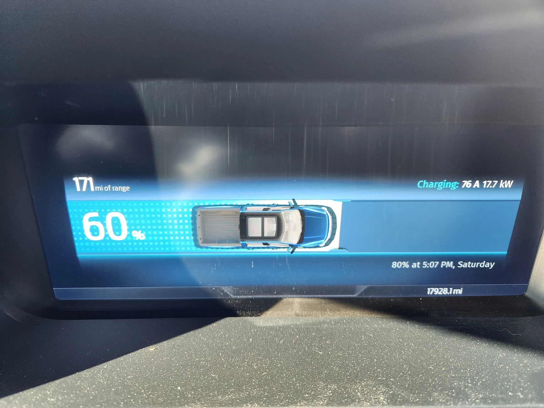

Yep, same on yours then.
This was the look from the 2023 IPC
