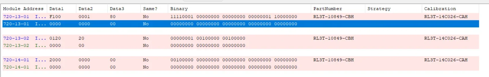

2101 is due to the lower portion seatbelt config. You can load a complete 24 IPC as build file and write it.. it will clear the 2101..

I believe there are some subtle differences depending on your config. I got a trailer module dtc with either that one or another one so searched the dealers for an extended range with trailer brake and there weren't quite as many differences. I ended up just restoring my 23 backup over the 24 to keep from making a billion changes but you want to note of the values for 720-13-01/02 and 720-14-01 from the 24 and keep those the same or you will get an IPC code. Top row was the 24ab and the bottom was what my 23 had. Seems these are related to the seat belt nannies. Apparently you can change them after the fact though as mine are currently showing all 0's after following the manual procedure to disable the chimes. Either that or it didn't update those to the mother ship.

I have max tow as well. Nothing related to that in the IPC portion that I saw. I used that 115kb file yesterday.
When you go to upload/upgrade the IPC module, follow the boxes exactly as you see in the "Custom File Selection.png" picture.
After 4-6 hours (service procedure done), load all the 2024_ipc.ab file, do not write all just yet.
Edit your glare free and seat belt chime changes back to what you had before the upgrade (if you had these).
Then write all.
Check for any DTCs.
As @PJnc284 says, you can restore the 2023 too, I only had 4 settings to change so just edited before the write all.
